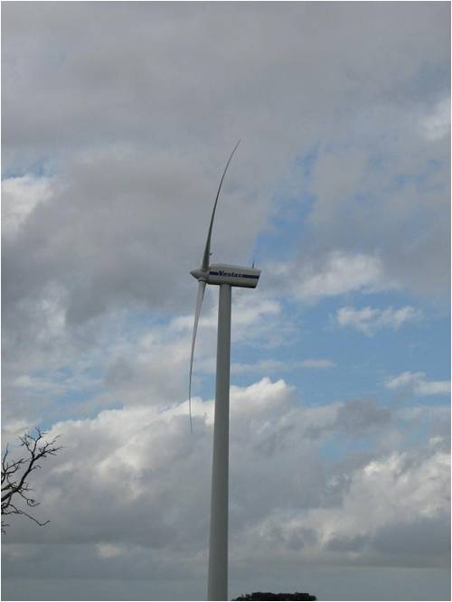

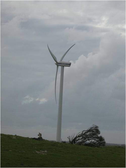

Here is a photo of a commercial mill in high winds and have a look at the bend in the blades, if they were made rigid the blades would break in this sort of wind loadings.
Pete.

Flexing and survive ability is all down to good load transitions and materials that dont mind it.
ie mild steel.
stainless, aluminium and titanium are all materials that crack and break when subjected to repeated flexing.
mild steel flexed upto a point prior to permanent deformation will continue this behavior for a long time in comparison, it will work harden but not nearly to the extent that stainless and aly do.
dont get me wrong but the blades in the pics above DO like anything subjected to these kind of loads have a finite life.
Being experienced with working on high speed aluminium tubing (aeroplanes) all of my life I was once dumbfounded to find that a Shrike Turbocommander
(about 10 seats and two 800+ Hp engines) has a cycle life of just 10,000. Each flight involves pressurising and de-pressurising the airframe, this causes it to grow.
It was not until I worked on one that had 9999 cycles and the pressurisation system had been disabled so it could continue in service did I really understand why...
It was riddled with cracks, all the rivet holes, lap joints highly loaded areas were stuffed.

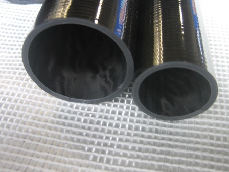

found some carbon fiber mast (broken unfortunately into 3m lenghts) in hard rubbish, informed me these are available.
check these puppies out
http://www.carbonfibretube.co.nz/index.php?pr=Carbon_Tube_Pr ices
i'd go for this
ID OD price/m weight/m
22 25.6 $ 49.42 0.21
part no RCT 1822 or RCT1522 at $44/m
now they are expensive BUT at 210g per metre this just knocked out a chunk of blade weight.

Karl, you *really* don't want carbon fiber material in contact with aluminium. Its a bad combination, just look up the galvanic corrosion tables.
You *definitely* don't want to drill holes through the aluminium blade and into the carbon fiber tube to insert pop rivets .
Now, if the blades were carbon fiber you'd get away with stainless hardware....

Pete, as I mentioned above, CF & aluminium is a bad combination.
Also, when placing a fiberglass or CF skin over plastic or alu blades you have to consider their different thermal expansion rates. If there is a mismatch they will delaminate in time.

You seem very confident in this solution. What is that based on? If you calculate out just the centrifugal forces you will see that we are already at 1/3 of the tensile strength for the CF tubes. Add in bending and gyro forces and you will be right up to yield stresses and above before too long.
It's true that the CF tubes are strong for their weight but their tensile strength is only 65 ksi. Barely stronger than the proposed aluminum. Yes they are lighter which helps but the mass of the blade itself becomes domineering. CF matrix has the problem that it is relatively brittle as well. So when you have thermal expansion or cyclic bending of the components you will see cracks. Also, carbon fiber has well established design constraints that need to be observed. You can't drill it, lathe it, etc. and expect it to perform as desired. CF works best as a monolithic structure with a full resin preg.
Perry

Corrosion issue with parts next to aluminium is solved with bonding it in and painting the parts first.
Similarly all Aircraft parts are riveted together with Jo bolts which although are titanium, stainless would suffice -hence wet install your fasteners to keep galvanic corrosion to a minimum. (would be no worse than steel)
Also sealing the ends of the composite is beneficial as the carbon will soak up moisture (tiny but enough)
this is done with epoxy.
Sorry Perry I disagree -as we've seen in the figures bending and gyro forces are small in comparison with the gyroscopic forces and at only 1/3 of the tensile strength being used up at 1000rpm, they are at least 50% under its maximum loading.
I have never seen cracks in composite materials and I've been working with them (Boeing & F/A 18 hornets) for 8 years. Delaminations yes but most of this is due to physical damage.
You can drill, lathe and machine it if you wish but its hard on cutting tools.
Fasteners could be omitted entirely for a better solution but careful selection of adhesive would then be paramount. Which is why A/C manufacturers use fasteners also.
Keep in mind the current thinking here is for stainless tube which is no better re corrosion in the aluminium than the CF.

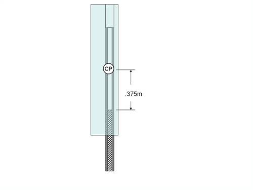

Hello, Second installment on calculations of Phill's proposed design. Last installment we analyzed the centrifugal loads. This time we will calculate the thrust forces and bending moments on the blade.
Question - What thrust forces are Phill's blades seeing and what stresses does this create in the SS (or carbon fiber, or steel, or moon rock) tubes.
Model -As before the model is defined as Phill has proposed. It is assumed that the thrust force is applied at the center point (center of pressure) of the aluminum blade section. We are also assuming that the blade extrusion does not participate as a structural member. All rigidity is provided by the tub/rod combination.
We will calculate the stress in the tube right where the solid rod ends. This is the point that will be subjected to the most bending stresses due to it's thin cross section.
1.) Figure out the thrust force
dsmith1427 correctly calculated the wind speed earlier in the thread. Assume TSR of 7.
RPM = (Velocity x TSR x 60)/(2 x pi x Radius)
This yields 28.4 m/s (63 mph) - pretty close to what Phill observed during his 1000 rpm runaway.
You can calculate the thrust force (Ft) from;
Ft = 2 x rho x V^2 x a(1-a)x Area
Assume the rotor is running at the Betz limit. a=1/3 for this condition. I know that this is not true but it is the best approximation for these calc's.
Reducing gives us;
Ft = 1/9 x pi x rho x V^2 x Dia^2
for Phill's numbers
Ft = (1/9)(3.14)(1.223 kg/m^3)(28.4 m/s)^2 * (3.2 m)^2 = 3524 Newtons
Divide this by 3 because we have 3 blades to distribute this thrust force and we see that each blade see's 1175 Newtons or 265 pounds force. Now we can see why that big Vestas turbines' blades were bending. This figure is a bit high but remember that our rotor is operating at the Betz limit, removing %59 percent of the energy in the wind.
2.) Calculate the bending moment in the blade
Moment = force x distance (distance is the center of pressure to the point we want to measure)
M = (1175N) x (.375m) = 441 N-m
Convert it to stress in the tube right where the solid rod ends
bending stress = (moment)(tube radius)/moment of inertia
Without beleaguering the moment of inertia calc's (not typing in but easy to do) you will see the the MoI (I) is equal to 6.69x10^-9
bending stress = (441 N-m)(.0125 m)/(6.69x10^-9 m^4)
bending stress = 823 mpa or about 120 ksi.
Ouch. We see that the bending stresses right where the tube ends has already far exceeded the tensile stress of the material.
You could always test this if you are stubborn but think about it. Hang a 265 pound weight from a .375m length of this thin walled tube and it will bend.
So now we clearly see that the thrust forces contribute substantially to the forces that the tube will see.
Since my intent was to combine the models and forces due to bending and centrifugal forces I can finish it up pretty quickly.
3.) Combine forces from each model
From my previous post we recall that the stresses due to the centrifugal force on the tube right where the stub ends is 223 MPa. We can combine the stresses according to the following equation
stress = (223 Mpa)+/-(823 MPa)
The +/- is due to the front of the tube being in tension and the back in compression
So we now know that the tube just outboard of the stub will see 1046 MPa (152ksi)of tension on the upwind side and 600 Mpa (87 ksi)of compression on the downwind side.
Summary
1.) Given the design as proposed by Phill we see that by calculating the centrifugal and bending moment forces that the weak point of the design (at the point where the hollow tube begins) will seee tensile stresses of 1046 MPa
2.) This is far beyond the capability of all materials proposed so far, stainless steel or carbon fiber.
3.) I would predict that this configuration would fail given the 1000 rpm criteria given.
Hope this helps and no, I am not sh*tting all over your ideas Phill. Just helping out with the math as you have asked.
Perry
P.S. please check all this over!
