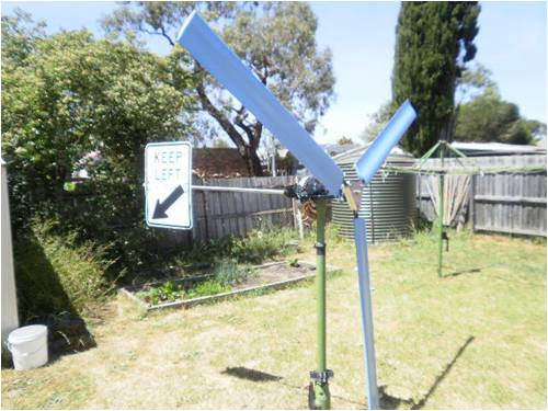

I couldn't help myself, this seems to be the std tail arrangement, it got cleaned up last night so I straightened it and put it to use.
now I need a keep right for the other side
balance is now with 1g of each other and the CofG on each blade in exactly the same place, thus should be balanced.

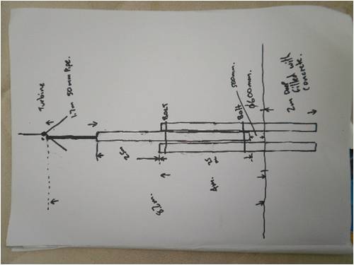

Next up the tower....
I have abandoned the idea of using an old windmill tower at roughly 7m high on the grounds that steel is cheaper than life and working on the top of one of these would be quite dangerous.
New solution as follows.
Steel as follows 100mm SHS 4mm thick wall x3 lengths 6m long.
Solution bury two of them in the ground 100mm apart 2m deep in a 600mm diameterx2000mm deep hole full of concrete.
place the third in between with 3.5m below the top of the other 2 poles this leaves 2.5m above the two fixed towers, weld in 50mm pipe to the top section a further 1.7m attach turbine.
this gives a total height of 8.2m hinged at a little less than 4m from the top, enabling tilting over in a pendulum type manner.
use a large bolt to attach the tilting part top and bottom.
this should be plently big enough what are your opinions?
no guy wires would be used.
Posted: 04:36am 22 Nov 2009
Phew! Hope you have a good long handle shovel?
2m deep is a long way down, it might not sound much till you look down the hole or have to drill it.
At 600 dia x 2m is almost 0.6 m3 of concrete per hole. That’s a lot. ( around $100.00 per hole)
I would think 1 m x 2 holes would be plenty. (unless you are in a swamp)
Power poles are not even 2m deep and without concrete.
The other thing I would suggest would be weld a plate to the top of the steel coming out of the concrete and bolt the above ground structure to it.
Should you need to remove the tower or do a redesign in the future you can without a mass structure sticking out of concrete for ever more.
If you weld up the basic mount for above ground and bolt it to the in ground pieces prior to setting concrete than all can be levelled and setup before concrete is poured. Once set unbolt the frame and finish construction of the tower and then secure to base footings again afterwards.
I have seen many footings mounted on large threaded bolts where a nut is placed under and ontop of the plate so the structure can be adjusted for level by adjusting the nuts up and down.
Have a look at some of the highway street light mountings as often they use a simular system.
Should you do 2m holes and strike oil than retire.
Pete.

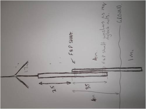

Here's the sketch
digging the hole is a piece of cake, dad is building a shed too and a guy comes out with a bobcat and auger, will take about 10mins. As you suggest upgrade later will not mean new foundations. the 0.6m3 of concrete which I work out to be 2400Kg/m3 = roughly 1400KG. There would only be one hole as combined width is only 300mm.
If you reckon 300mm and 1m deep is enough then I have a post hole digger on the tractor that will do this no worries.
similarly if 1 pole either side is overkill then could use a single pole and use f&p shaft for the pivot.
this simplifies the installation / cost significantly.

Posted: 08:49am 22 Nov 2009
Karl,
If you are in good digging and can go deeper than it might be worth while. I misunderstood and thought the footings were further apart.
I think a metre would do but if you can get a bit more it wont hurt.
A few things I think a smart bloke like your self would know but will point them out all the same.
Ensure the concrete is covering the bottom of the steel as this where the rust sets in and causes early failure if the steel protrudes outside the concrete.
As the bottom end is now sealed in concrete you will need to cap the tops off to keep water out and would pay to weld in a tube sleave for the axle to go through or water will find its way in there to. (Maybe drill a small hole at ground level after to allow moisture to escape should it get in)
I would think use option #1 with 2 uprights and you wont be sorry you did as a short cut here will be something you are stuck with later.
You might get away with 1 box section into the ground and then 2 sections either side with a metre over lap. The little saving might not be worth it as the greatest force will be at ground level.
Weld the two uprights together with a spacer between them before setting into concrete as it will be a bugger of a job to align them otherwise.
A tip I used when setting rhs into concrete for large retaining walls ( big steel) is to use 2 lengths of timber to span the hole and bolt the timber together sandwiching the steel in between so the steel can then be lifted off the bottom with a couple of bricks under the timber to ensure the concrete covers the bottom of the steel.
I would look towards a hand boat/trailer winch to lower and raise the pivoting section, they are about $30.00 at supercheap autos and would think should give nice control and be $ well spent. Perhaps remove the winch when not needed.
If it was me I would consider 2 lengths of C section into the ground ( flat side inwards) and the box section for the tilting mask. This way there is nowhere to collect water and be as strong if not stronger and easier to work with.
Pete.

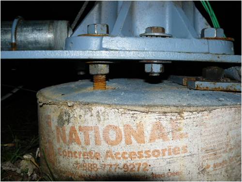

That's good news all clay in a winded area. You don't really have to build a cage you can buy bolts from a building supply house/contractors supply. 3/4 foundation bolts about 1 foot long they will come with a 90 degree bend on one end this will be the end that you muck in the concrete. Figure out your bolt pattern then use a piece of 1/2 or 3/4 plywood or any piece of wood that will match your bolt pattern. Drill holes in the plywood that match your bolt pattern then use the nuts and washers that come with the bolts to fasten them to the plywood this will hold the bolts in place while you just muck or place the hooked end in the wet concrete. You can then use a spirit (bubble) level to level the plywood this will plumb the bolts at the same time. I would have about 4 to 5 inches of bolt extending above the concrete.
I have used what we call a sona tube to extend the concrete pier above the existing grade elevation. The tubes come in different sizes. It's all very simple stuff.

is that 6mm plate under the tower?
