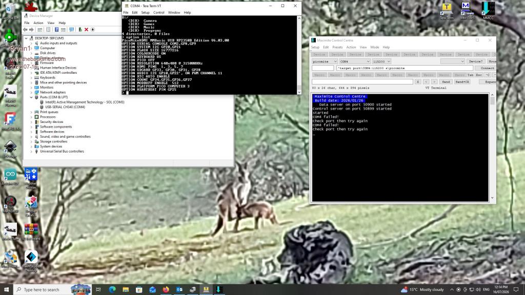

So finally got some time to have a play and got tera term connected but sadly can't get MCCC to connect.
I found I had to change the baud rate to get tera term to connect properly but trying the same in MCCC didn't work.
Posts: 3429
Posted: 03:07am 16 Jul 2026
MMCC won't connect while Tera Term is connected to the same com port.
Either disconnect Tera Term (Alt-I) or close it then try to connect in MMCC again.
