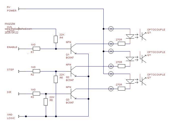

Bryan, pretty sure you can use the same limit input for both ends of an axis, but you need to specify all 3 axis even if not using them, IE:
STEPPER HWLIMITS GP20,GP21,GP22,GP20,GP21,GP22
Agree that the X and Y axis are not going to matter much regarding backlash, need to pass the ends of the job on the X and overlap the passes on the Y anyway, so should be all good. The Z-Axis on the machine here is a leadscrew driven by a wormgear, so can probably hook a motor almost directly to it. That's after I move a ton of other gear to gain access to it again
I posted on the other thread regarding the enable signal being the wrong polarity, however from memory most of the stepper driver boards it is really a DISABLE signal so the current setup will work with the following circuit:
Transistor and resistor values are what I have most of, pretty much anything NPN and similar values should work.
Regards, Lyle.

Lyle I have plenty of those BC337 transistors so as I have them onhand I will use them and for the opto's I will have to source them.

  Quote  ... the opto's I will have to source them.
The optos in Lyle's circuit are the ones in the DM556 driver, you don't need to add them.
See the circuit in the first post of the previous page.

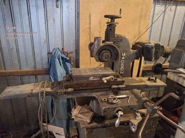

Now I had the idea of using a picture of the surface grinder as the background picture in the program file then put the box's close to the steppers for the data etc which would look pretty cool I reckon.
So been learning how to xmodem in teraterm after I had to edit the baud rate to get tera term to work
Now after transferring the jpg file it comes out in 16 colours not high res when I look at the jpg. The FM means just one click to view it too   so what setting would I need to put in so I can get a high resolution jpg that was transferred.
This is the picture I used

On RTFM I tried out 800x600 Mode 3 and xmodemed a 65K res pic now the picture was a tad better but still like 16 colours so more reading to do I think

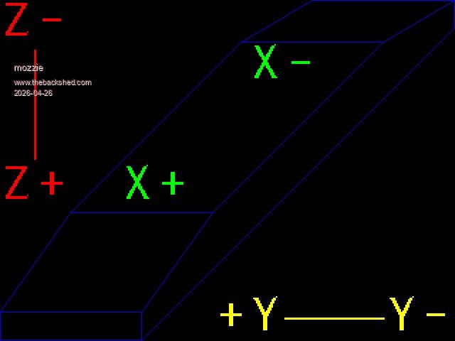

As you have probably realized, with the limitations of the PicoMite HDMI you can either have colour depth or resolution, but not really both. Its bloody good for what it is within those limitations. The surface grinder here will get an ILI9488 LCD so a much simpler screen will do:
This was drawn with the code below (currently tested 640x480 HDMI mode 3)
'Prog to draw Surface Grinder
MODE 3
Option default integer
Box 0,439,200,40,1,&hff ' lower end
Line 199,479,639,39,1,&hff ' lower diagonal
Line 639,39,639,0,1,&hff ' upper vertical
Line 639,0,439,0,1,&hff ' upper end
Line 639,0,539,59,1,&hff
Line 439,0,339,59,1,&hff
Line 539,59,339,59,1,&hff
Line 339,59,99,299,1,&hff
Line 539,59,299,299,1,&hff
Line 99,299,299,299,1,&hff
Line 99,299,0,439,1,&hff
Line 299,299,199,439,1,&hff
Text 0,0,"Z-",,5,2,&hff0000
Text 0,230,"Z+",,5,2,&hff0000
Line 48,70,48,224,3,&hff0000
Text 300,415,"+Y   Y-",,5,2,&hffff00
Line 400,447,540,447,3,&hffff00
Text 170,230,"X+",,5,2,&hff00
Text 350,60,"X-",,5,2,&hff00
End
Still need to scale for LCD and add feed rates and positions for CNC side.
More work to do...
Regards, Lyle.

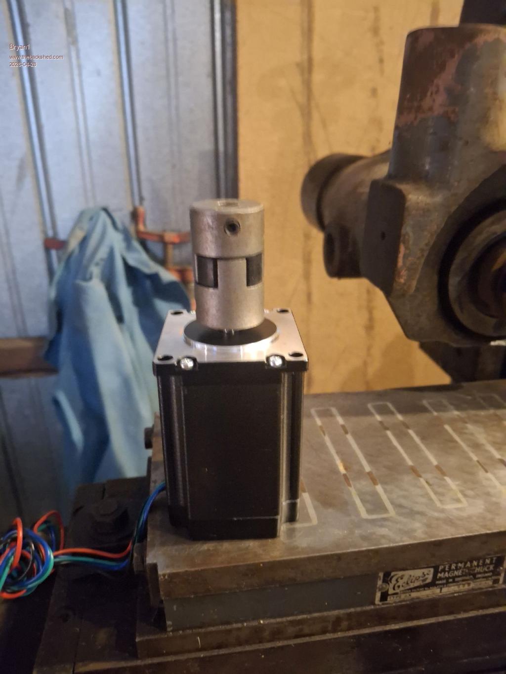

Anyway this morning went for drive upto Murray Bridge to Eastside Bearings and found they only had one flexible coupling
Now this coupling has an 8mm bore and fits the stepper shaft very nice   so that takes care of 2 steppers and the other couplings should be a couple of days away. Also I go onto ebay and ordered another stepper motor so that should be here in about a week.
Now for mounting the stepper motors I'm going to machine up a hard coupling so the alignment and spacing will be right so the flexible coupling can be installed esily and right.

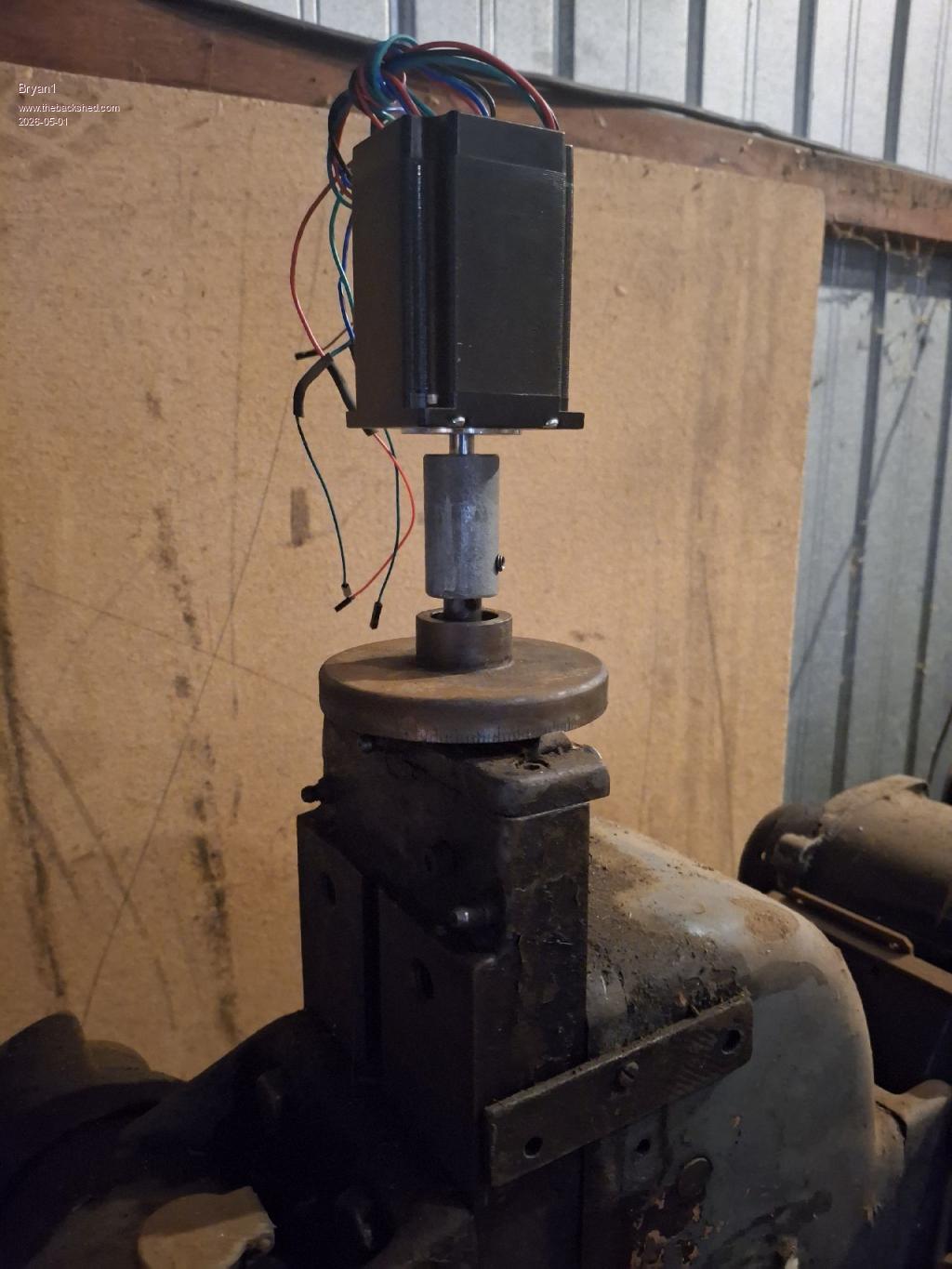

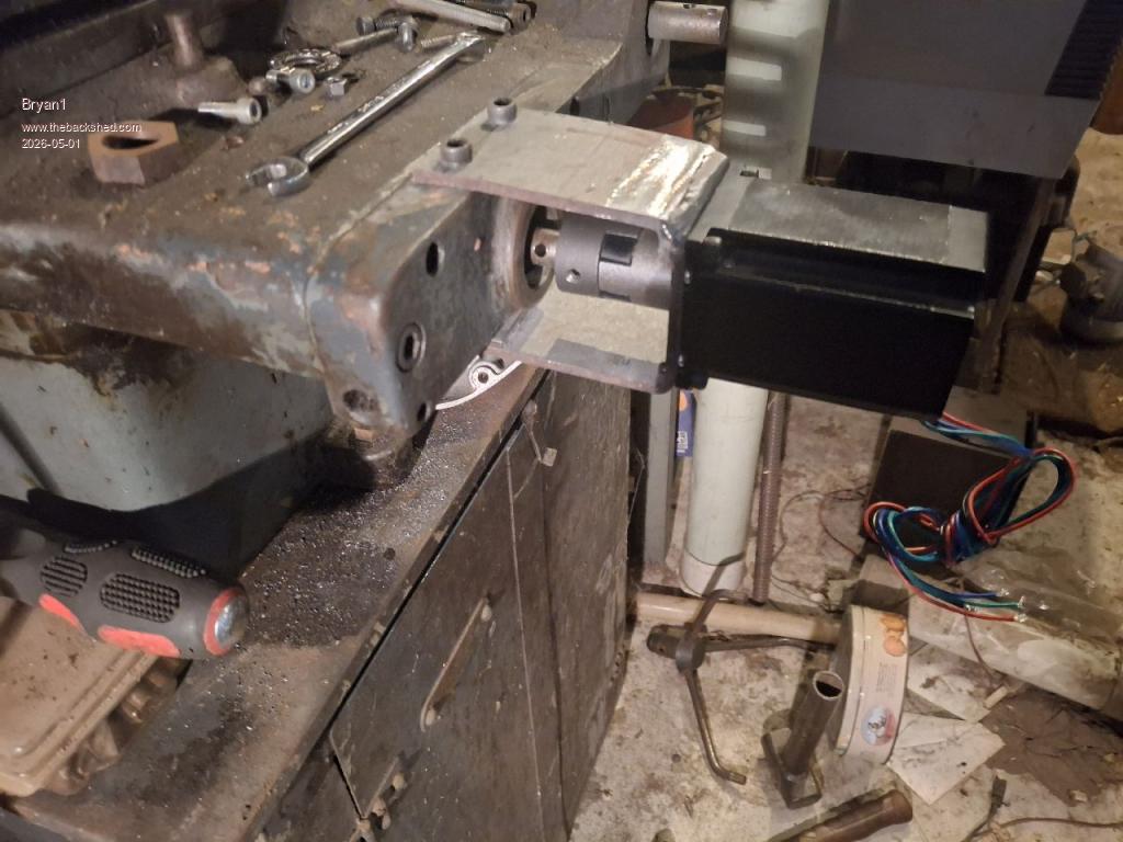

That third stepper motor just turned up today so went and collected it   and the 2350A pico2 boards should be here withing the week so thought better get on mounting these stepper motors
I machined up a hard coupling to use and reamed a 8mm bore for the stepper motor shaft so when the stepper motor is removed and reinstalled until it's a nice slide in fit more adjustments are done to ensure the flexible coupling is aligned.
So this is the Y axis stepper mount where I have some 100mm x4mm thick square RHS to use so by using a 40mm holesaw and drilling/tapping M5 the stepper can be mounted. The lower part was made first and got the height right so the stepper does just slide in and out and with the top section for now I will bolt it in and once it's right I will put a weld across that top section to fully brace it.
Still got drill the top plate and drill/tap some M6 holes to mount the plate, as the leasdscrew isn't centred on the front plate it was a bit of fun getting the height right. Now will will get this Y axis all finished now I have all the flexible couplings as with the X axis the output shaft is 5/8" so I'll machine the hard coupling to 5/8" to the X axis can be installed.
Now I did have some thrust bearings here so the Y axis got a new one and I did find the X axis one was still good. The pin holding the X axis handle is pretty tight so I'm going to drill it out then I can check the shaft size and if is 1/2" that will be next axis to install.
So getting there guy's and still a heap of work to go where alot of thought is needed designing these stepper mounts.

Bryan1
Joined: 22/02/2006
Posts: 2298
Posted: 06:18am 01 May 2026

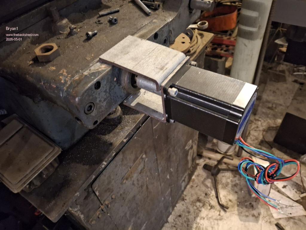

Ok welded up the top brace and after cleaning up the weld, retapped the top holes as there were very close to the weld and with the hard coupling on it pushed home very easily
Machined up the first flexible coupling 1/2" and re tapped the grub screw hole to 6mm and made an impression in the shaft with a 5mm drill to let the grubscrew clamp right down for the drive.
After I put the stepper on checked the alignment of the flexible coupling and it's within 0.002"   so there shouldn't be any pressure on the stepper bearings.
Now the fun part of designing the X axis mount
As the Y axis did take a few days to do this X axis needs a whole new train of thought and that yard arm is getting pretty close
Regards Bryan

Probably already aware of this but it's also a good idea to not have the coupling fully pushed together so that any float from the screw side doesn't get transferred to the motor shaft.

The more I'm thinking about this the easier it's going to be   been scratching around looking for steel to use and as I do have plenty of 50x6 angle iron trimming some down to mount on each side of the slide then weld in a plate on the top then a flat plate to mount the stepper. Also welding on some bracing so the stepper is nice and firm on the mount.
Now the X axis one I do have make and bolt on a plate then workout the best way to mount the stepper which is going to take alot of thought on going the best way to make a solid mount.
I am thinking of mounting the DM556's on the left side of steel bench so if they do get hot plenty of steel as a heatsink. Then after every is done just make a case with a door to enclose it all.

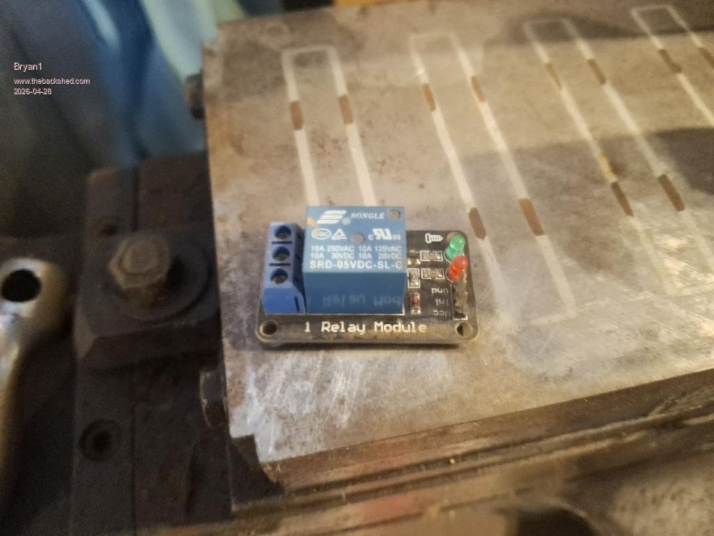

With that relay board I showed I do think it's best job as I'm just going to use that single phase motor can be used the start switch using a M code in the code. Now as this came without the AC connections at a later stage I will put up a pic of the motor connection so I can get the wires right.
