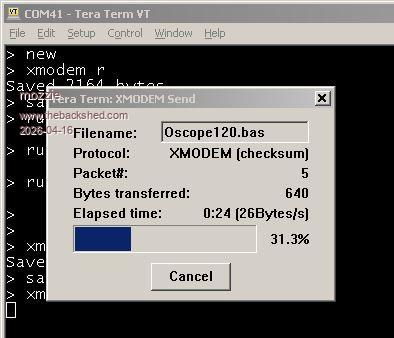

Testing V6.02.02B2/B4 has shown XModem is working to program memory but locking up when saving to A:

Lyle.
Posts: 12174
Posted: 04:28pm 15 Apr 2026
Just worked perfectly for me saving a 72Kb file to the A: drive HDMIUSB version B4
homa
Joined: 05/11/2021
Posts: 755
Posted: 07:40pm 15 Apr 2026
  mozzie said  Testing V6.02.02B2/B4 has shown XModem is working to program memory but locking up when saving to A:
Lyle,
check your version of Tera Term! I also had to upgrade from an older version to 5.2 (I think 5.6 is the latest) to sort out some Xmodem issues.
Matthias
