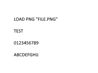

Has anyone used PNG files, and used the command: LOAD PNG "filename.png"
I get Error: Not enough Heap memory
Can someone test if it works (I don’t know if I have the right format or what it could be...)
The file that doesn’t work for me is this one
png-test.zip
/Peter63

Posted: 02:19pm 12 Mar 2026
This is a known limitation that has been discussed before. Decoding png files take a huge amount of memory. It will only work with relatively small files
Peter63
Joined: 28/07/2017
Location: Sweden
Posts: 220
Posted: 02:22pm 12 Mar 2026
OK !    /Peter63
