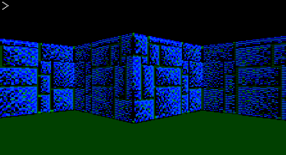

I took the time to implement your suggestion.
It looks really good for a Pico.
However, as expected, the frame rate drops to below 1 FPS/s.
What still runs and looks quite acceptable under MMB4W is simply no longer (seriously) executable for the Pico or Pico2.
I'm not sure if it's possible to improve the frame rate, but I'm afraid it's not possible to make it run on the Pico.
Of course, as you suggest, you can increase the step width both horizontally and vertically and then work with the box command, but this will make the texture coarser beyond recognition.
The solution here would be a scalable version of the Blit command, but we don't have that.For the sake of completeness, I'll attach it anyway.
Maybe someone can speed things up after all.
