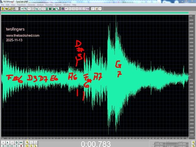

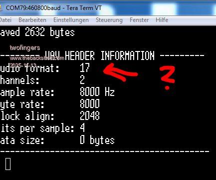

The WAV format is unusual (type 17) and the signal level is abysmal.
I made a first attempt with Cooledit, but only found 8 different tones:
D3, D#3, A6, E6, F#6, A7, D7, G7
That doesn't seem very plausible to me.
My suggestion: You could use a better microphone and ring the bells individually. Or check if they might even be stamped? ;-)
The storage format shouldn't be ADPCM, but PCM, mono, 16 bits/sample.

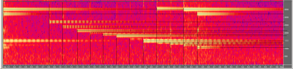

My version of CoolEdit using waterfall display
Frequencies detected (first number is time from start):
0 3500 3200 2130 1500 1210 1060
0.81 2750
1.04 2400
1.3 2130
1.53 2020
1.75 1900
1.99 1800
2.21 1600
2.46 1500
2.69 3500 1400
2.925 1350
3.165 3500 1210
3.41 3200 2130 1060

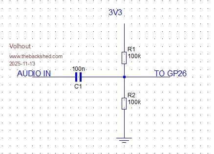

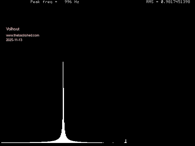

The screen will show the spectrum, the top right corner will show the level you input, try to increase the volume so get close to 1Vrms. Not higher, since you overdrive the input ADC. The sampler works at 10kHz, so you should be able to detect all frequencies up to 5kHz.
This is the input circuit I used.
P.S. the audio analyzer loop time is 70ms, so it most likely is fast enough to detect all notes (200ms between bells).

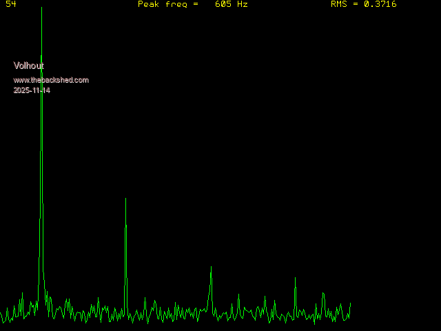

Update to the spectrum analyzer for pico VGA.
GP26_audio_analyzer_VGA_2.zip

79          2489.0 Hz  D#7
     2375
78          2349.3 Hz  D 7
77          2217.5 Hz  C#7
     2140
76          2093.0 Hz  C 7
     2016
75          1975.5 Hz  B 6
     1899
74          1864.7 Hz  A#6
     1803
73          1760.0 Hz  A 6
72          1661.2 Hz  G#6
     1607
71          1568.0 Hz  G 6
     1487
70          1480.0 Hz  F#6
     1403
69          1396.9 Hz  F 6
     1349
68          1318.5 Hz  E 6
67          1244.5 Hz  D#6
     1240
66          1174.7 Hz  D 6
65          1108.7 Hz  C#6
     1080
64          1046.5 Hz  C 6
First column is the piano key number
second column is the tones found in the recording
finally the standard notes as a reference.
The interval between notes was a consistent (considering electro-mechanical parts) 240mS or multiple of.
I don't have a musical bone in my body so there may be errors in the descriptions
