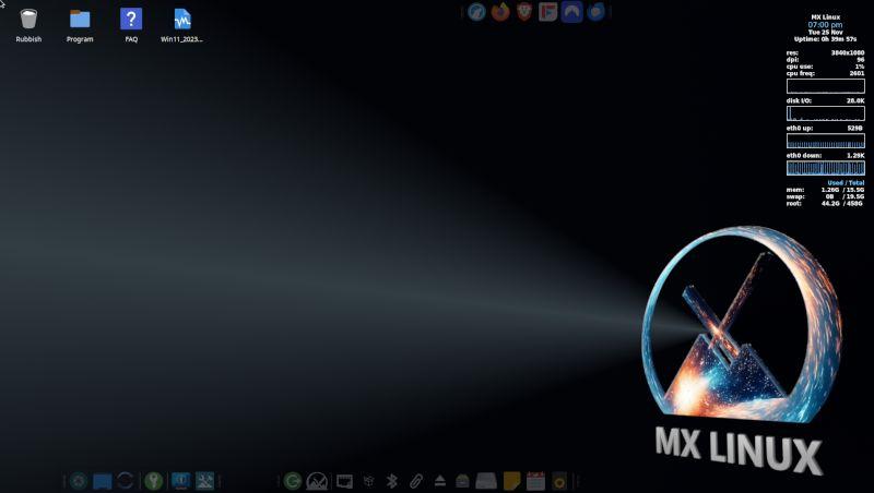

KeepIS
Joined: 13/10/2014
Posts: 2287
Posted: 09:31am 25 Nov 2025
FYI below is a Screen grab of my Desktop on the main monitor: It looks rich and liquid in real life. Nothing like the drab Screen grab.
I added a few Task Bars and set the Opacity to 30% until mouse over, and they auto hide if covered by any part of a window, for me this keeps the desktop looking uncluttered.
Unlike MS Windows "hide the taskbar" crap, which if so flaky, this Linux implementation is just perfect.
Why do I personally like this ?:
Because when I'm at full screen in any app, especially a browser or programming IDE, I don't want to task switch, change virtual desktops, press a reveal desktop key or any other time wasting crap to launch or find something.
I usually want access to the File system, folder or another app to look something up or save copied information to a file etc. This is brilliant for me, just move the mouse to the top or bottom of screen for the taskbar I want to use, task bar changes to 100% Opacity as it comes to the foreground.
Most may hate this, but whatever floats your boat, as the saying goes, that's why I like Linux, I/we can make it our own to suite us.
