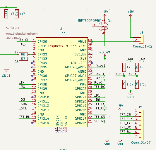

Posted: 04:50pm 21 Oct 2025
  matherp said
  Quote  One more question: MM.SUPPLY:
What board are you using? Only designed to work for standard Pico/Pico2
I am using a standard Pico 2
> option heartbeat off
> for i=0 to 99: ?MM.Supply : Pause 100 : next
0.07736263736
0.07494505495
0.07736263736
0.07736263736
0.07978021978
0.07494505495
0.07736263736
0.07736263736
0.07736263736
0.07736263736
0.07736263736
0.07978021978
0.07736263736
0.07736263736
0.07736263736
0.07736263736
0.07736263736
0.07736263736
0.07736263736
0.07494505495
0.07736263736
0.07736263736
0.07736263736
0.07736263736
0.07736263736
0.07978021978
0.07736263736
0.07736263736
0.07736263736
0.07736263736
> option heartbeat on

I am applying approx. 5V from battery (via a step-up converter) to VSYS. for the test above, I used a USB dongle that just provides data and ground (no power).

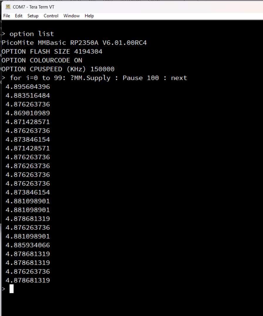

Posts: 12176
Posted: 08:24pm 21 Oct 2025
Must be something h/w related. Faulty Pico2? or something in your design? Results are the same with heartbeat on or off.
Edited 2025-10-22 06:25 by matherp
Posts: 3429
Posted: 09:35pm 21 Oct 2025
Looking at the Pico 2 schematic the Vsys voltage divider is connected to ADC3 via MOSFET Q1. Q1 gate should connect to 3.3V but if the track is open circuit at the 3.3V end and passes close to the heartbeat led track it might produce the result you are seeing.
Also tested a Pico 2 with same result that Peter got, with heartbeat on and off.
https://datasheets.raspberrypi.com/pico/pico-2-datasheet.pdf
Edit.
Tried another module and get a constant 2.98V. Same with:-
for i=0 to 99: ? pin(gp29)*2 : Pause 100 : next
May be something fishy with these modules. Investigating further.
Edit 2.
  Quote  Also tested a Pico 2 with same result that Peter got, with heartbeat on and off.
No I didn't. Not paying attention, it also gives 2.9V for MM.SUPPLY and pin(gp29)*2.
A closer look at the schematic and the voltage divider has a second lower leg (100kΩ) on GPIO29 so using ? pin(gp29)*3 gives 4.48V and I measure 4.50V on Vsys.
It would appear the RP2350 VGA firmware MM.SUPPLY is using GP29 x 2 instead of x 3.
> ? mm.supply, pin(gp29)*2, pin(gp29)*3
2.997802198     2.987863248     4.482197802
PicoMiteVGA MMBasic RP2040 Edition V6.01.00RC4 is correct.
4.885934066     3.23015873      4.838388278
Karlelch's issue remains a mystery.

karlelch
Joined: 30/10/2014
Posts: 368
Posted: 03:48pm 22 Oct 2025
  matherp said  Must be something h/w related. Faulty Pico2? or something in your design? Results are the same with heartbeat on or off.
Strange. Not aware that the Pico 2 is faulty - everything else works. Unfortunately, I cannot easily replace it because I soldered it in ...
  phil99 said  Karlelch's issue remains a mystery.
Thanks for testing - I agree.
Is "OPTION HEARTBEAT OFF" is switching the 1Hz interrupt off or does it just disable the LED blinking?
In any case, it may be just a side-effect of my circuit. As said above, everything else works and I was just curious about "MM.SUPPLY".
Best
Thomas
