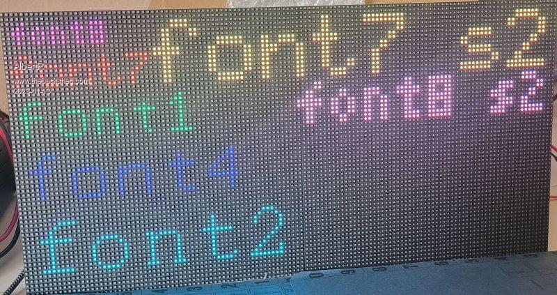

Hi together,
my last Bitmap-Userdriver for the Hub-display has problems with different fonts and "scale". I changed that in this version
Hub75User128x64.zip
I don't know if this is the quickest solution, but maybe someone would like to take a look at it.
If someone want to use my PIO-Program for the Hub75, I have noticed that the output no longer works with version RC11. For testing purposes, only use b14 up to RC10.
Albert

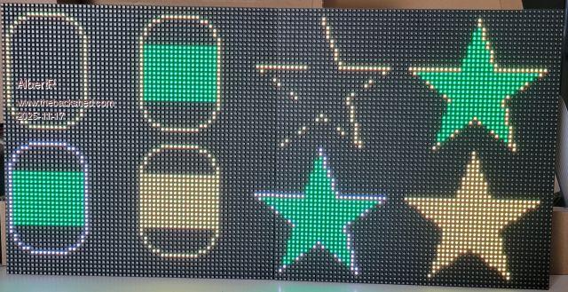

Hi Peter,
I think I have found an other bug of the Userdisplay-driver in Basic
The picture show the problem, Roundes Boxes work in Outline perfect but fails in filling, with Polygons it is reversed.
Albert
Posts: 12175
Posted: 11:01am 17 Nov 2025

Posted: 01:02pm 17 Nov 2025
Hi Peter,
I tried it with RC14, the same result. All other draw-functions for the "Userdisplay" works perfect as you can see in the video.
UserRboxPolygonTest_.zip
Albert
Edited 2025-11-17 23:02 by AlbertR

Posts: 12175
Posted: 05:28pm 17 Nov 2025
I suspect your drawrectangle routine isn't sorting the coordinates
Sub mm.user_rectangle x1,y1,x2,y2,col
local integer t
If x2<=x1 Then
t=x1
x1=x2
x2=t
EndIf
If y2<=y1 Then
t=y1
y1=y2
y2=t
EndIf
The other bug will be fixed in RC15
AlbertR
Joined: 29/05/2025
Posts: 111
Posted: 06:55pm 17 Nov 2025
Hi Peter,
that helped, thanks.
Polygon and RBox work now.
Sorry, my mistake.
Greetings
Albert

Posted: 12:47pm 18 Nov 2025
Hi Kevin,
here my last sample/test program for the user-display-functions. It knows
CLS ,PIXEL, LINE, BOX, RBOX, CIRCLE, TEXT, GUI BITMAP, POLYGON and ARC
I hope I did not forget one.
Hub75User128x64.zip
this time no video
At the moment, you need a 2350 for 128x64. I may change that in the future. Possible with only 64 colors(RGB222). It looks like nobody wants 4096(RGB444).
There is still the problem with the DMA TX-ringbuffer, but the appended programm should work with your display.
Albert
