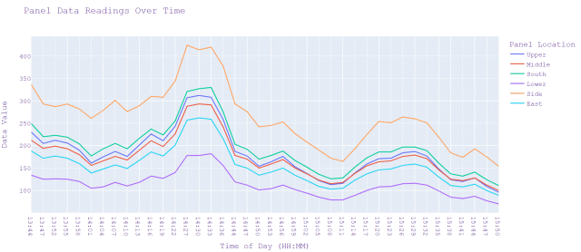

Posted: 07:28pm 28 Jun 2025
English as a programming language
I've written maybe 3 very simple Python programs in my life, and haven't touched it in years. But apparently python is the programming language of AI.
In Google Gemini, I made this request:
Please produce python code for a raspberry pi which will read a file containing lines like the following one and produce a line chart graph with 6 lines labeled "Upper", "Middle", "South", "Lower", "Side", and "East":
250628144138  14.8  223 15.1 9.8  207 21.2 10.5  238 22.7 8.8  136 15.4 10.2  334 32.8 9.7  184 18.9
Data items are separated by one or more spaces. The 7th and 8th characters in the first data item are the hour of the day ("00" - "23") and the 9th and 10th are the time in minutes. These make up the horizontal axis of the graph. Note that the horizontal spacing must account for 60 minutes to the hour, not 100.
The numbers to be plotted for each time slot are the 3rd, 6th, 9th, 12th, 15th, and 18th data items.
The file to be read will be named "/home/nn/panels.txt". The output file will be named "/home/nn/panels.html".
I have 6 mini solar panels placed variously on the front of my barn, nominal 18V max, less than 2-3 watts. I want to chart production over the course of a day so that I can understand shading over time. It has been almost totally overcast today, with a short period of very weak sun.
Here is the code which Gemini produced:

I changed only the paths of the input and output files to fit my Pi.
Here is my data for the 2+ hours I had the program working (6 INA226 current monitors calculating current through 12V-24V LED modules being read by an ESP32-C3Supermini):
250628134452  14.9   230 15.4 9.8   212 21.6 10.5   249 23.6 8.8   134 15.2 10.2   336 32.9 9.8   188 19.2
250628134752  14.5   205 14.2 9.7   194 19.9 10.4   220 21.1 8.8   125 14.2 10.1   293 29.1 9.7   172 17.7
250628135254  14.6  212 14.5 9.8  199 20.4 10.4  223 21.3 8.8  126 14.3 10.1  287 28.5 9.7  177 18.2
250628135554  14.5  206 14.2 9.7  193 19.8 10.4  219 21.0 8.8  125 14.2 10.1  293 29.1 9.7  172 17.7
250628135854  14.2  190 13.3 9.7  180 18.5 10.4  204 19.7 8.8  120 13.6 10.0  282 28.1 9.7  160 16.5
250628140154  13.7  161 11.7 9.6  156 16.1 10.3  177 17.2 8.7  105 12.1 10.0  261 26.2 9.6  139 14.5
250628140454  14.0  175 12.5 9.7  166 17.2 10.4  193 18.6 8.7  108 12.3 10.0  279 27.8 9.6  148 15.3
250628140754  14.2  187 13.2 9.7  176 18.2 10.4  205 19.7 8.8  118 13.4 10.1  301 29.8 9.7  157 16.2
250628141054  14.0  176 12.5 9.7  168 17.3 10.4  193 18.7 8.8  110 12.6 10.0  276 27.5 9.6  149 15.4
250628141354  14.4  201 13.9 9.7  190 19.4 10.4  216 20.7 8.8  118 13.5 10.1  289 28.7 9.7  167 17.3
250628141654  14.8  226 15.2 9.8  211 21.5 10.5  237 22.6 8.8  132 14.9 10.1  310 30.6 9.8  186 19.1
250628141954  14.6  211 14.5 9.8  198 20.3 10.5  224 21.4 8.8  127 14.4 10.1  308 30.5 9.7  177 18.1
250628142254  15.1  243 16.1 9.8  226 22.9 10.6  255 24.2 8.8  140 15.8 10.2  344 33.7 9.8  201 20.5
250628142724  16.0  307 19.2 10.0  288 28.7 10.7  321 29.9 8.9  178 19.9 10.4  424 40.8 10.0  257 25.8
250628143024  16.1  312 19.4 10.0  293 29.3 10.8  327 30.4 8.9  178 19.9 10.4  414 39.9 10.0  262 26.3
250628143324  16.0  308 19.2 10.0  291 29.0 10.8  330 30.6 8.9  182 20.3 10.4  420 40.4 10.0  259 26.0
250628143624  15.3  259 16.9 9.9  242 24.5 10.6  276 26.0 8.9  156 17.6 10.3  378 36.8 9.8  216 21.9
250628144438  14.2  187 13.2 9.7  178 18.3 10.4  203 19.6 8.8  119 13.5 10.1  293 29.1 9.7  158 16.3
250628144738  14.0  177 12.6 9.7  170 17.5 10.3  192 18.5 8.8  112 12.8 10.0  276 27.5 9.6  150 15.6
250628145038  13.6  154 11.3 9.6  150 15.7 10.3  170 16.5 8.7  101 11.5 9.9  242 24.3 9.6  134 14.0
250628145338  13.8  164 11.9 9.6  159 16.5 10.3  178 17.3 8.7  104 11.9 9.9  245 24.6 9.6  141 14.7
250628145638  14.0  176 12.6 9.7  169 17.5 10.3  188 18.2 8.8  112 12.7 10.0  253 25.3 9.6  150 15.6
250628145938  13.6  153 11.3 9.6  150 15.6 10.3  167 16.3 8.7  102 11.7 9.9  227 22.9 9.6  134 14.0
250628150238  13.3  138 10.4 9.6  137 14.3 10.2  152 14.9 8.7   94 10.7 9.8  208 21.1 9.5  122 12.7
250628150538  12.9  122 9.4 9.5  123 12.9 10.1  136 13.4 8.7   85 9.8 9.8  190 19.4 9.5  109 11.5
250628150838  12.8  113 8.9 9.5  115 12.1 10.1  126 12.5 8.7   79 9.1 9.7  172 17.7 9.5  103 10.9
250628151138  12.8  116 9.0 9.5  118 12.4 10.1  128 12.7 8.7   79 9.1 9.7  165 17.0 9.5  105 11.1
250628151438  13.3  139 10.4 9.6  138 14.4 10.2  152 14.8 8.7   89 10.3 9.8  193 19.7 9.6  123 12.8
250628151738  13.7  159 11.6 9.6  155 16.1 10.3  173 16.8 8.7  100 11.5 9.9  225 22.8 9.6  137 14.3
250628152038  13.9  171 12.3 9.7  164 17.0 10.3  186 18.0 8.8  108 12.4 10.0  254 25.5 9.6  146 15.2
250628152338  13.9  172 12.3 9.7  166 17.2 10.3  186 18.0 8.8  109 12.5 10.0  251 25.2 9.6  148 15.3
250628152638  14.1  184 13.0 9.7  176 18.1 10.4  197 19.0 8.8  115 13.1 10.0  264 26.4 9.7  156 16.2
250628152938  14.2  187 13.2 9.7  179 18.4 10.4  197 19.0 8.8  116 13.3 10.0  260 26.1 9.7  159 16.4
250628153238  14.0  177 12.7 9.7  171 17.6 10.3  189 18.3 8.8  112 12.8 10.0  251 25.2 9.7  152 15.8
250628153538  13.5  148 11.0 9.6  146 15.2 10.2  161 15.8 8.7   99 11.3 9.9  219 22.2 9.6  130 13.6
250628153838  13.0  124 9.5 9.5  125 13.1 10.1  137 13.5 8.7   85 9.8 9.8  184 18.9 9.5  111 11.7
250628154138  12.9  120 9.3 9.5  122 12.8 10.1  132 13.0 8.7   82 9.4 9.7  174 17.9 9.5  108 11.4
250628154438  13.1  128 9.8 9.5  128 13.4 10.2  141 13.9 8.7   87 10.0 9.8  193 19.7 9.5  114 12.0
250628154738  12.7  109 8.6 9.5  112 11.8 10.1  124 12.2 8.6   77 8.9 9.7  175 17.9 9.5  100 10.5
250628155038  12.4   96 7.8 9.4  100 10.6 10.0  111 11.0 8.6   70 8.1 9.7  154 16.0 9.4   89 9.4
It ran with no changes. I copied the output html file to /var/www/html, and it immediately displayed when I entered the URL:
I am very impressed. It no doubt would have taken me many hours to produce this chart using MMBasic DOS or MMB4L or lua or php. All I did was provide a sufficiently complete specification and some data. I like that it was able to pick out the data from my saying use the 3rd, 6th, 9th, 12th, 15th, and 18th words in each line.

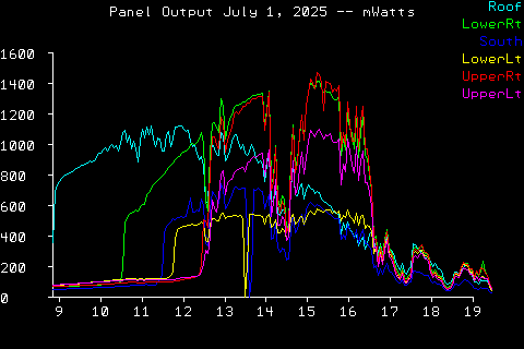

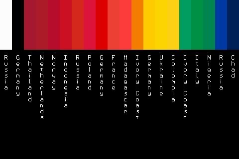

Posted: 01:01pm 05 Jul 2025

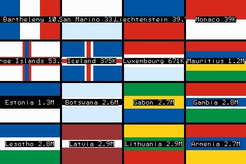

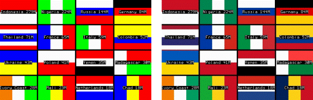

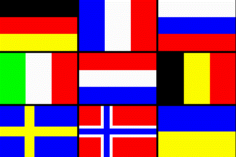

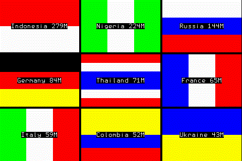

AI writes MMBasic code
After getting Google Gemini 2.5 Pro to write python code to chart my mini-solar panels current on an ILI9341 over the course of a day, I asked it to do the same for an ILI9488. 3+ hours later and 4 different ili9488.py drivers, it had still not drawn a line or written text to the LCD, and it gave up.
It said that the fourth driver had derived from MMBasic source code (because I had shown that MMBasic could write the ILI9488 screen on the same hardware). (I doubt that it had looked at the MMBasic source, because it later said that it could not look at external sources).
So I asked it to write MMBasic code for the ILI9488, and it said it could. I gave it an 8-line program which illustrated all the graphical elements.
cls
line 48,0,48,272 ' draw vertical axis line
line 48,272,mm.hres,272 ' draw horizontal axis line
Text MM.HRes/2,0,"Panel Output July 4, 2025",c,2,,rgb(yellow) ' print heading
text 60,278,"  9",V,1 ' print first time vertically
text 8,36,"1400",,1 ' print first (highest) milliwatt reading
dim integer  mv(16)=(270,250,200,180,185,150,125,200,110,85,70,180,170,200,240,270,270) ' points to plot
line plot mv(),,50,20,,,rgb(yellow) ' plot the points
Not to laugh but it was 20+ painful versions before it was actually plotting, and Version 26 gave a good plot. Version 33 got some labelling tweaks finalized (279 lines of code):

I asked it if it could use MMB4L on a linux device or MMB4W on Windows to check syntax. It said it couldn't (although it can and does produce and run python code when you ask it to do some research and produce an Excel chart). I think it can check syntax on C code as well.
So it was a painful session, but I learned a lot and had a good outcome. The steps were not too different from my own coding process--use F10 AUTOSAVE to throw code into the PicoMite, then fix syntax errors, then fix logic errors.
Thoughts for future use
I wonder if feeding it one of the recent MMBasic "help" files would enable it to avoid incorrect syntax. It's not hard to conceive that a near-future coding AI could have access to run MMB4L or MMB4W code in a sandbox to fix syntax errors before presenting code to the user.
Conclusion
Anyway, it was an interesting and fun effort. So now I have a somewhat capable and somewhat imbecilic junior programmer assistant for $.70 a day. More than what I had hoped for when I started this tread, but also in some ways less. Everything is happening fast.

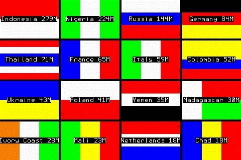

With a Pico 2 flashed with MMBasic, I issued "LIST commands" and scraped the TeraTerm screen and saved "commands.txt" and then "LIST functions" and saved that as "functions.txt". I downloaded electricat's help.txt file from here: https://www.thebackshed.com/forum/ViewTopic.php?TID=17777&PID=237581#237581#237581
I had to edit lightly. I removed the OPTION entries, and because AUTOSAVE choked on /hex, I edited or deleted the entries which had that (and something else involving "/").
I uploaded those three files to Gemini and told it to use only the commands and functions in those files, and to look into help.txt to find clues for syntax (and said that for many commands it might need further help with syntax and meaning of parameters). It said it understood and would use the proper commands and functions.
I then fed it this specification:
The flags of Germany, France, Russia, Italy, The Netherlands, Belgium, Sweden, Norway, and Ukraine can all be drawn using the line command (with width specified) and the defined colors. For fun, please produce an MMBasic program filling the ILI9488 screen with those 9 flags with 3 rows of 3 flags and 4 pixels between each flag and each row.
Three versions later (less than 15 minutes), after one syntax error and one misalignment of the flags, this is what it produced:
Pretty impressive, I think. It actually used the BOX command, not the LINE command (it said its misunderstanding of the LINE command with LW parameter had caused the misalignment of Version 2). I did not tell it what colors to use for the flags--it figured that out on its own.
Here's the code (120 lines):

Today's task for Gemini was to get more realistic colors for the 16 flags. I had originally told it to use the named colors: rgb(red), rgb(green), etc. I asked if it could search out flag images on the web and determine the right colors. It said it could, so I set the specification:
Please use your understanding of RGB to get a closer match to the actual color as you find flag examples online in the RGB format (e.g., RGB(130,148,5) for dark yellow). Produce a program for that in the 4x4 format last used. So each flag may have a different version of what we might generally call "green".
I thought that if it could find appropriate RGB settings, which it quickly did, this would be result in a quick solution. Unfortunately, for reasons which were mostly silly, it took until Version 13. Among the inexplicable regressions were returning to 9 flags in the 3x3 format, omitting the text, and most contradictory to the specification, returning to the named colors after it had successfully drawn using better colors.
But here's the final result--first with the named colors on the left, then with more accurate colors:
The reds, greens, yellows, and blues are notably darker. You can see the difference between adjacent blues with Thailand and France and Netherlands and Chad, and greens between Ivory Coast and Mali.
Although it was frustrating for it to take so many iterations when it had immediately solved the color problem, the process is pretty straightforward. Usually within a minute of my presenting an error (or a specification), it has new code, which I copy and paste into TeraTerm after F10 AUTOSAVE. Ctrl-Z, run, and there's a new result.
The program--now Version 17 (219 lines) because I noticed a problem with the rendering of the Thai flag (the only one with more than 3 boxes to be drawn).

FlagNumber = 1
FOR Row = 0 TO 3
   FOR Col = 0 TO 3
       x = Col * (FlagW + Gap)
       y = Row * (FlagH + Gap)
       idx = FlagNumber - 1
       SELECT CASE FlagNumber
           CASE 1: DrawIndonesia x, y
           CASE 2: DrawNigeria x, y
           CASE 3: DrawRussia x, y
           CASE 4: DrawGermany x, y
           CASE 5: DrawThailand x, y
           CASE 6: DrawFrance x, y
           CASE 7: DrawItaly x, y
           CASE 8: DrawColombia x, y
           CASE 9: DrawUkraine x, y
           CASE 10: DrawPoland x, y
           CASE 11: DrawYemen x, y
           CASE 12: DrawMadagascar x, y
           CASE 13: DrawIvoryCoast x, y
           CASE 14: DrawMali x, y
           CASE 15: DrawNetherlands x, y
           CASE 16: DrawChad x, y
       END SELECT
       DrawLabel x, y, Names$(idx), Pops$(idx)
       FlagNumber = FlagNumber + 1
   NEXT Col
NEXT Row
END
' SUBROUTINES
SUB DrawLabel(x, y, Name$, Pop$)
   LOCAL INTEGER CenterX, CenterY, LabelTextLen
   LOCAL STRING LabelText$
   CenterX = x + FlagW \ 2
   CenterY = y + FlagH \ 2
   LabelText$ = Name$ + " " + Pop$
   LabelTextLen = LEN(LabelText$)
   TEXT CenterX - (LabelTextLen * MM.FontWidth / 2) , CenterY - (MM.FontHeight \ 2), LabelText$, , , , White, Black
END SUB
' --- Flag Drawing Subroutines using the BOX command ---
SUB DrawIndonesia(x, y)
   LOCAL INTEGER StripeH = FlagH \ 2
   BOX x, y, FlagW, StripeH, 0, IndoRed, IndoRed
   BOX x, y + StripeH, FlagW, FlagH - StripeH, 0, White, White
END SUB
SUB DrawNigeria(x, y)
   LOCAL INTEGER StripeW = FlagW \ 3
   BOX x, y, StripeW, FlagH, 0, NgrGreen, NgrGreen
   BOX x + StripeW, y, StripeW, FlagH, 0, White, White
   BOX x + 2 * StripeW, y, FlagW - 2 * StripeW, FlagH, 0, NgrGreen, NgrGreen
END SUB
SUB DrawRussia(x, y)
   LOCAL INTEGER StripeH = FlagH \ 3
   BOX x, y, FlagW, StripeH, 0, White, White
   BOX x, y + StripeH, FlagW, StripeH, 0, RusBlue, RusBlue
   BOX x, y + 2 * StripeH, FlagW, FlagH - 2 * StripeH, 0, RusRed, RusRed
END SUB
SUB DrawGermany(x, y)
   BOX x, y, FlagW, StripeH, 0, Black, Black
   BOX x, y + StripeH, FlagW, StripeH, 0, GerRed, GerRed
   BOX x, y + 2 * StripeH, FlagW, FlagH - 2 * StripeH, 0, GerYellow, GerYellow
END SUB
SUB DrawThailand(x, y)
   LOCAL INTEGER h_outer, h_center, h_inner
   h_outer = 13
   h_inner = 13
   h_center = 25
   BOX x, y, FlagW, h_outer, 0, ThaiRed, ThaiRed
   BOX x, y + h_outer, FlagW, h_inner, 0, White, White
   BOX x, y + h_outer + h_inner, FlagW, h_center, 0, ThaiBlue, ThaiBlue
   BOX x, y + h_outer + h_inner + h_center, FlagW, h_inner, 0, White, White
   BOX x, y + h_outer + h_inner + h_center + h_inner, FlagW, 13, 0, ThaiRed, ThaiRed
END SUB
SUB DrawFrance(x, y)
   BOX x, y, StripeW, FlagH, 0, RusBlue, RusBlue
   BOX x + 2 * StripeW, y, FlagW - 2 * StripeW, FlagH, 0, RusRed, RusRed
END SUB
SUB DrawItaly(x, y)
   BOX x, y, StripeW, FlagH, 0, ItaGreen, ItaGreen
   BOX x + 2 * StripeW, y, FlagW - 2 * StripeW, FlagH, 0, ItaRed, ItaRed
END SUB
SUB DrawColombia(x, y)
   LOCAL INTEGER h_top = FlagH \ 2, h_bottom = FlagH \ 4
   BOX x, y, FlagW, h_top, 0, ColYellow, ColYellow
   BOX x, y + h_top, FlagW, h_bottom, 0, ColBlue, ColBlue
   BOX x, y + h_top + h_bottom, FlagW, FlagH - (h_top + h_bottom), 0, ColRed, ColRed
END SUB
SUB DrawUkraine(x, y)
   BOX x, y, FlagW, StripeH, 0, UkrBlue, UkrBlue
   BOX x, y + StripeH, FlagW, FlagH - StripeH, 0, UkrYellow, UkrYellow
END SUB
SUB DrawPoland(x, y)
   BOX x, y + StripeH, FlagW, FlagH - StripeH, 0, IndoRed, IndoRed
END SUB
SUB DrawYemen(x, y)
   BOX x, y, FlagW, StripeH, 0, YemRed, YemRed
   BOX x, y + StripeH, FlagW, StripeH, 0, White, White
   BOX x, y + 2 * StripeH, FlagW, FlagH - 2 * StripeH, 0, Black, Black
END SUB
SUB DrawMadagascar(x, y)
   LOCAL INTEGER v_stripe_w = FlagW \ 3
   LOCAL INTEGER h_stripe_h = FlagH \ 2
   BOX x, y, v_stripe_w, FlagH, 0, White, White
   BOX x + v_stripe_w, y, FlagW - v_stripe_w, h_stripe_h, 0, MadRed, MadRed
   BOX x + v_stripe_w, y + h_stripe_h, FlagW - v_stripe_w, FlagH - h_stripe_h, 0, MadGreen, MadGreen
END SUB
SUB DrawIvoryCoast(x, y)
   BOX x, y, StripeW, FlagH, 0, IvcOrange, IvcOrange
   BOX x + 2 * StripeW, y, FlagW - 2 * StripeW, FlagH, 0, IvcGreen, IvcGreen
END SUB
SUB DrawMali(x, y)
   BOX x, y, StripeW, FlagH, 0, MaliGreen, MaliGreen
   BOX x + StripeW, y, StripeW, FlagH, 0, MaliYellow, MaliYellow
   BOX x + 2 * StripeW, y, FlagW - 2 * StripeW, FlagH, 0, MaliRed, MaliRed
END SUB
SUB DrawNetherlands(x, y)
   BOX x, y, FlagW, StripeH, 0, RusRed, RusRed
   BOX x, y + 2 * StripeH, FlagW, FlagH - 2 * StripeH, 0, NldBlue, NldBlue
END SUB
SUB DrawChad(x, y)
   BOX x, y, StripeW, FlagH, 0, ChadBlue, ChadBlue
   BOX x + StripeW, y, StripeW, FlagH, 0, ChadYellow, ChadYellow
   BOX x + 2 * StripeW, y, FlagW - 2 * StripeW, FlagH, 0, ChadRed, ChadRed
END SUB

Today:
A new task, as a lark, illustrating some independent investigation. This MMBasic program will be Version 1. Specification: determine how many unique colors there are on the 16 flags; sort them by wavelength into a rainbow arrangement; display a box for each color starting at y=0, depth 100 pixels, width=mm.hres/number-of-colors; below each color box print the country name with an "alignment" in the TEXT command of CT, which is to be centered below the box and printed vertically; avoid syntax errors by confirming that any variables used have been declared and that command or functions used are in the commands and functions text files provided earlier, or are supplied by you, and syntax conforms to the "help" file provided earlier.
I thought that if Gemini could sort the rgb colors in the flags in rainbow order, as it quickly showed it could with access to some API which gave it hue, this might be a one-and-done task.
Unfortunately, it was Version 10 before it got this:
Errors included undeclared variable (despite the fact that I have told it multiple times to always check before providing code that all variables are in DIM or LOCAL statements), giving country names of "Cyan" and "Magenta", regressing entirely to a version of the flags program, inventing a new parameter for the TEXT command (compounded by my initially saying the "alignment" parameter should be CT instead of CTV), and not sorting in rainbow order (with white and black first).
I eventually had to feed it the colors it had used in the flag program:
CONST IndoRed = RGB(206, 17, 38)
CONST NgrGreen = RGB(0, 135, 81)
CONST RusBlue = RGB(0, 57, 166)
CONST RusRed = RGB(213, 43, 30)
CONST GerRed = RGB(221, 0, 0)
CONST GerYellow = RGB(255, 206, 0)
CONST ThaiRed = RGB(165, 25, 49)
CONST ThaiBlue = RGB(45, 42, 114)
CONST ItaGreen = RGB(0, 146, 70)
CONST ItaRed = RGB(206, 43, 55)
CONST ColYellow = RGB(252, 209, 22)
CONST ColBlue = RGB(0, 56, 147)
CONST ColRed = RGB(206, 17, 38)
CONST UkrBlue = RGB(0, 91, 187)
CONST UkrYellow = RGB(255, 213, 0)
CONST PolRed = RGB(220, 20, 60)
CONST YemRed = RGB(206, 17, 38)
CONST MadRed = RGB(252, 63, 62)
CONST MadGreen = RGB(0, 129, 60)
CONST IvcOrange = RGB(247, 127, 0)
CONST IvcGreen = RGB(0, 158, 96)
CONST MaliGreen = RGB(20, 170, 52)
CONST MaliYellow = RGB(252, 209, 22)
CONST MaliRed = RGB(206, 17, 38)
CONST NldBlue = RGB(33, 70, 139)
CONST ChadBlue = RGB(0, 32, 91)
CONST ChadYellow = RGB(252, 209, 22)
CONST ChadRed = RGB(206, 17, 38)
The process was more frustrating than it should have been, but still pretty quick. I think its finding and sorting on the hue value was creditable--indicative of an ability to search for external means to solve a problem.
Here's the final code (63 lines):
' MMBasic Flag Color Spectrum (Version 10)
' Uses a manually sorted list of all unique colors for accuracy.

' DATA Section
' Data is pre-sorted: White, Black, Reds, Orange, Yellows, Greens, Blues
DATA RGB(WHITE), "Russia"
DATA RGB(0,0,0), "Germany"
DATA RGB(165, 25, 49), "Thailand"
DATA RGB(174, 28, 40), "Netherlands"
DATA RGB(186, 12, 47), "Norway"
DATA RGB(206, 17, 38), "Indonesia"
DATA RGB(213, 43, 30), "Russia"
DATA RGB(220, 20, 60), "Poland"
DATA RGB(221, 0, 0), "Germany"
DATA RGB(239, 65, 53), "France"
DATA RGB(252, 63, 62), "Madagascar"
DATA RGB(247, 127, 0), "Ivory Coast"
DATA RGB(255, 206, 0), "Germany"
DATA RGB(255, 213, 0), "Ukraine"
DATA RGB(252, 209, 22), "Colombia"
DATA RGB(0, 158, 96), "Ivory Coast"
DATA RGB(0, 146, 70), "Italy"
DATA RGB(0, 135, 81), "Nigeria"
DATA RGB(0, 57, 166), "Russia"
DATA RGB(0, 32, 91), "Chad"
I notice that although I gave it 28 rgb colors (that it had generated for the flags program), it only displayed 20. It is possible that its hue routine returned the same value for some. I didn't think to ask it if that was what happened.
The last part of the specification is boiler-plate which I will include with each new specification. I wish I could just say it once and be done, but that doesn't seem to be the case:

An exercise in continuity. Specification: using the uploaded program (Version 17 of the 4x4 flags program, which displays the flags the first 16 countries in the list at  https://en.wikipedia.org/wiki/List_of_countries_and_dependencies_by_population which can be drawn with the box command (having no angled or curved lines)), pick the 16 least populous countries on that list which fit that criterion and produce an MMBasic program to draw their flags in 4x4 format with accurate colors. Only the countries, the flags, the colors, and the text should need to be changed. Follow the Prime Directive.
Here's the result of the program it produced the first time (One&Done!):
No muss and no fuss. 194 lines of unaltered MMBasic code.

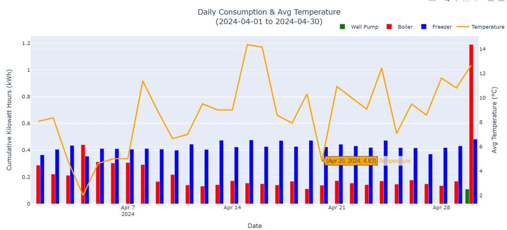

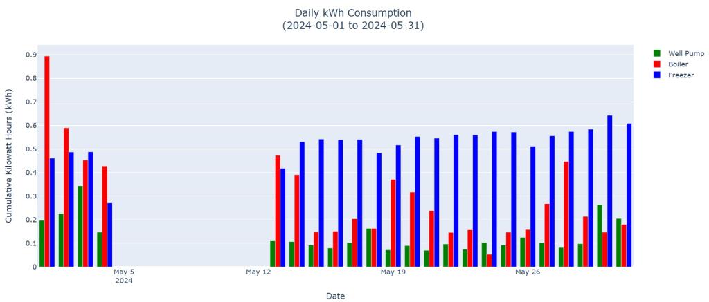

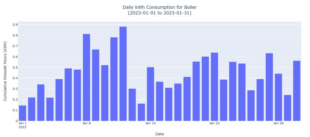

A different path. I have log files which record various sensor readings--mostly temperatures but also current usage for my boiler, freezer, and wellpump. A data record looks like this:
J 3 4 -1 240101071140.
A single first capital letter indicates the sensor/recordtype. In this case, "J" means readings from my barn. The 2nd word is temperature in °C in the barn at floor level, the 3rd is at waist level, and the 4th is outside. The 5th word is a timestamp in the format of "YYMMDDhhmmss". For the boiler, the letter key is "L" and a record looks like this: L 0 25 0.317 241026084155. The second word indicates appliance turned on or off ("1" or "0"); the third is number of milliwatt hours used since turned on, and the 4th is cumulative kilowatt hours for the day. The 5th is always timestamp.
I gave Gemini this prompt: Please produce a python program which will read an input file, "signals23.txt", and produce an html vertical bar chart file of watts consumed per day for one of three appliances. "L" as the first word of an input line stands for "Boiler", "T" stands for "Freezer", and "K" stands for "Well Pump". each record had 5 words separated by a space. A second word of "1" means the appliance turned on. A second word of "0" means it turned off. With a 2nd word of "0", the 3rd word will be the number watt hours used. The 4th word will be the cumulative kilowatt hours for the day, and the 5th word will be a timestamp in the form "YYMMDDhhmmss". When the program is run, query the user for the appliance ("L","T","K") and the starting and ending time periods in "YYMMDD" format. If the ending time period is blank, the period plotted with be the single day and each cycle end time will be plotted. If the ending time period is subsequent to the starting (e.g., a multi-day period), each point in the plot will be the 4th word of the final cycle end time for each day. Provide appropriate horizontal and vertical labels. The records will be like this
L 0 2 0.311 220114100313.
The first pass failed with "utf-8' codec" error. The second pass ignored records with those and produced a plot which included a negative value. I told it to ignore any negative readings of milliwatt hours. The next pass ran successfully and produced this chart of boiler usage for the month of January, 2023:

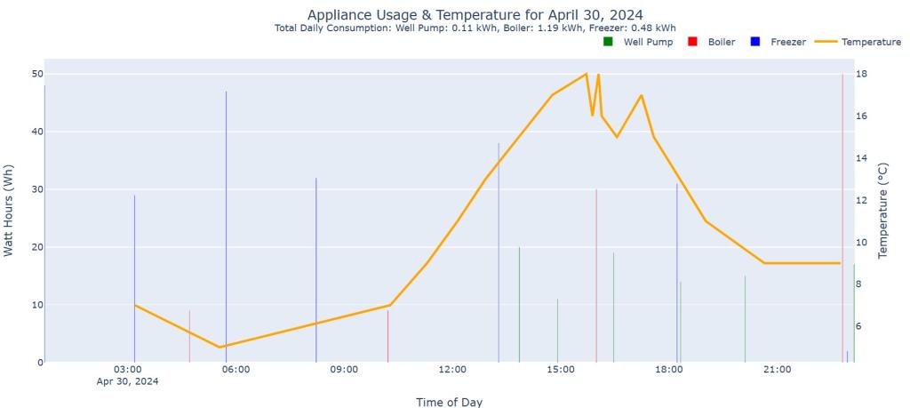

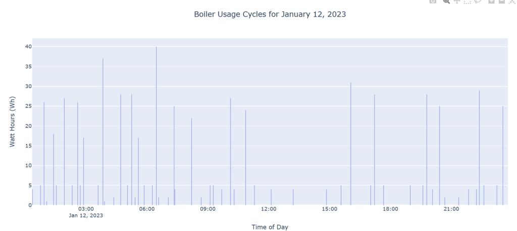

And then this for the day with most electricity used, Jan 12, 2023:
Some cycles of refinement later with only two errors (variable typo and misunderstanding of actual record type codes when I asked it to allow user input of B, F, W for Boiler, Freezer, Wellpump), I got this:
(Unfortunately my data accumulator had failed for May 5 - May 12.)
This was very easy development--few errors, all but two understandable, and a steady progression as I refined and expanded what I wanted the program to do. This particular kind of coding by AI seems essentially complete.
202 lines of python code (which I haven't even looked at).

I went further and asked it to chart a second y axis for daily or multi-day charts, providing the average of recorded temperatures for the day. The temperatures are in records keyed with "Y" in the first character position, and also asked it to accept an alternate input file if included on the command line (e.g., sudo python appliances.py signals24.txt). It did this.
(This chart may look somewhat peculiar, since the boiler usage on the last day of the month is many times what it was on the other days, and the wellpump didn't come on until that day--but this is correct, since we were away for the month, arrived on the 30th, and turned up the heat and used water.)
For a daily chart with temperatures I asked it to provide a second title line giving the total kilowatt hours for the boiler, freezer, and wellpump.
This shows that the well pump came on at about 1:30pm and the boiler thermostat was turned up at around 4pm. FYI .48kWh for the freezer costs about 8 cents Canadian, 6 cents U.S.
All of this flowed very easily. It would not usually take as much as a minute for code to be provided for a new requested feature. Copy and paste into nano on the pi, and run the python program; use the browser to check the html.
In the past I have been very pleased to look at charts I created with a program, but never with the process of writing and debugging the program. To me, this is a game changer for creating charts from established data.
