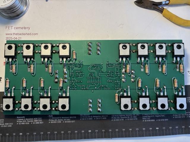

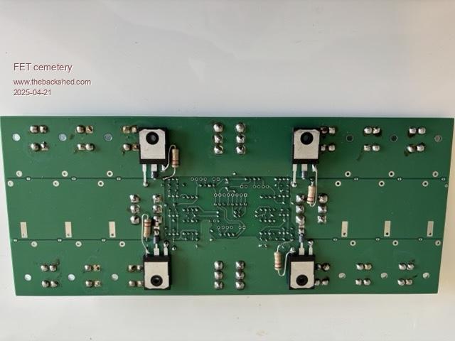

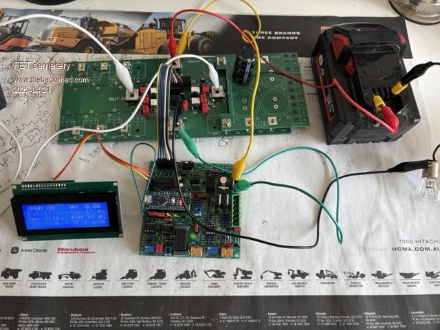

More progress
4 fets, running unloaded
No stone unturned, no FET unburned.
FET cemetery

Your Build is going well.
The aluminium bar under the mosfets would be preferred, give a little more clearance for the gecko's, I just chased one out of my inverter.
Cheers Aaron

Posted: 07:39am 21 Apr 2025
The aluminium bar might let the mice in though.
The fet board really is a work of art, shame it has to be hidden by the heatsink.

Is it better thermally to have the heatsink further from the pcb with the aluminium bars? I'm planning on having heatsink fans come on sooner rather than later.

I still reckon there is some trick photography there, how did you get the bead on the FET and back into the Drain hole in the B+ plane? Ok took another look I think my beads were 5mm long, my calibrated? eyes think yours might only be about 4mm long? Who would have thought a 1mm would make so much difference, I always said length isn't everything....
The proximity of the FETs/heatsink to the PCB is irrelevant should make no difference the FETs seem to run a few degrees above ambient, even the heatsink fins are basically redundant.

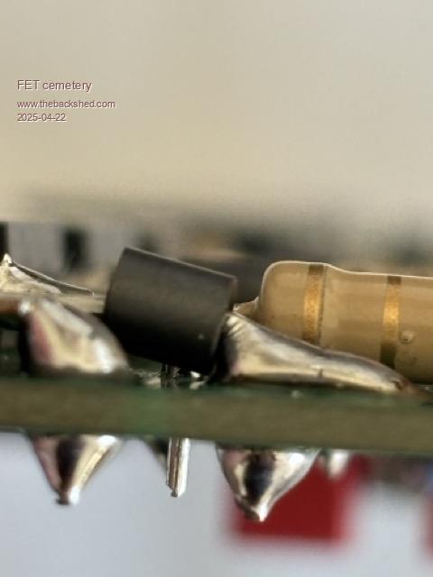

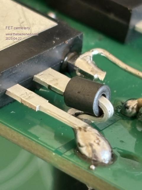

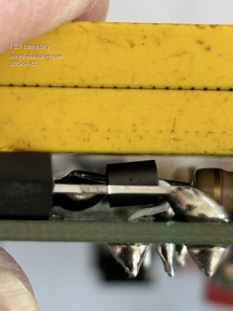

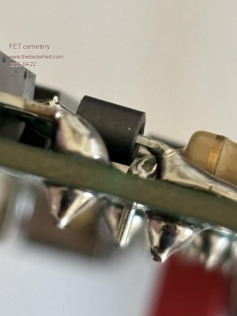

Wiseguy - the beads I used (from an ebay link on either yours or KeepIS's threads late last year) are 4.1mm long, 3.55mm dia. I'm sure that's a nice round number in inches.
I was going to leave them off the +ve fets until I realised how easily they would fit, only downside is that you can't get a soldering iron to the drains on the underside of the board.
The -ve drains have enough clearance I think, might just apply a dab of glue or some tape to stop them rattling around.

A couple of things that I noticed assembling the power boards:
With any of the components soldered to the  big +ve, -ve and output copper planes you have to allow plenty of time for the copper to heat up or the solder won't flow cleanly. I was worried about heat damage to some components, particularly the zeners, but all was good.
Soldering the battery, output and capacitor terminals takes a lot of heat, I used an 80W iron with no temperature control and would consider that to be the bare minimum necessary.
The only mechanical support where the gate resistors are soldered to the fet gates is the solder, ie they're not twisted around the gates or anything (at least not the way I've done it) they're just resting there before being soldered.
Based on what I've heard from a friend who repairs valve radios I would only use a lead based solder here, apparently lead free solder tends to be quite brittle when there's mechanical strain on a joint and prone to failure within a couple of years.

Thanks for the close up pictures, all nice rounded Drain legs no sharp 90 degrees - well done. With regard to the soldering access on the drain bead side I solder them with a normal Hakko hand soldering iron but the solder rarely tracks through to the other side.
Now I apply an ample amount of solder to the solder side and afterwards I use a Hakko hand held solder sucker onto the drain leg and as it reaches the PCB and melts the solder move it up and down a few mm on the leg and then remove.  The solder then is coaxed to track fully through to the other side of the PCB as if by magic, the whole process takes ~ a few seconds.
Maybe a high wattage iron would achieve similar results but if you have access to a solder sucker it works a treat for this purpose.
Not sure of your reason for not using an aluminium bar and I'm not not criticising as you no doubt have a good reason, but if a tap jams or breaks off in the heatsink it is a real problem. If you use 6mm x 25mm bar or 10 x 25, It allows bench testing at relatively high power for short periods and the module removal from a heatsink takes just a few minutes. There is plenty of room for gate resistors and drain clearances etc but granted the whole assembly is a bit taller. Also use of countersunk holes and screws on the aluminium bar to heatsink interface, with the nuts available on the PCB topside means no tapping is required.
Cheers Mike

  FET cemetery said  Wiseguy - the beads I used (from an ebay link on either yours or KeepIS's threads late last year) are 4.1mm long, 3.55mm dia. I'm sure that's a nice round number in inches.
Wiseguy's PCB's are usually very good but I think he had a senior moment when designing the ferrite bead location .
All that was required is to place a 3mm thick board (anything non conducting and capable of taking a little heat) at the *back* of the mosfet, between it and the PCB.
The mosfet leg PCB holes could then be in a straight line (not staggered) if the legs were bent at 90 deg where they reduce in width.
Congrats on making a tricky soldering job doable .

  Murphy's friend said  Wiseguy's PCB's are usually very good but I think he had a senior moment when designing the ferrite bead location
I've had lots of senior moments but it's not relevant here. I did not design a ferrite bead location I wasnt going to use them there. Due to the small improvements with the beads on my Rev1 boards I was going to dispense with them for the high side FETs on Rev2. But when building Rev2 I changed my mind and included any improvement gains.  I also don't feel like spending another huge amount of time redoing the artwork for this minor issue when it already performs just fine.
To get the lowest impedance (widest) ground planes for high current is what led to the staggered pins including cutting off the gate pin.  Having the pins in line degrades this aim.  However I would like to explore your PCB spacer suggestion which may have merit.
Constructive criticism and improvement suggestions are always most welcome & encouraged.
I am guilty of having copied a lot of your ideas with regard to electronics (and those work very well) but having designed PCB's for a living many years ago it does seem to bug me seeing their assembly made more difficult than it could be.
I know the ferrite bead was an afterthought, it's just your fitting of it. Spacing that mosfet up from the PCB lets you bend the drain pin at 90 deg (rounded bend if you think it makes a difference) and easily fit that bead on it.
The staggered pins can easily be avoided by soldering the tail of a solder lug onto the short path to the ground plane.
My power boards have them beside having identical polarity power planes on top *and* bottom of the PCB. That way I can use 1oz boards, even for the 6KW inverter since the tracks combined make 2 oz copper with twice the surface area. Never had any PCB track problems with my 6KW inverter, using just 12 HY5608's.
