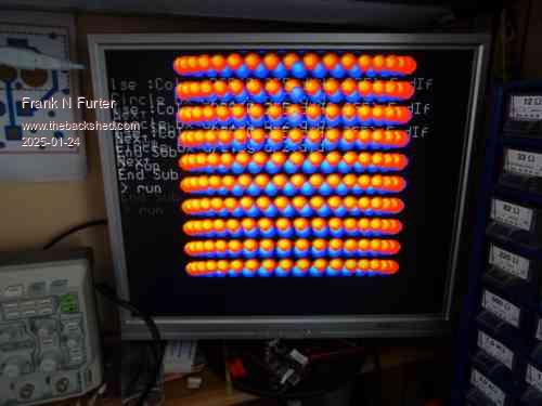

Problems with this program and simultaneous MP3 playback.
(Latest "PicoMiteHDMIUSBV6.00.02b2.uf2" on "Olimex RP2040-PICO-PC" - same problem with older versions)
I am simply thrilled with the MP3 audio output! Crystal clear sound with a little background hum from the switching controller. (Too bad there is no possibility to display the length of the MP3 file or to save the current position )
I played around a bit, as MP3 playback is running in the background.
If I start this program unchanged, the HDMI output is correct:
Mode 2
a=100:b=3:xc=160:yc=120
For n=0 To 9:For i=n To 180 Step 10
t=(i+90)*Pi/180:x=a*Cos(t):y=b*Sin(t):cl=(y<0):ball xc+x,n*20+yc+y-112,cl
Next: For i=170+n To n Step -10
t=(i-90)*Pi/180:x=a*Cos(t):y=b*Sin(t):cl=(y<0):ball xc+x,n*20+yc+y-112,cl
Next:Next
Blit 0,0,0,200,320,20:Blit 0,20,0,0,320,220:FRAMEBUFFER wait
Loop
Sub ball bx,by,cl
For d=6 To 1Step -1
If cl Then :Color RGB(255,255-d*42,0):Else :Color RGB(0,255-d*42,255):EndIf
Circle bx+d/2,by+d/2,d,d
Next
End Sub
...but if I include
PLAY MP3 "B:MyFile.MP3"
at the beginning, I get interference with the image output on the monitor:
What you can't see in the picture: The bottom row of spheres is periodically displayed incorrectly/incompletely and the text scrolls through.. With an additional CLS (which was not necessary before) you can prevent the text output, but not the incorrect display of the bottom row of spheres.
It doesn't matter whether I insert the MP3 call before or after MODE 2.
Is that normal???

I think what is happening is that by writing direct to the screen you are simply running out of bus bandwidth as it is reading it at the same time. By writing to a framebuffer you are separating the read and write areas of memory. Then the copy happens during frame blanking when the display buffer isn't being read.

  Quote  With an additional CLS (which was not necessary before)
Yes it was - try running it twice without changing from mode 2. If you don't clear the screen in mode 2 whatever was on it will get BLITTED along with whatever you are writing. When you run from mode 1 the screen gets cleared automatically by the mode change. Changing to mode 2 when in mode 2 is a NOP
This doesn't change the timing issue though.

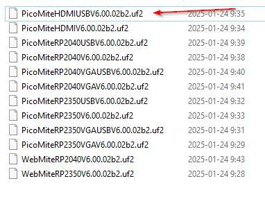

I`m uploading this file. I think it should be the right one:

If You would upload to some online service uncompressed  PicoMiteHDMIUSBV6.00.02b2.uf2  we could eliminate possible archiving problem.

Your program works!
Now and then the display jerks barely noticeably, otherwise everything works now. Thank you!
