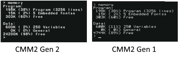

Today's update was a bit more involved than I had expected.
It started off innocently enough. I only hold the local star system in memory, and keep the star systems not being used, on the SD card. So, if you jump from one star system to another, I save the current star system data (about 1 second) and then load the next star system (about another second). This is an unacceptable delay, so I sat down today and re-wrote the save and load routines, and by compacting the data down (i.e. ignoring bits of space with nothing in it) I got it down to 300ms for save and 150ms for load. Much more acceptable.
But this task highlighted something that has been gnawing away at me. I use arrays for everything, and because I'm a C/C# programmer - I use base zero arrays (i.e. the first element in array X is X(0) as opposed to base 1 arrays where the first element would be X(1)).
This is no problem for the CMM2, which is happy with either. However, most BASIC languages only allow base 1 arrays. And if anyone ever want to convert Mascii-Trek to another platform they would have to fix this - and these arrays are everywhere in the code. Of course, I could ignore this problem (this is not my issue) - but I figured that as the program grew, this problem would only get bigger and bigger for the person doing the converting. There's also that nagging feeling that by not taking the time to fix it, I was taking a short cut.
So I took a backup of everything (just in case) and started "fixing" the whole program to work with base 1 arrays. Here we are, 3 hours later - and it's finally done. It seems to work just as it did before, and now I can relax in the knowledge that it's not something that will gnaw away at my conscience anymore. I also set the "OPTION BASE 1" at the start of the program, to make sure I don't slip back into old habits by accident
As an aside, I couldn't work out how to read multiple variables with the INPUT # command. It's not a big deal, as I just ended up putting each variable on a new line - but I'm assuming I'm missing something fundamental. I'll start another thread for it.
Posts: 9328
Posted: 08:27am 16 Feb 2025
Interesting...
All the BASIC versions I've used have defaulted to base zero, I think.
Anyway, taking 2 seconds to fly between star systems seems fairly acceptable. :)
Interesting info on arrays
EDIT - deleted some wrong info. :)
Edited 2025-02-16 18:37 by Mixtel90
PeteCotton
Joined: 13/08/2020
Posts: 669
Posted: 05:23pm 16 Feb 2025
  Mixtel90 said  Interesting...
Ah - after a bit of research, I think you're right. I wonder where I got that idea from? Not to worry - it's ready now.

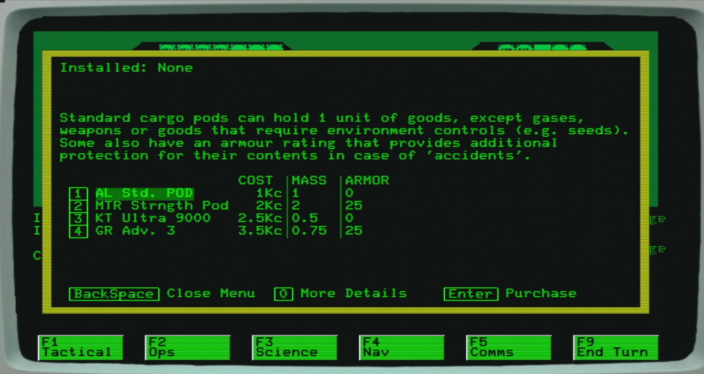

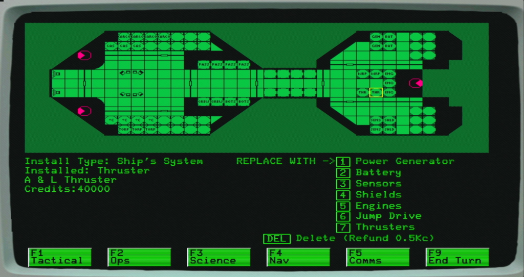

I've been working on the ship upgrades screen. The floorplan of each ship has designated upgrade slots that can be either Cargo (Solid, gas etc.), Ships Systems (Shields, Sensors etc.), Crew (Crew, Passengers and repair bots) or Weapons.
Everything has mass - so the more you pack into your ship, the more power it's going to take to move it.
In the design below, I've just randomly placed everything, but in reality you probably want to split systems up, as I'm going to implement location based damage (i.e. a shot on the port side has much more chance of damaging upgrades installed on the port side of the ship). This adds more strategic choices for the player. Maybe you sacrifice the units on the port side to incoming fire, while repairing the starboard engines to escape away from the fight.
My hope is to usually have multiple choices (and prices) for each upgrade slot, but the availability will vary from planet to planet. To implement this, each planet is assigned a Tech Level (0 - Primitive/uninhabited, 3 - Star Trek Federation Level, 5 - Vorlons sort of tech). Each upgrade is designated a tech level of 1 to 5. Planets will only sell upgrades that are their tech level or 1 tech level below. So a tech Level 3 planet will sell upgrades from the Tech Level 2 and Tech Level 3 pool. This will ensure a rich variety of upgrades for sale, and encourage the player to delve deeper into the system to get upgrades from the higher tech inner worlds.
There is an extra tech level of 6 - this isn't necessarily more advanced than the others but just denotes it's an upgrade that can be discovered, or maybe granted by a quest (no planet will have tech level 6 or 7 - therefore it will never appear for sale).
I could also use this system to provide unique items on certain worlds. For example, if I made a range of products at Tech Level 8, and then set the Synth World to be Tech Level 8 - it wouldn't be that they were more advanced than other planets - just that they would only ever sell their own upgrades (Remember they would only be selling 8 and 7 tech levels - and there's nothing at 7 - so we've just restricted them to their own product range). This could be an interesting story line where you have to befriend the synths in order to get access to their products.
To talk about data structures for a bit, I had a minor quandary when programming this.
- If I store the ships upgrades as a 2 dimensional array of x,y points then it's very very fast for me to access any given upgrade point (when the user puts their cursor over it), but it takes longer when I need to do a check of the ships status (e.g. after the ship has been hit by weapons fire - and some systems damaged - I have to go through all systems, including the empty grid spaces, and see how that effects power output, speed, shields etc.).
- The alternative is just to store a flat array of all of the upgrades (with no spaces for empty grids) - this is very fast when I want to check the ships status, but when the player is moving the cursor around the map I have to search the list for the x,y cordinates, which is much slower.
This is a classic programming problem usually sorted by linked lists etc. However, looking at the memory usage (shown below) even the smaller memory of the Gen 1 has a ridiculous amount of memory space available for variables. So I implemented both arrays (2 dimensional x-y array and 1 dimensional flat array), and keep them in synch.
Now, one of my favourite programming sayings specifically warns against doing this:
  Quote  "A man with one watch always knows the time. A man with two can never be sure"
But by ensuring that additions or removals form the ships inventory go through one and only one procedure, I can safely ensure that both lists always match each other.
Edited 2025-02-26 15:53 by PeteCotton
Posts: 9328
Posted: 08:16am 26 Feb 2025
An interesting alternative to using arrays is to use strings.
a% = PEEK(VARADDR n$) will give you the address of the start of a$
POKE BYTE a%+10, 16  will set the value of the 10th byte to 16
x = PEEK(BYTE a%+10)  will give you the 10th byte of n$)
This is more efficient than arrays as you are dealing in bytes, not 64-bit numbers.
You can also use short integers (16-bit) or words (32-bit). You can even POKE in two bytes and read them back as a SHORT if you wish. So you could POKE in a 64-bit INTEGER yet still access all eight bytes individually later.
You can't print these strings as they will contain control characters and tokens.
The strings can be in an array. Just watch where housekeeping info is stored at the beginning of strings and arrays.
Something like this might be useful for storage compartments, where you can put an item and also flags to carry status information.
Edited 2025-02-26 18:24 by Mixtel90
PeteCotton
Joined: 13/08/2020
Posts: 669
Posted: 04:57pm 26 Feb 2025
  Mixtel90 said  An interesting alternative to using arrays is to use strings.
Thank you Mick. I honestly never knew any of that. I had assumed we were restricted to 64 bit numbers. There are a few places in the code where I am doing single character string manipulation (e.g. reading the 7th character from a string), but I'm using MID$. Using PEEK and POKE will almost certainly be far faster (and feels a lot more old school, I haven't used PEEK/POKE since the 8-bit days).
Interestingly enough, there are parts of the code where I was reliant on the 64-bit numbers. Because they can be so large, I can store multiple pieces of information in one number eg. for a sector of space, I could store the upper 3 digits for the id of a spaceship on a grid, the next 3 digits for a starbase, then next 3 for the id of an object. e.g. Ship 24 on the grid would be 024000000. Starbase 7 on the grid would be 000007000 and so forth. Peeking/poking shorts would have greatly simplified that process (4 shorts to a 64-bit integer).
But ultimately I decided that this would make it hard to convert to 16 bit systems and also didn't really save me enough space to justify the extra complexity - so I went back to a multi-dimensional array.
