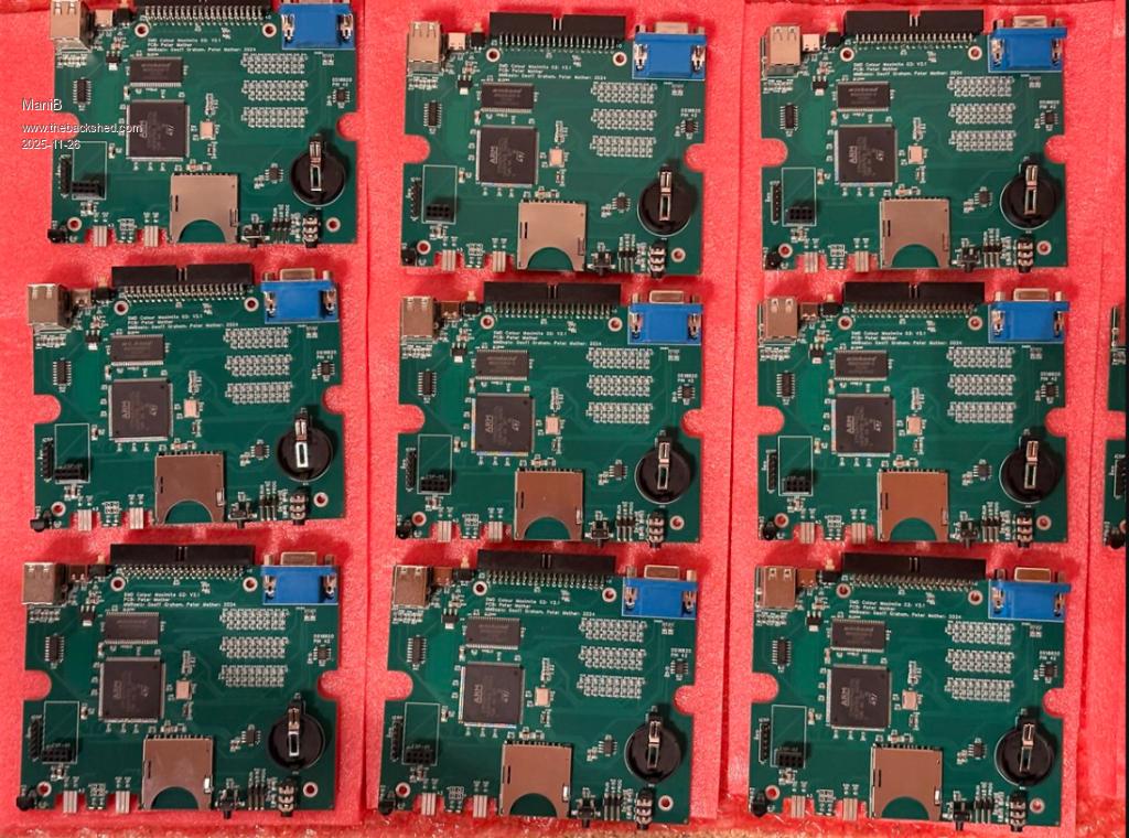

Hello forum members from Germany,
I have received 10 new CMM2G2V2 boards, which I am currently testing and installing in a G738A case with black front and back panels made of PCB with white labels.
I can offer them again for an incredibly low price of EUR 53 (including DHL shipping).

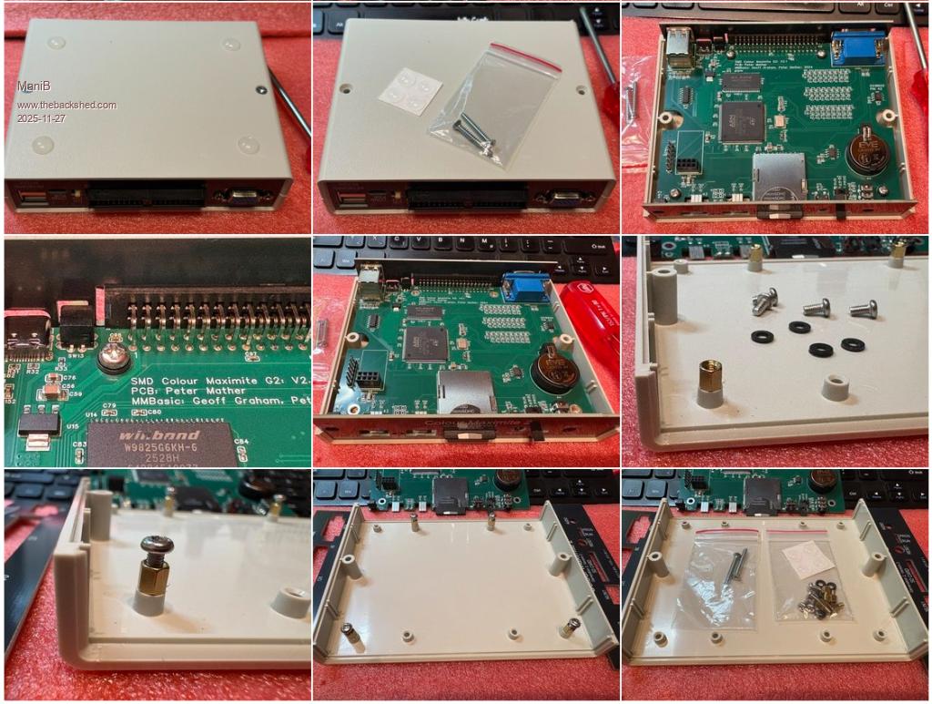

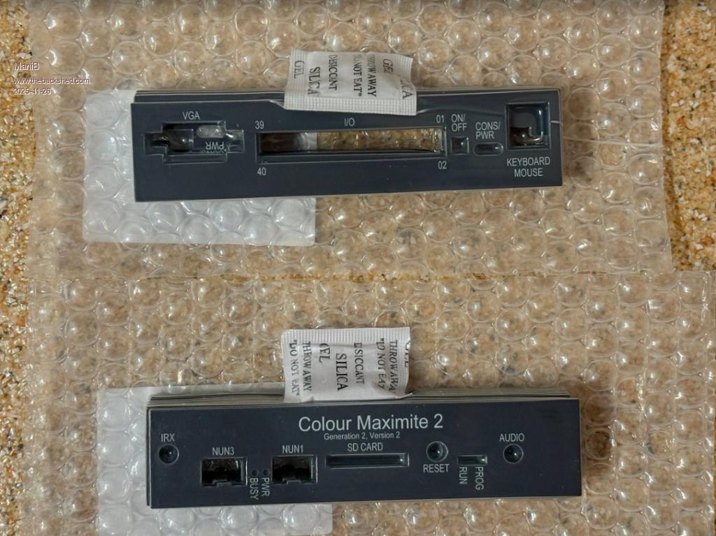

Assembling a CMM2G2V2 is always a great pleasure ;)
10 x CMM2G2V2 circuit boards flashed with the latest version V6.00.00.b8 and functionally tested: No errors!
@homa, you'll get the G738A case together with the necessary screws, spacer bolts, washers, and rubber studs.
Edited 2025-11-27 10:35 by ManiB

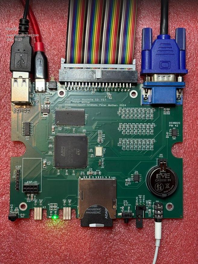

Is there a way to use an STLink with the CMM2 Gen2 V2?
Thanks,
kninja_pi
Posts: 12174
Posted: 06:11pm 21 Dec 2025
Yes, that is what the ICSP header is for. Bottom left in the pic above

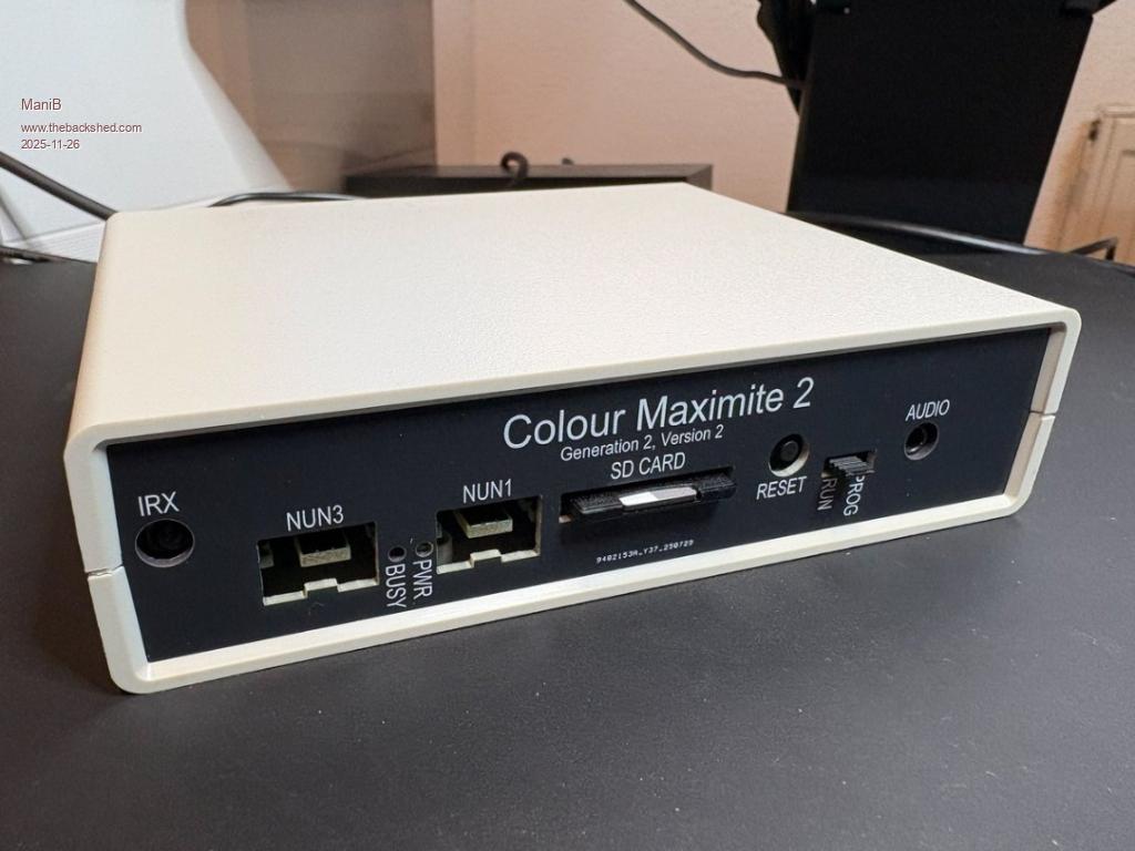

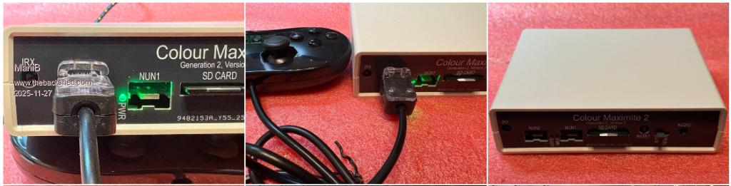

Posted: 10:57am 05 Jan 2026
The front and back panels from ManiB look great, but I'm having problems with the USC-C connector. It makes poor contact because it can't be inserted deeply enough. Are there any Type-C connectors with a longer plug (just the oval metal part)?
Posts: 3429
Posted: 11:16am 05 Jan 2026
Assuming the hole in the back panel is large enough for your plug, check the USB-C socket with a magnifying glass to see if there is debris inside stopping the plug going all the way in.

Posts: 9328
Posted: 08:38am 06 Jan 2026
Is it the thickness of the rear panel that's causing the problem? Not all plugs are happy to lose about 2mm (1.6mm + a gap) for a panel. The easy solution is to open up the hole enough to take the entire plug size rather than just the end. It's usually not by much with those plugs.
I've found in the past that the boxes are designed for a comfortable fit using 1.5mm panel thickness. Taking the copper off PCB material makes it just about right. I tried 1.2mm but the panels are a bit loose, although you can get the main board a bit closer for awkward components.
Posts: 10104
Posted: 01:58am 07 Jan 2026
  richship said
  PilotPirx said  The front and back panels from ManiB look great, but I'm having problems with the USC-C connector. It makes poor contact because it can't be inserted deeply enough. Are there any Type-C connectors with a longer plug (just the oval metal part)?
The CMM2 I bought from Rictech came with a cable with an extra-long connector: about 9mm vs. the regular 7mm.
Yes, I discovered during my initial testing, that the "Standard length" USB-C plugs are not long enough for use with this unit.  As already stated, the panel thickness means the standard USB-C connector only JUST makes contact.  Breath near it, and the connection is lost.
Luckily, USB-C leads with longer "Noses" on them are easy to come by on ebay or AliExpress etc, so no problem there.  I decided to make it part of the package when I send out any CMM2G2, as it is VERY likely, that most people will have bucket-loads of standard USB-C leads, but you can bet they won't have a single long-nose one!
To avoid that causing issues with being able to USE the new toy you just received, I just include a long-nose USB-C lead with every unit now.
