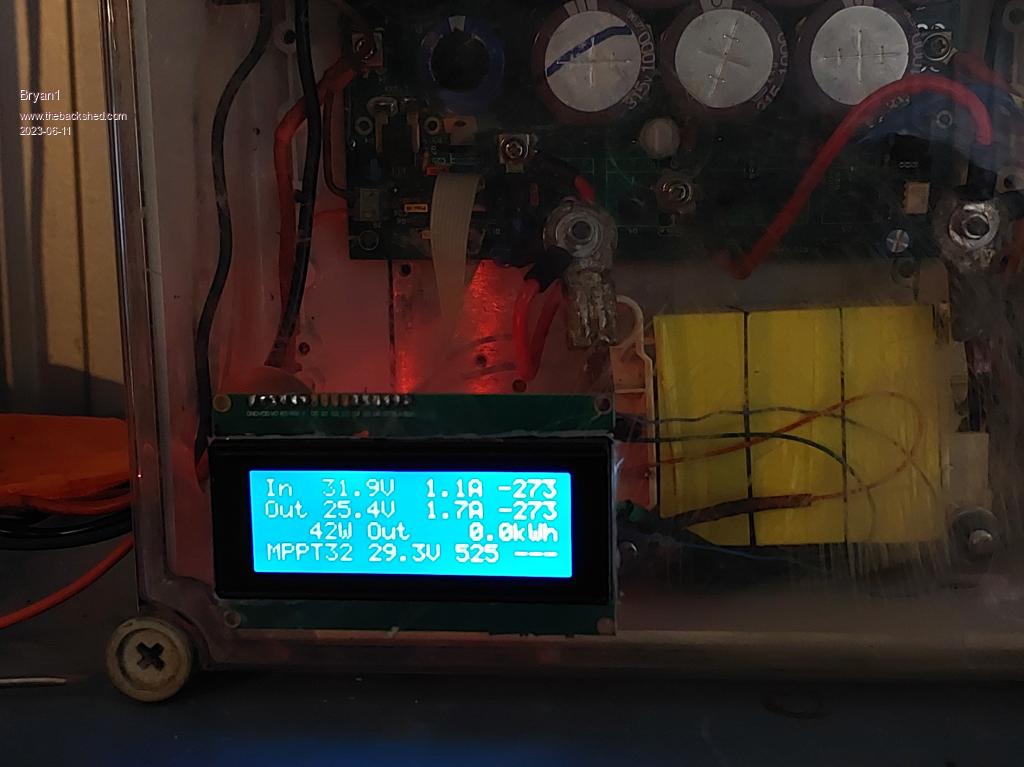

The display you showed above with "MPPT46 29.3V 10 "
means its in mppt mode, 46 seconds into the 60 second cycle where it checks again
for a reason to go into mppt mode and the 10 means the PWM pulse with is 10 cycles wide.
10 cycles is about .62 microsecond and should be easy to see on the oscilloscope

We had a look on the scope at the fet drive chip and saw some low activity then ramp up so the soft start looks like it was working.
We set it up with 2 solar panels and a couple of car batteries in series, calibrated the sensors and the voltages and when a glimpse of sun came it was working
So got home and connected it up
I do need to get a couple of 10K NTC's so the temp is open circuit for now,
So where do the fans connect as no connections appear to be on the board.
Cheers Bryan

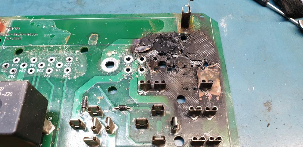

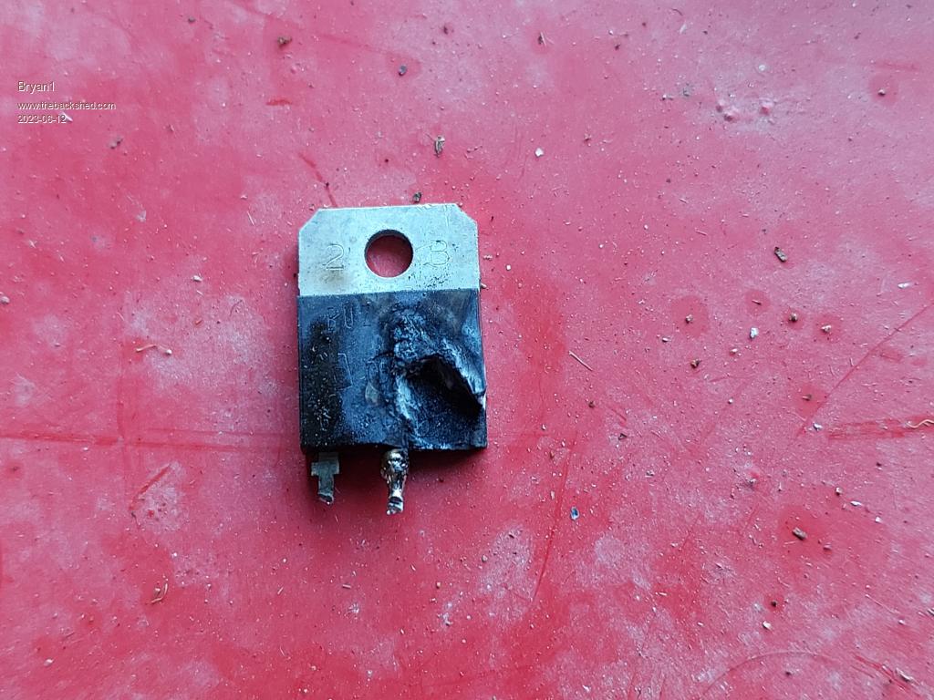

Well guy's started the MTTP up this morning and after the slow start CABOOM number 5 fet put on a nice dying show with red hot patch's and filling the box with smoke.
Now this should get me into the blown fet club
The board is toast so I'll order all new parts for the next build.

Well that's a bit disappointing Bryan, after yesterdays effort I thought you were home and hosed.
What configuration of panels were you using at the time  ...  and did you see what voltages and current were showing before the bang?
And I wouldn't write it off yet either  ...  that damage doesn't look too bad to me, unless the other side is all burned. Give it a bit of a clean with acetone or even metho  ...  most of that black will buff out.
This is a proper burn up  ...  new board $8,000!!!
Cheers,  Roger

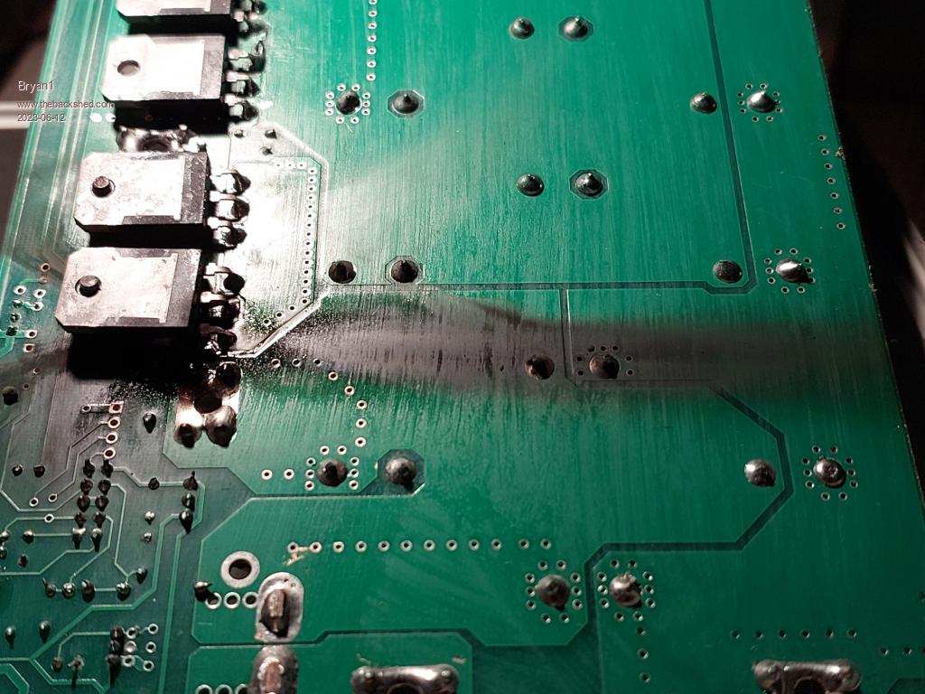

Roger when I turned it on it was only showing 1 amp coming in then it slowly ramped up and when the incoming amps hit 8 amps it went bang, no scoring on the heatsink so it didn't short out on that.
I set it up on my 12 volt array only to find no amps coming in but the mttp was showing on the LCD. Now when I probed that 4.7K resistor under the nano zero volts was shown so I soldered up a new nano and found it was the same no output on that resistor. I did find a TLP250 at my feet so I put that in but still no voltages going or any activity.
So i do think this board is toast as the pads on fet 5 are all stuffed.

Posted: 11:07am 12 Jun 2023
Would have expected the fet next to it to be burnt as well, but it looks untouched why?
something else is going on.

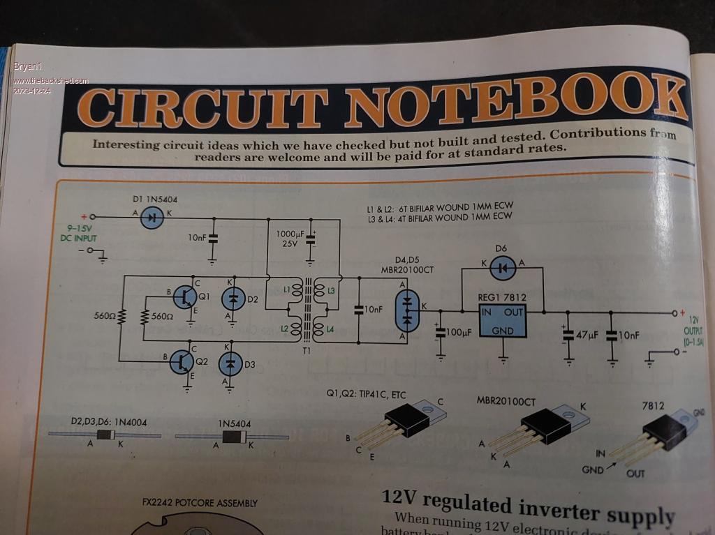

Now I've always thought as we are using low voltage DC there must be away to get the 12 volts we need to power the boards. Sitting in the outhouse reading my old silicon chip mag's I came across this circuit.
Now for me on 24 volts I reckon I could build that keeping the 6 to 4 ratio, now for guy's on 48 volts the ratio must be changed to suit I do think as it's all about keeping that 12 volt regulator within the spec's. Tomorrow I'll bread board this up using BC337 tranny's and I did find a dual diode chip as the donor chip as the rectifier. Now the input will be taken from the battery side I can't see any issues but eh I'm a hardware type of guy and just love working with copper.

Bryan, it would be way cheaper to use a commercial DC/DC buck converter for this job.
I'm using one, they are small, reliable and there are hundreds to choose from.
That article is possible many years old, when those modular DC/DC converters were not thought of yet.
Posts: 3421
Posted: 10:25am 24 Dec 2023
That circuit is a Boost Converter, the secondary volts are added to the input.  The input to the 7812 will be about 60% higher than the supply.
If you want 12V just use the 7812. Better still is the above suggestion. Much more efficient.

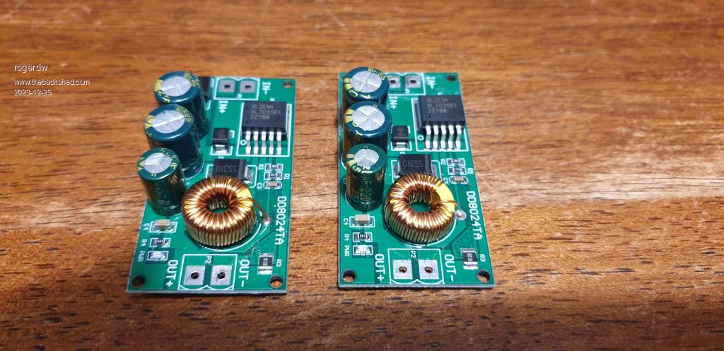

Hi Bryan, I'm with Klaus and Phil  ...  it would be much easier to use one of the cheapie DC-DC converters.
I can help you out  ...  I have a couple spare ones here you can have  ...  1A High-Voltage DC-DC Converter DC 10-80V to 12V
You should still have my number, otherwise send me a pm.
Merry Christmas.
Cheers,  Roger

A slight modification to the secondary winding of that circuit would make it fully isolated from the primary and suitable for high side FET driving.
