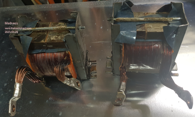

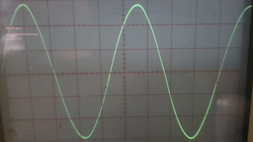

Here is the cause of my problems.
With both of these fitted the inverter works fine just as an inverter making AC power. They might look small but they weigh about 10KG each. The GTIs don't like them, with 2 smaller chokes I get this sine wave.
This is with just one GTI connected back feeding 500W with no AC loads. The offending chokes are made with 2 of the large aerosharp choke cores joined together and 12 turns of 31 1.6 diameter wire. My inductor meter may be wrong but it shows 80mH.
The chokes that are working are 2 of the small aerosharp chokes joined together with 6.5 turns. I can't run it hard with these as the wire in them is only about 10mm square.
The next step is to remove the windings from the 2 big chokes and try different numbers of turns of temporary wire. When I find what works I wind them again with enamel wire, it will be a lot fewer turns so I will be able to get a much larger wire cross-section.
This is the Nano 1 code used if anyone wants to try it.  It is the same as the file Poida upload just with this line u = 32000.0 * sin(t);  changed from 20000 to 32000. If you are not wanting to back feed then you are best to stay with the Nano 1 versions Poida.

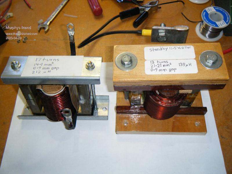

If its any help, the choke on the right is what I'm using in my dual stack nano inverter:
Posted: 08:15am 29 Apr 2023
It would be interesting to see how your inverter goes back feeding with the code above.
What is the core of the choke you are using?

Large aerosharp choke x 2 made into an E core.
Murphy's friend
Joined: 04/10/2019
Posts: 678
Posted: 01:39pm 29 Apr 2023
  KeepIS said  I might be having a seniors moment so ignore me if not relevant, but the choke values appear to be a tad high to me.
Easily changed by fitting a bigger gap spacer.
Actually, that inverter is in pieces at the moment so I will try your suggestion.
Choke function has been - is- mostly a mystery to me so I'm still experimenting. What I did find was that ferrite core chokes did not do well at all in my opto isolated nano inverters.

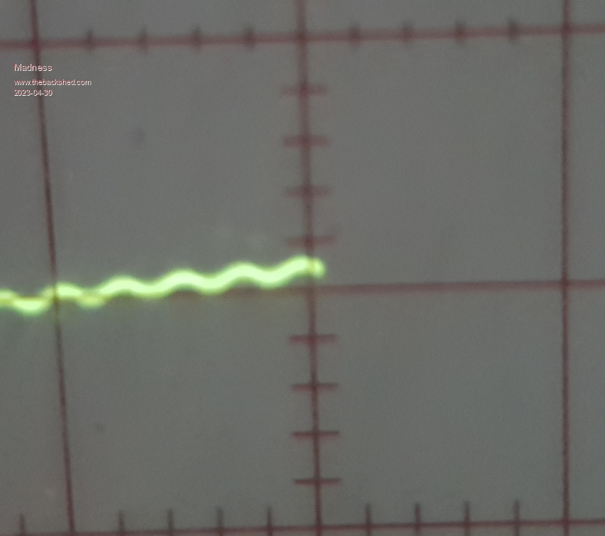

Posted: 12:05am 30 Apr 2023
@nickskethisniks If it is vaguely on topic then post away.
@KeeoIS You are not off-topic, I did establish yesterday and posted that there is too much inductance, so discussing inductance is very much on topic.
@Mab1 Over the past few months I have done a lot of reading on here before building this new inverter to get myself back up to speed as it has been around 5 years since I built any inverters. I was under the impression from what I read that the higher value inductor you have the better, clearly that is not the case.

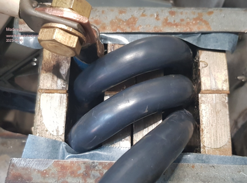

What I have done is remove the windings from the choke cores. This was quite easy as the windings were wound onto a close-fitting 3D-printed former. I had some 95mm square battery cables on hand that I have wound on the cores with 3 turns on to the double large Aerosharp cores. My meter says 0.01mH, so my previous post should have been 0.08mH.
I have 2 of these one on each side of the toroid primary. This is working right now with 2KW back-feeding and no load on the inverter. It is running with a near perfect sine wave. There is no sign of any glitching, disconnections or any other gremlins.
The inverter is run near silent, I don't have any filters on the AC out. There is a very slight trace of the 20khz switching that I will ignore.
I will let it run for most of the day and if all is well I will reassemble the inverter properly and then I can test it under full back-feeding load. ATM I am thinking I have succeeded in what I set out to do here, which is to get a Nanoverter back-feeding successfully.
Edited 2023-04-30 10:08 by Madness

Posted: 02:28am 30 Apr 2023
The inverter that has been running my house for the last 6.5 years has the original Oztules Ferrite choke which is a lot lower value. The actual value of the chokes I am using now may be quite different to what's shown on the meter I have used due to its dubious accuracy. The MOSFETs seem to handle that year in and year out running 24/7/365/6.5. This inverter can run at 8kw for at least 30 minutes and does work everyday. It is not unusual to see it making 6kw for extended periods every day when my wife is cooking. Quite often the oven and induction cooktop and air fryer are running plus the house water pump starts and stops every time a tap is turned on. During the day the same inverter spends many hours back feeding 5-6kw from GTIs.
While I appreciate your input, is the tiny bit of ripple really an issue? Based on the experience I have had and the fact that I need the back feeding to work I won't be aiming to put more henries in the chokes unless I see smoke come out.
As for grunt at startup, this inverter is so quiet you would need to put your ear on the case to hear it at start up and it has got a very big toroid. It scares me a little that is so quiet I don't know it is running. The toroid is so heavy I could only just lift it, if it had another core I would literally need a block and tackle to lift it. Just before I saw it back feeding 2.5kw, there is a small hum like you get from large grid transformers but it can barely be heard. My old inverter buzzes and makes all sorts of noises from the choke, I can tell just from the sound what is running.
It has been running perfectly for about 4 hours now, the toroid is up to 28 degrees and the heatsink has got to 41. I connected a fan that is set to start at 41 and stop at 39. It comes on about every 15 minutes for a couple minutes. I am very happy with how it is running.

Posted: 06:10am 30 Apr 2023

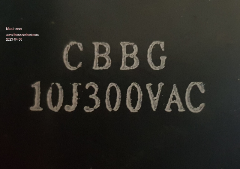

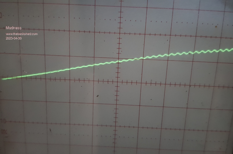

Yes, there are 2 chokes and I have 2 aerosharp 10J300300VAC capacitors across the toroid secondary. My meter says 4.6uF each and they are in parallel. I checked the resonance and it is was around 78hz with the previous chokes fitted.
The 20khz ripple is less than 5V, the transformer is 1:9 so this would be under 0.5 volt on the primary. Each line is 50V.
I checked old faithful and the ripple was a bit more than double this, it has filters on the output and as mentioned this new inverter has no filters at all.
Edited 2023-04-30 18:25 by Madness

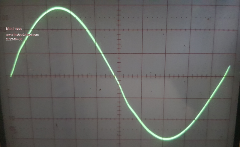

I have reassembled my inverter with the new choke configuration after running most of the day very successfully with the power board outside the inverter and the chokes half in and half out like it had been disembowelled. I will switch the house and GTIs over to it first thing in the morning and see if it runs as well as it did today.
Tomorrow I will see how it goes with loads but I am very happy with the wave-form as it is, Klaus it would be well worth giving the code from here a try. You can load it onto another Nano and just swap the Nano with the one you have installed now. Then you can easily change back anytime if want to. From my experience it might be well worthwhile taking a look at your chokes too.
