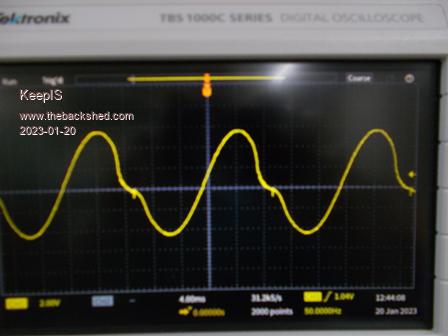

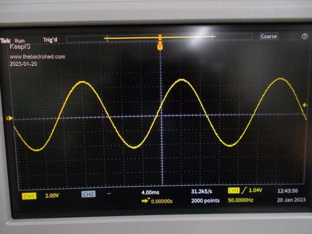

I decided to look a little further at the effect of these crap Heat Guns on Low.
This was after finding that a big UPS (CHASEPOWER) that I use for the computers causes a slight flat top on the AC output?? When it's only supplying 200 watts to the PC's. It does not seem to cause any problems, and it's not headroom a the Inverter will run the Heat Gun @ 1.5kW and the waveform is as clean as a whistle.

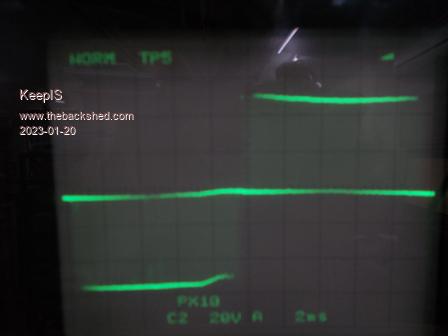

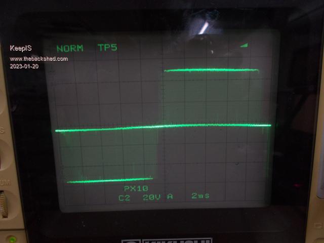

Here is what it does to the AC, and the HI/LO drive to the transformer [before the choke].
Before I started, I grabbed two Black ring toriods, thanks to wiseguy for telling me they were almost the same as the blue ones, so I added two to the other 6 and got the 51uH value I was looking for, this makes the output of the choke a lot cleaner and the waveforms are even better with the Heat gun.
But if I use the E-core for more inductance, it's not as good, even with the E-Core on it's own. I really need to look more into this with bad loads - or not
The Heat gun draws about 800W on Low and causes the choke winding [57A cable] and the primary windings, same cable, to get quite warm very quickly.
Running at 1.5kw on High for 10 minutes only causes a slight warming of the 57A cable, the choke cores are cold and the secondary of the transformer appears to be cool. But 800 Watts from that crap waveform really heated up the 57A winding very quickly.
So 51uH choke, heat gun high @ 1.5kW
HI/LO drive to transformer.
800W of crap from Low Heat gun setting.  Sorry for poor focus, dam camera.
The HI/LO drive is not quite as bad as I thought, but there is concern there if the CRO got this correctly.

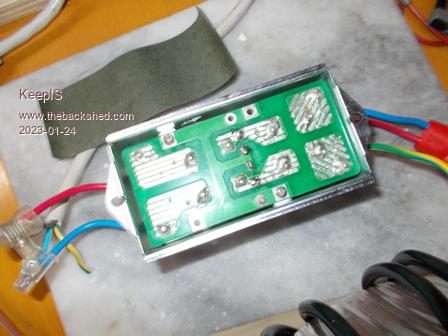

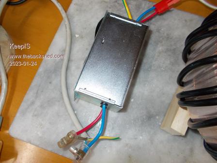

I have not been using an AC output filter in bench testing. I have two 7A mains filters from the aerosharp (I think) and an EMI filter also from the 3kW Aerosharp, looks like it's from the mains in?
Very thick wire with dual stage toriods, 0.22uF across the AC in, 2 x 0.01uf to ground between the input and output toriods, and 0.47uF across the AC out.
I wanted to see how much difference this made to the part rectified waveform produced by the crap Heat Gun on Low.
First I tried one of the sealed 7A mains filters and it made some difference.
DC input current on the crap waveform went from 19.5A to 17.8A and the waveform on the CRO was better, the Primary waveform had far less ringing envelope around the large kink in the sinewave
I then tried the big dual filter, the DC current went down to 14A and the waveforms looked even better, it's a waveform I could live with.
The Heat gun is rated @ 240V 1.6kW / 800 Watt and I'm running it on 220V. The crap waveform is caused by a Diode in series with the heating element for low power.
DC input no filter:
1.5 kW on High
1000 Watts on Low
It's supposed to be half power on low.
With the Filter:
1.5 kW on High
753 Watts on Low.
So the filter removed 250 watts of heat from the Inverter driving the Heat gun on low. Current draw is almost normal.
