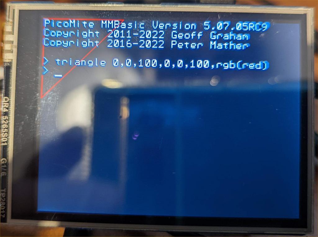

stanleyella
Joined: 25/06/2022
Posts: 2807
Posted: 01:27pm 08 Nov 2022
  Martin H. said
  stanleyella said  non vga mmb does not have a triangle function.
since you have already used the Maze program on your NonVGA Pico, your statement cannot be correct.
Here the triangle function was used to draw the walls.
Your code did not "run" on lcd but as you say the errors were not triangle commands.
Triangle is not mentioned under drawing commands in the non vga manual but is there in the list of commands, page 118.
Lcd is not the same as vga but some games could work but adapting to touch control?
I was thinking of android phone games.
I do not want to wire buttons to control a lcd game if touch could be used instead.
The touch lcd is well implemented and when calibrated is accurate.
I will try to adapt vga to lcd but it is fun using lcd graphics with mmbasic.

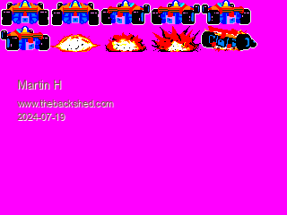

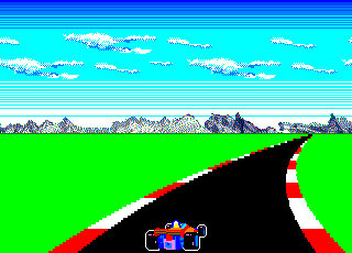

You barely wait 2 years and there is already progress here too
I have adapted the example to the new sprite routines so that the tires are no longer transparent.
Sprites used in the Demo
I also halved the vertical resolution of the road and reduced the frame rate to 25, so there is still about 1/3 CPU time left, which could be used to calculate the controls of the game.
For the track, I also tried to recreate the route from Fuji Speedway.
RoadAgain.zip
this Version is for Picomite VGA MMBasic 5.07, I will test it on Game*Mite later

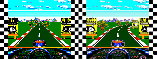

As I described in another thread , performance was significantly improved by replacing the BOX commands with BLIT RESIZE
This should make it perfectly possible to show up road signs and objects at the side of the road without losing speed. I’ve drawn a little something to illustrate this.
I've already designed a few important RGB121 signs instead of traditional billboards
At the moment, I’m trying to figure out how to make signs that are closer move faster than those that are further away. Well, I’ve got time over the Easter holidays to find that out
Martin
Edited 2026-04-03 19:03 by Martin H.
