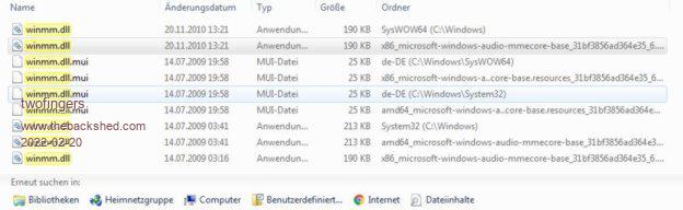

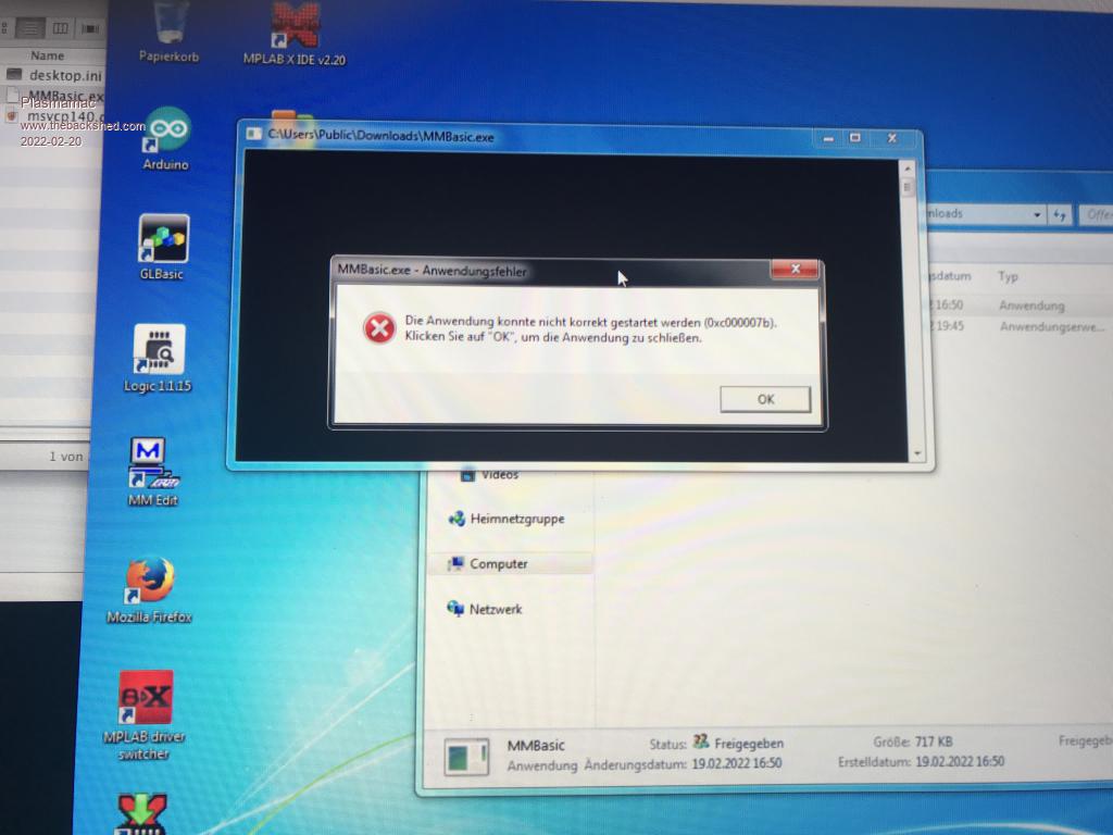

  matherp said  Has anyone got the latest version running on W7? I'm not aware of using anything W10+ specific but all my machines are on W10/W11 so no way of testing the out-of-date non-supported W7
V5.07.03a3 crashes on two PCs. Both on which I've tried it.

  Quote  V5.07.03a3 crashes on two PCs. Both on which I've tried it.
Both W7?
Do you have swap space properly set up? How much RAM?

The big change in the latest release is sound. This uses a windows library winmm.dll. If you goggle this it is a known issue on W7 and there are solutions for getting it and where to put it
Hmm ...
At least Winmm.dll is present.

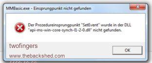

  matherp said  OK so it is definitely sound and winmm related. I'll leave you to see if you can get it working. The app is W32 so it is the 32 bit version of winmm.dll you need to be in the right place.
I downloaded winmm.dll (32bit),winmmbase.dll and api-ms-win-core-libraryloader-l1-2-0.dll and I still get an error message. I think it's easier to move on with WIN10.
