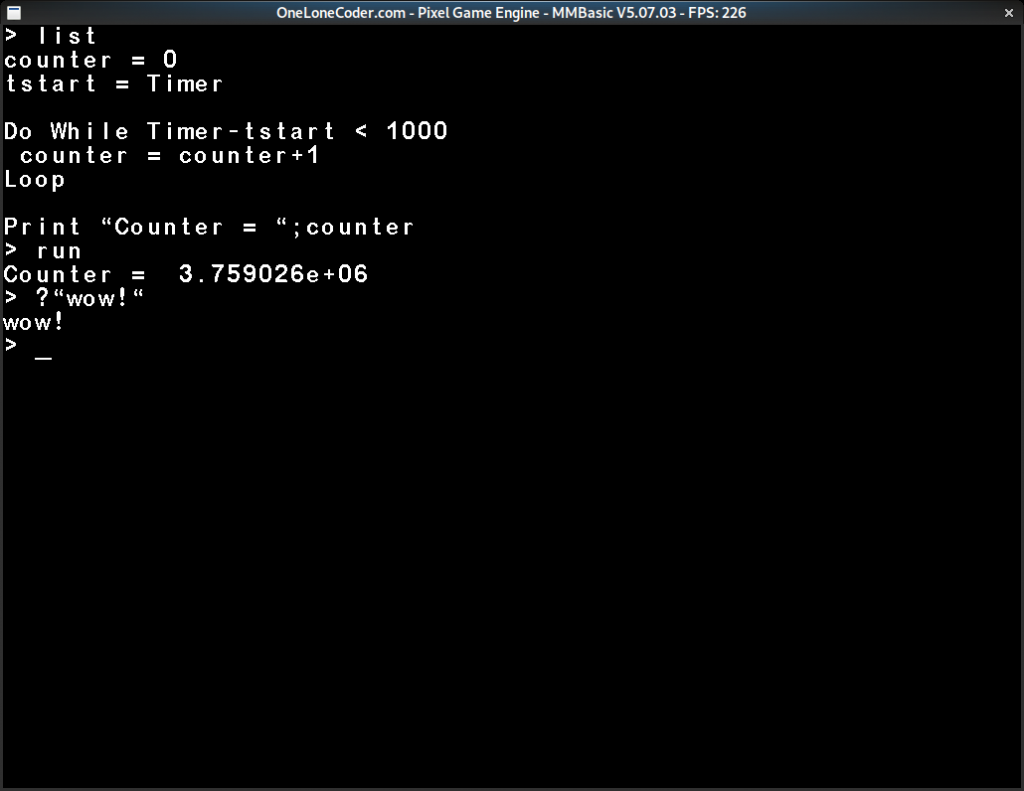

MMBasic under "wine" on a debian "buster": 3.7 mio loops in a second!
-andreas

@Andreas
226 Fps ? What your specs and is this the gui release version?
Plasma
andreas
Joined: 07/12/2020
Posts: 226
Posted: 01:12pm 27 Jan 2022
  Plasmamac said  @Andreas

no it was the non-gui version.

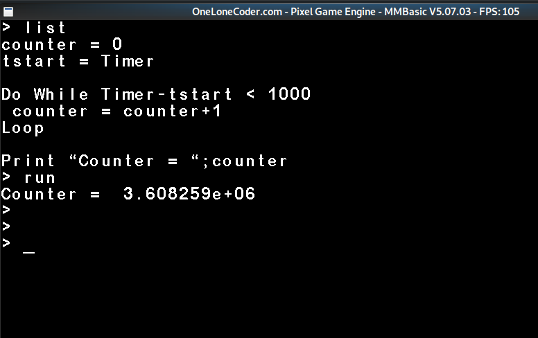

Posted: 01:19pm 27 Jan 2022
this are the results with the gui version: FPS 105 but loop with 3.6 mio/s
-andreas
Tinine
Joined: 30/03/2016
Posts: 1646
Posted: 01:56pm 27 Jan 2022
  andreas said  this are the results with the gui version: FPS 105 but loop with 3.6 mio/s
-andreas
Well more than that, actually because you are doing the Timer - tstart for every loop.

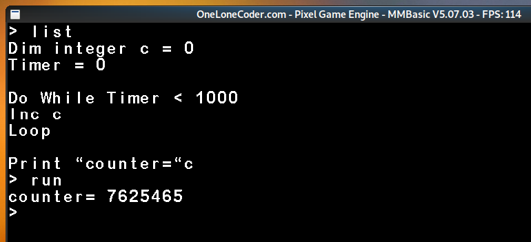

twofingers
Joined: 02/06/2014
Posts: 1785
Posted: 02:17pm 27 Jan 2022
  Tinine said  Well more than that, actually because you are doing the Timer - tstart for every loop.
Yes!
Dim integer counter = 0
Timer = 0
Do While Timer < 1000
Inc counter
Loop
Print "counter="counter
BTW: FPS: 17 (4*3 GHz)
even faster:
Dim integer c = 0
Timer = 0
Inc c
Loop
Print "counter="c

Tinine
Joined: 30/03/2016
Posts: 1646
Posted: 04:49pm 27 Jan 2022
Yes!
Timer = 0
Inc counter
Loop
even faster:
Dim integer c = 0
Timer = 0
Inc c
Loop
Print "counter="c
I might be thinking of another processor but I found a lot of the time was attributed to the Do/Loop and therefore I pasted hundreds of lines within the loop to get a better idea of in-line code execution time.

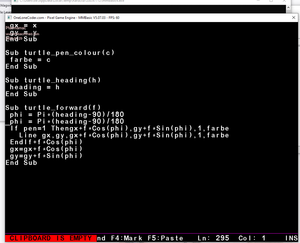

Plasmamac
Joined: 31/01/2019
Posts: 620
Posted: 05:48pm 28 Jan 2022
Hi ,
trying the turtle code from andreas gives me an error in line 296
then type edit
press enter
the line show double  but clipboard is empty
hope it help
Edited 2022-01-29 03:49 by Plasmamac
Plasma
andreas
Joined: 07/12/2020
Posts: 226
Posted: 05:52pm 28 Jan 2022
  Plasmamac said  Hi ,
then type edit
press enter
hope it help
The original code should be:
sub turtle_forward (f)
 phi = pi*(heading-90)/180
 if pen=1 then
   line gx,gy,gx+f*cos(phi),gy+f*sin(phi),1,farbe
 end if
 gx=gx+f*cos(phi)
 gy=gy+f*sin(phi)
end sub
possibly an transfer error...
-andreas
andreas
Joined: 07/12/2020
Posts: 226
Posted: 07:02pm 28 Jan 2022
I get the same error as Plasmamac when using pa2 version. Nikolaus runs using pa1.
-andreas
