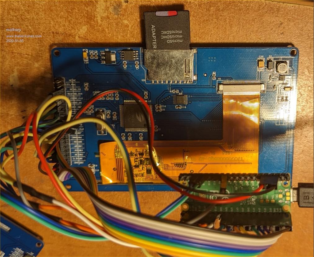

Just playing
Grogster, fancy doing an adapter?

What are we looking at, is this some sort of parallel display panel ?
Posts: 9329
Posted: 06:24pm 04 Jan 2022
It is, yeah. I got one some time ago to go with my F4 (but still never got the two connected together as it involves some serious cross connecting when you put them back-to-back)! It's a pot-boiler project.

That would be cool with a surface-mount PicoMite with a female header that just plugs straight onto the back of the display. :)  Even nicer if there's still an I2C port to do some expansion with.

Yippie SSD1963 on the Picomite... or not?
PicoMite MMBasic Version 5.07.03RC7
> option LCDPANEL SSD1963_5, LANDSCAPE
Error : Invalid display type
Aaaargh how can I get my hands on that version?

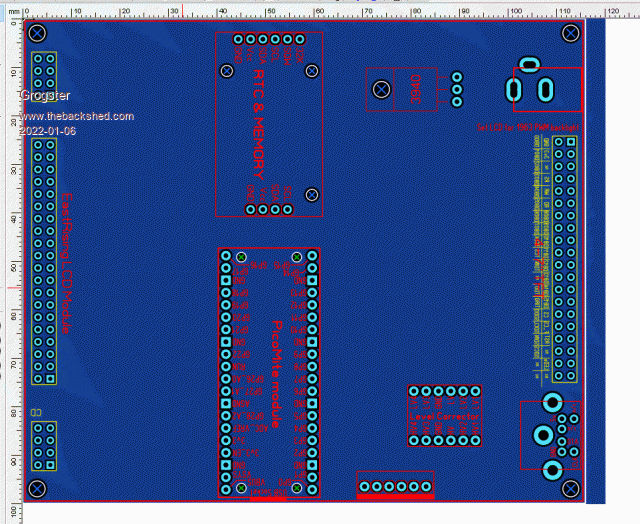

Sure.  Send me the schematic or post it here, and I can whip one up.
Are there any pins left on the Pico after connecting a parallel LCD and touch?
Posts: 3430
Posted: 04:22am 05 Jan 2022
"Are there any pins left on the Pico after connecting a parallel LCD and touch?"
Looking at Peter's photo just a handful, If a keyboard and RTC are added it's about full.
Posts: 9329
Posted: 07:23am 05 Jan 2022
You only need 4 pins. Two for a keyboard, two for an I2c. An external I2C DAC would be fine if you want analogues, or a 28-pin Micromite for mixed IO. RTC can go on the same I2C bus.
There are I2C keyboard designs around, in which case you only need two pins. :)
Or use a "soft" on-screen keyboard, of course.

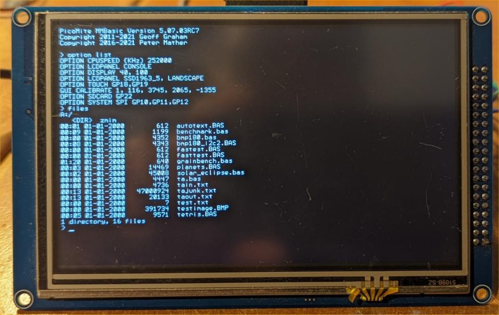

Posted: 09:05am 05 Jan 2022
PicoMite/PicoMiteVGA
V5.07.03RC8
Enables F1 as a user programmable function key
Fixes bug in cursor positioning in editor
Fixes bug in error message when an invalid flash page is selected
Implements support for SSD1963 parallel displays
Check the video
SSD1963_4, SSD1963_5, SSD1963_5A, SSD1963_7, SSD1963_7A, SSD1963_8
OPTION LCDPANEL SSD1963_n, orientation
NB: SSD1963_8 also supports the 9" Eastrising display
It is assumed the SSD1963 is configured for 1963_PWM backlight control in which case the BACKLIGHT command will work as expected
Pin connections are as follows:
DB0 pin 1:GP0
DB0 pin 2:GP1
DB0 pin 4:GP2
DB0 pin 5:GP3
DB0 pin 6:GP4
DB0 pin 7:GP5
DB0 pin 9:GP6
DB0 pin 10:GP7
RS  pin 17:GP13
WR  pin 19:GP14
RD  pin 20:GP15
RESET pin 21:GP16
SSD displays support RGB666 and are much faster than SPI displays. The firmware includes full support for console mode.
The downside is the number of pins used.
A typical configuration could be:
GP0-GP7 SSD1983
GP8-GP9 PS2 Keyboard
GP10-GP12 SPI for touch and SDcard
GP13-GP16 SSD1963
GP18-GP19 Touch CS and IRQ
GP22  SD CS
Leaving:
GP17 I2C_SCL/COM1_RX/PWM0B
GP20 I2C_SDA/COM2_TX/PWM2A
GP21 I2C_SCL/COM2_RX/PWM2B
GP26 ADC0/SPI2_CLK/I2C2_SDA/PWM5A
GP27 ADC1/SPI2_OUT/I2C2_SCL/PWM5B
GP28 ADC2/SPI2_IN/I2C_SDA/COM1_TX/PWM6A
Notes for Grogster:
The 4.3" display works fine using the Pico 3.3V supply
The 7" display and bigger work using VUSB to provide the 5V assuming the USB supply is good enough
The 5" display does not work reliably with the Pico 3.3V supply and would need an external 3.3V
An adapter that supported both the normal 40-pin connection and the Eastrising variant would be great
I haven't included defined pinout for RTC but would suggest GP20,21
I haven't included defined pinout for audio but would suggest GP26,GP27 but only as an option
Keyboard connection would need a suitable level conversion ZVNL110A works perfectly as a cheap widely available MOSFET (RS 751-5278)

This is what I have so far - just doing the major component placement at this stage:
PM down the bottom of the board to give easy access to its USB socket.
ER connector at left side, standard 4-7" TFT connector at right(both on bottom)
3940 1A LDO 3v3 regulator to power both types of screen.(won't use the PM 3v3 output)
Four-channel 5v/3v3 bi-directional level corrector(two channels for keyboard, the other two for COM1)
Standard RTC module.
Six-way PCB header for the six pins left over after all the tracks are laid.
I plan to squeeze this layout a bit more horizontally, to make it 100x100.
Once complete, I will certainly release all gerbers and drill data files etc.
I think I will start a new thread for this board, so as to not hijack this one.
