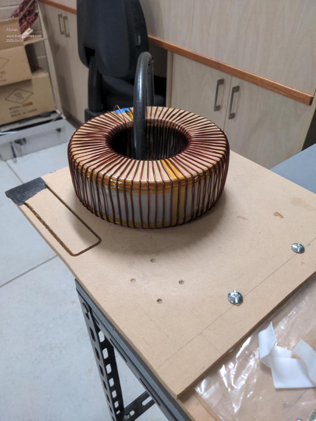

4 primary layers wound and just marked the secondaries out and ready to start winding.

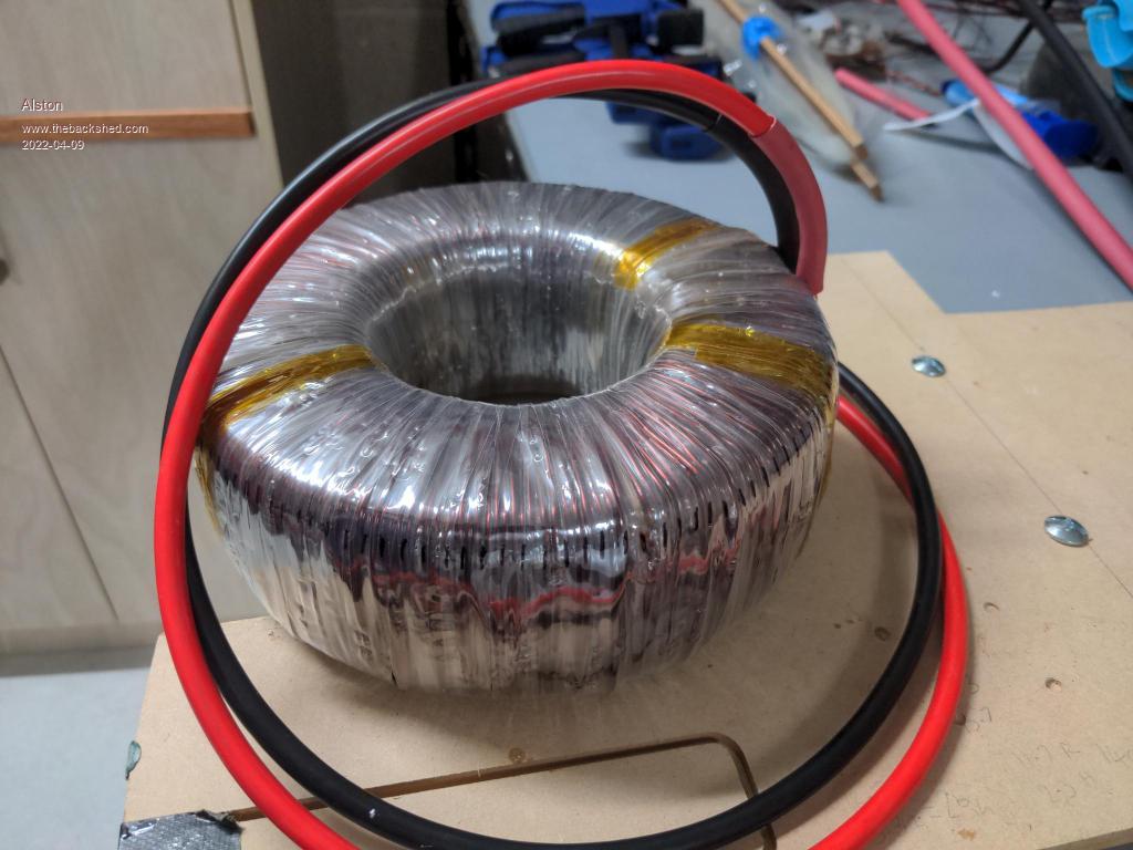

Roger this is my second biggest transformer, it has 69 primary turns and I used 1.8mm (4 layers) wire recycled from an Aerosharp. The core is from an SMA Sunny Boy that you can see me hacking out of it's potting in another thread.

Posted: 03:38pm 15 Apr 2022
  Alston said  Roger this is my second biggest transformer, it has 69 primary turns and I used 1.8mm (4 layers) wire recycled from an Aerosharp. The core is from an SMA Sunny Boy that you can see me hacking out of it's potting in another thread.
Thanks Alston, that makes sense. It's hard to gauge an accurate size just from a photo  ...  unless there's a reference that makes it more obvious.
My large transformer is 270mm in diameter and 175mm tall  ... without the primary wound on it yet  ...  which doesn't sound all that large  ...  but when you see it sitting there it looks massive. And when you go to shift it, you really get an idea of its mass. Something like 46kg so far!!!

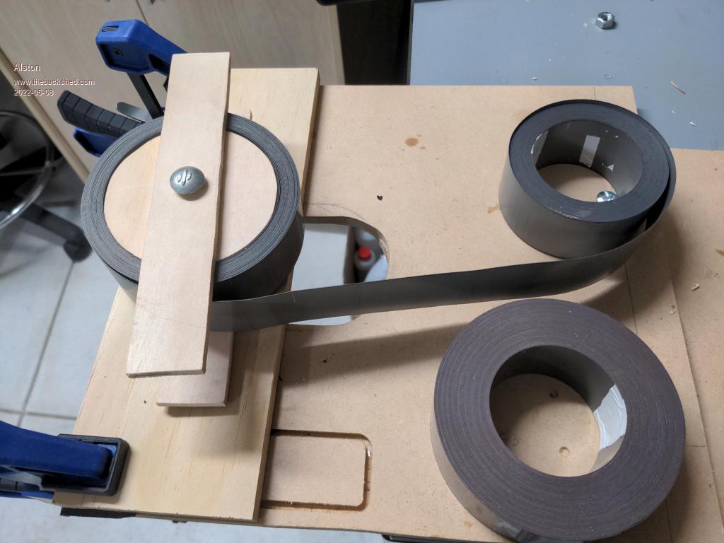

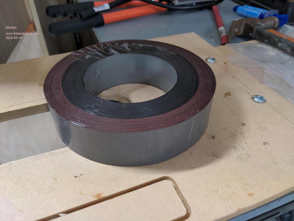

Transformer 3 is all complete and I have started on TX 2. I could not find a suitable core so I am winding one from some smaller ones I had. Here is a photo of my very crude setup that seems to be working well. I didn't go to the effort of spot welding them and instead used epoxy. By the time the endcaps are epoxied on I figured it will be pretty well all glues together.

I would advise the same Paul as you seem to use no tensioning method as you wind. Place some temporary fencing wire around the outside to hold the end in place, warm the core a bit (40-50 deg) so the epoxy soaks down into any lamination gap before you epoxy your endplates on.
They wind those laminations on with a fair bit of tension in the factory.
Alston
Joined: 04/04/2021
Posts: 63
Posted: 01:41pm 09 May 2022
I tried a few techniques to tension it but without a lathe or similar I would never be able to get it as tight as they were originally wound. I actually found that I could get it tight enough by hand until it would not longer slip and only the last bit wound would loosen. Thanks for the tip Klaus, I used a hot air gun and heated it up and then poured the epoxy on which seemed to soak in. This process looks to have worked really well!

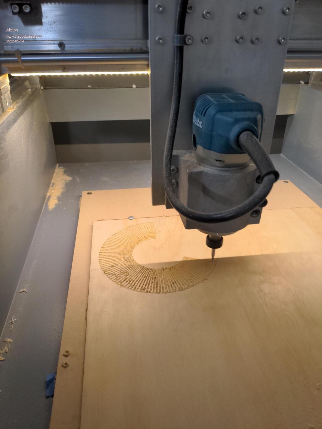

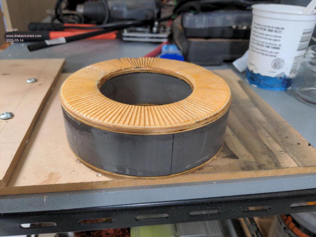

Posted: 05:14am 14 May 2022
I have completed winding the core and making the end caps on the CNC. I CNC them a bit oversized, epoxy them on and once dry use a trimmer router with a flush trim bit to get them to exact before running the round over bit on them. With the smaller divisions on this transformer I had a  bit of blow out near the edges but that doesn't really matter. For scale this core is OD:165mm ID:90mm and H:40mm (without endcaps)
