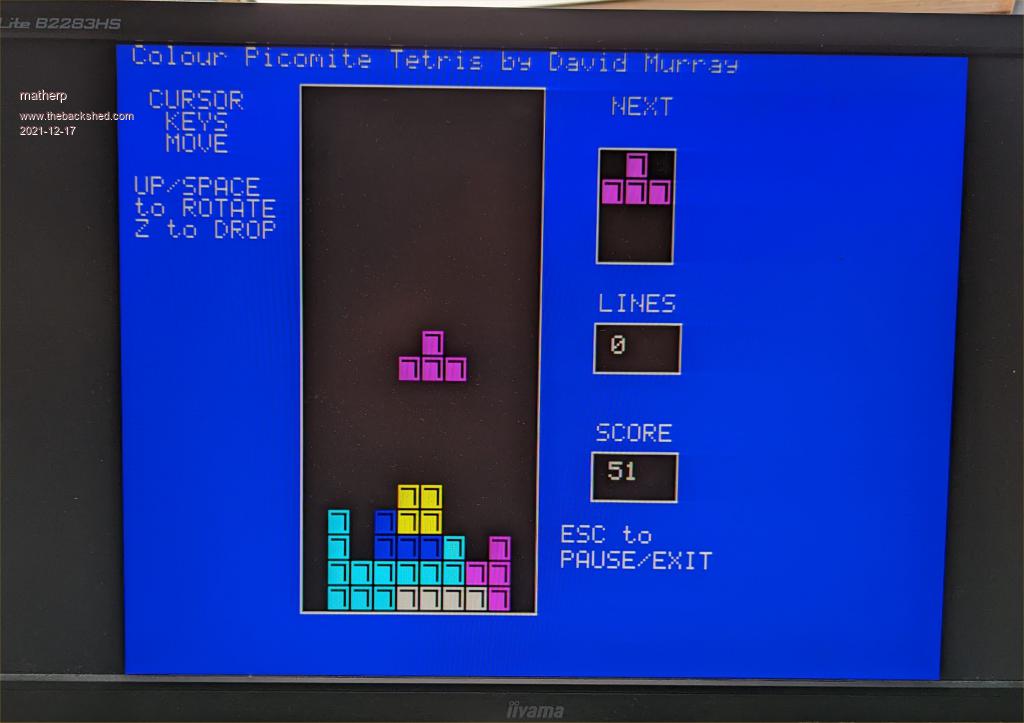

Posted: 12:46pm 17 Dec 2021
PicoMiteVGAV5.07.01b4.zip
Fixes a bug in writing to the colour screen with black text
Just for fun I added some small level of original Colour Maximite graphics compatibility like the CMM2
Available in the PRINT statement is the @ function for locating the cursor (see CMM2 manual)
OPTION LEGACY ON/OFF is a temporary option to be used in a program. It affects the following commands
COLOUR - uses colours 0-7, see original colour Maximite manual
PIXEL - see original colour Maximite manual
LINE - see original colour Maximite manual
CIRCLE - see original colour Maximite manual
To prove compatibility here is David Murray's Tetris implementation running with no changes on the PicoMite VGA edition

   Print @(80,15,1) "QUITING? ARE "
   Print @(78,25,1) "YOU SURE Y/N?"
   Colour 7
   Return
 EndIf
 GoTo END1
  Quote  Does the variables hash table speed up execution much?
Program dependent but for anything with over say 20 variables it starts to make a big difference. Originally developed for the CMM2
Edited 2021-12-18 00:24 by matherp
