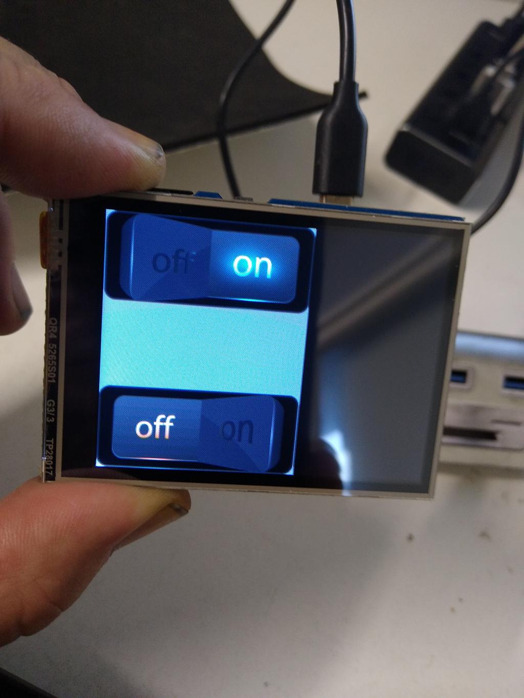

Posted: 02:17pm 08 Nov 2021
Many thanks, guys. I was side-tracked and only got back to this today.
Now the display, touch and SD card are all working
Isn't this fun?
Once again, Geoff and Pete....many, many thanks for such awesome products
One thing that threw me was with TS calibration. I calibrated right after setting the config option and it was a mile off. Only after I cycled the power (or possibly hit the RESET button at the top of the display), did the TS calibrate properly.

Posted: 02:39pm 08 Nov 2021
A quick test:

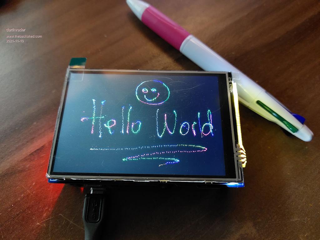

Hi ,
I get the waveshare pico dev board with the 3.5" screen
Screen and touch is working fine but it don't detect the sdcard , is it something special to do for this ?
I actually used the Matherp option from a previous post.
OPTION SDCARD GP22
OPTION SYSTEM SPI GP10,GP11,GP12
OPTION LCDPANEL ILI9488W, LANDSCAPE,GP8,GP15,GP9,GP13
OPTION TOUCH GP16,GP17
GUI CALIBRATE 0, 3946, 211, -1287, 853
Posts: 9329
Posted: 07:49pm 09 Nov 2021
You have to use the GP pins for that model of display, I'm not sure which post you are referring to.
darthvader
Joined: 31/01/2020
Posts: 105
Posted: 01:17pm 10 Nov 2021
Hi
My board is this one : Pico eval board
As i see in the user guide ,the hardware connection to the sdcard is not SPI but 4 bit SDIO , the GP22 is the CS like it have to be but if the firmware use SPI instead , it's probably what cause my trouble
Cheers.

darthvader
Joined: 31/01/2020
Posts: 105
Posted: 06:21pm 15 Nov 2021
Thank you matherp
It's working now
So the full config is :
OPTION SDCARD GP22, GP5, GP18, GP19
