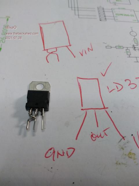

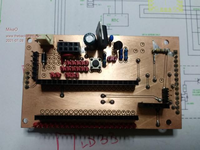

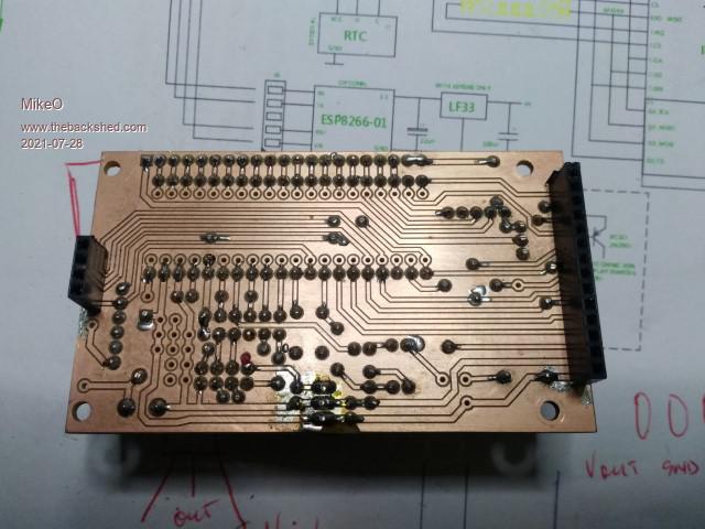

Milled version of the board has been loaded with components, initial testing found a couple if problems.
The circuit pin outs for the linear reg is not correct, the Vout and Gnd are swapped. I
jury rigged the regulator and to continue testing. All good except there is no electrical connection between the 3.3v and pin 3v3 on the PicoMite. I made a wire link on the board which energised all the 3.3v supplies on the PCB. So all is looking good, I will do testing with he Pico and the display tomorrow. Mike

The 3.3v regulator is only for the ESP module. Nothing else uses it so if you aren't using that it can be omitted, together with the capacitors.

  MikeO said  I jury rigged the regulator and to continue testing. All good except there is no electrical connection between the 3.3v and pin 3v3 on the PicoMite. I made a wire link on the board which energised all the 3.3v supplies on the PCB.
  Mixtel90 said  The 3.3v regulator is only for the ESP module. Nothing else uses it so if you aren't using that it can be omitted, together with the capacitors.
So further to that, as designed, the components other than the ESP will only have 3V3 if the Pico is plugged in and its usb port is also plugged in.

Correct. The ESP can draw up to 400mA on startup and 300mA over a slightly longer time, settling down to about 80mA depending on mode. That might be a bit much for the 3v3 output from the PicoMite, so I used a 500mA LDO to get a second 3v3 supply from the 5v rail. I could probably have used a smaller one but the LF33 is cheap enough. LF33 Regulator
Having the supply contact quite close means that (if you aren't using the ESP), with a couple of links you can ground 3V3EN to turn off the SMPS and link to the linear reg's output to the 3V3 rail to get a quiet supply.
The LF33 is wired correctly on the PCB design, although an early drawing shows it with the tab on the left. It should be on the right. In-Gnd-Out when looking from the "front" of the reg. The outermost rail on the pcb is +5 and the next one in is Gnd.

Oh,thanks for putting me right everyone, I had spent so much time in the isolation milling exercise and (obviously) no where near enough on the subtleties of the Raspberry Pico design! Also unfortunately the LD33v low dropout I had in stock I had ASSumed to be a similar device, wrong, different pin out.
Bad Day.. Mike

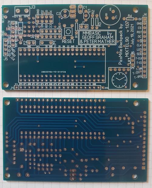

PCBs have arrived!
I'll populate one soon and give it a test. Probably when the British Standard Weather (i.e. rain) returns.

Nice, thank you. I used 47R for R4.
Learned the hard way that if the RTC is mounted on the same side as the Pico, then it needs to be oriented so that the silk-screen clock is visible, not covered. Scratch one hot RTC module.

I'll make a note about the RTC in the doc for the board. I'll own up - I messed up at the design stage. I tried all sorts of ways to get the RTC onboard.
I've got a board running now too. Yep, I had fun calibrating the display too but it works eventually.
GUI CALIBRATE 0, 3897, 3757, -897, -673
LCDPANEL option RL puts the SD card at the top & USB socket on the RHS.
The distance between the display and backpack is intended to be 11mm as that's a standard length for metal spacers. It will depend on the connectors used though and sometimes 12mm spacers might be better.
