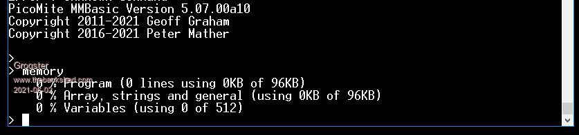

Posted: 10:18am 02 Jun 2021
a12
PicomiteV5.07.00a12.zip
MEMORY should now work
analogue input available on pins GP26,GP27, and GP28 (setpin n,ain)
This is based on the setting of temporary OPTION VCC which defaults to 3.3V
? PIN(TEMP) to read the die temperature of the chip
FLASH ERASE ALL is useful for new releases
