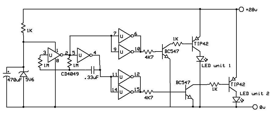

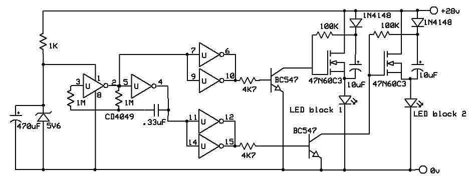

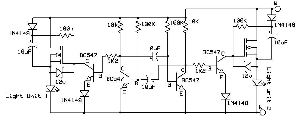

Posted: 05:53am 26 Jun 2021
Well, it was a very quiet day at work Friday, so a rummage through the crap I have in the 'Might be useful' draw produced two circuit boards with just about the right bits to try on version of the flashing light. This is the discrete astable driving a high side switching N-Chanel FET. Totally the wrong device, but it was all I had.
Here it is working, all be it with only one lamp driver attached. The more astute will have noted the polarity of the astable caps are drawn reversed, but they were put together correctly.
The FET has an Rds ON of 1.2ohms. Not ideal. The load is a 1amp light, with the FET only getting to, at a guess, 25degC.
Saturday here was wet which was perfect shed weather. The next two variants are more practical, especially with the component count. This simple bipolar flasher shows a CE voltage drop of 0.39v with again a 1amp light.
The oscillator was meant to be a CD4069, but the three I have are somewhere safe. They will turn up when I'm looking for something else no doubt   . So the chip is a 4049, which for this purpose is near enough. Here it is merrily doing its thing.
And the last is what I was aiming for, high side N-chanel switching. Again with a 1amp light. FET's are from a dead UPS, with a 70mOhm Rds ON. Voltage drop across them was .08v with the 1amp load.
Hope one of these will suit your requirements Bob.
Pete'.

No sweat . Yes I saw your videos Mike . I decided to make up Pete's third circuit in Eagle . Didn't have any trouble with it . The circuit seems to work as I need it to do . I just decided ,yes that will do the job especially as the shorting to the Mosfet showed I can connect my LED spotlight there .
I decided to go straight to the circuit board and get some made for my first experience of that .

Posted: 02:29pm 29 Jun 2021
  bob.steel said  No sweat . Yes I saw your videos Mike . I decided to make up Pete's third circuit in Eagle .
The two zeners shown in Petes first schematic should also be included on the third schematic (between the source and gate of the FETs) - I do accept that they appear to be working ok currently with incandescent lamps.
Anywhere from 12V - 18V zeners are suitable. The capacitors could get to almost the supply voltage and a lot of FETs are only specd to 20V Max G-S.  The zeners also ensure the caps have a good charging path before using their charge to fully turn on the gates.
The LED loads will probably behave very differently to the incandescent loads (if  zeners are not fitted) as the incandescent lamps actually help to charge the electrolytic capacitors due to their low resistance nature.
