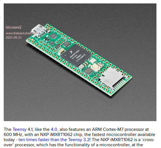

hitsware2
Joined: 03/08/2019
Posts: 738
Posted: 08:44pm 30 May 2021
Not a Pico ,
but has SD ....
my site
