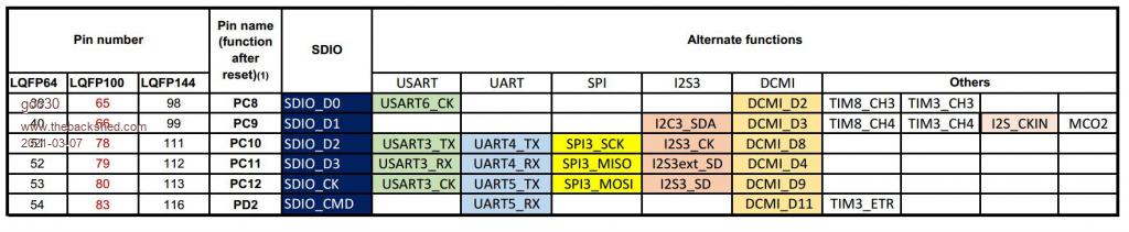

The ArmmiteF4 uses SDIO rather than SPI to drive the SDcard and doesn't use CD
What cards are you using? the SD works perfectly on both the cards pictured in this thread

On your old src files, you use also GPIO, not spi and in "Files" function, you call "initSDCard" to know if card is present
Edited 2021-03-06 20:46 by goc30
Posted: 10:53am 06 Mar 2021
  Quote  On your old src files, you use also GPIO, not spi (your I/O named "Cd" -Card detect)
Not sure what you are referring to. The old code had lots of conditional compilation and irrelevant code as it supported H7, F7, and F4. The new code only supports F4 and I've stripped out all irrelevant code. SDIO doesn't use CD and that code is no longer there

VET6 as show in first post work with 8gb. My mistake is in use an 1gb and an old 4gb
and also with BT1 pin
  TassyJim said  I have the STM32F4VE board fitted with the STM32F407VET6 CPU and fitted with the 3.2in display as pictured in the first post of this thread.
The SD card works as always.
Using a 8GB card.
thank Jim. I remove jumper betwen BT1 and 3.3v and after that it work.
but ...
my second card with F407VGT6 don't want to read cards. In this card, BT1 is internal, no pin. May be problem come from this ?
