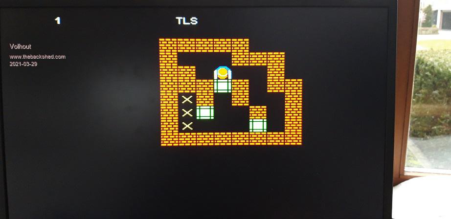

Ok, one day of bad weather, wife out the door, a last moment release for the TLS (Ten Line Sokoban) entry.
I am still within the boundaries for the challenge (100 characters, 48 lines).
This is 37 lines of 80 characters. I had to improve the sprites a bit. Using 14x14 now versus 9x9.
s=11:z=15:Dim f(s,s),t(s,s),v$(16):GoSub 1:Sprite Load"x.s":Do:Mode 4:Read x,y
For i=1To s:Read a$:l=Val("&h"+a$):For j=1To s:f(i,j)=3And l:t(i,j)=(f(i,j)=1)
l=l\4:Next j,i:Cls:Print w,,"TLS":f(x,y)=4:Do:d=0:For i=1To s:For j=1To s:k=f(i,j)
o=120+z*(i-6):p=99+z*(j-6):Sprite paste Int(k+1+((k=4)*n)),o,p:d=d+(k=1):Next j,i
If d+q=0Then:w=w+1:Exit:EndIf:Data 9,2,FFC,3003,3003,30C3:Do:a$=Inkey$
Loop While a$="":n=3And Asc(a$):c=(n<2)*(n*2-1):b=(n>1)*(n*2-5):e=x+b:g=y+c
If f(e,g)=3Then:b=0:c=0:ElseIf f(e,g)=2Then:If f(e+b,g+c)<2Then:f(e,g)=t(e,g)
f(e+b,g+c)=2:Else:b=0:c=0:EndIf:EndIf:f(x,y)=t(x,y):x=x+b:y=y+c:f(x,y)=4:q=t(x,y)
If a$="r"Then:Exit:EndIf:Data FC0,,FFC,3217,3203,3003,FFC,5,2,,,,FFFF,D5F3,CBC3
Loop:Restore:For i=1To(s+2)*w:Read a$:Next i:Loop:Data C023,C3CF,EC0C,C0FC,FFC0
Data 8,5,,,,FC0,DC0,CFF,FE87,D83F,FFB0,370,3F0,6,3,,,3FF,3FF03,30FA3,30083,303FF
Data 3F300,C3F0,C570,FFF0,5,4,,,,FF0,C30,E3F,3DA3,3163,3163,3F03,3FF,7,7,,,,FF00
Data C3F0,C03F,CE07,C897,C87F,C3F0,FF00,6,6,,,3FF,3FC3,3C23,3CE3,3163,317F,32F0
Data 30C0,3FC0,9,7,,,,,FFFF,C017,C897,FABB,C897,C017,FFFF,7,6,,,FFFF,D503,D1B3
Data CB03,C23F,F30C,328C,3F0C,3FC,7,6,,,,3FF0,303F,3053,3373,32B3,3C23,C0F,FFC
Data 8,2,,,,FF0,C3F,FC03,C273,CE23,C44F,FF0C,3FC,6,2,,,,,FFFF,C303,C0B3,DA13
Data CDEF,C10C,FFFC,2,3,FFC,3FC0C,30C8C,300BF,37F23,37203,3703F,37230,37F30
Data 30030,3FFF0,6,3,,,,3FFFC,321DC,32FCF,31323,377C3,32043,31FFF,3FC00,10,7,,FF
Data 3FFCC3,300FE3,339003,331FEF,339C0C,3C1CEC,3F100C,30FFC,3FC00,5,10,,,3FFFC0
Data 3005C0,33F5FF,303003,32B0C3,3E3FCF,32000C,303F0C,3FF3FC,5,3,3FC0,30FF,F023
Data C2C3,CC8F,C0BC,FF0C,F0C,D0C,D5C,FFC,3,8,FFFFC,C3C0C,C008C,C0F0F,FC8C3,C803
Data FC3F,3570,3030,30F0,3FC0,9,7,,,,3FFF,3003,3333,3003,FF3F,C2A3,C153,FFFF
Data 10,10,3FF003,3333FF,303003,0,3FF3FF,8030,3FF3FF,0,3FF3FF,307333,FC303
1 Open"x.s"For output As#1:Print#1,"16,8":Do:Read a$:Loop Until a$="s"
For i=1To 8:For j=1To 14:Read a$:b=Len(a$):v$(j)="":If b=1Then:v$(j)=v$(Val(a$))
Else:For k=1To b Step 2:n=Val("&h"+Mid$(a$,k,1)):r$=Mid$(a$,k+1,1):For l=1To n
v$(j)=v$(j)+r$:Next l,k:EndIf:Print#1,v$(j)+"  ":Next j:Print#1,Spc(16)
Print#1,Spc(16):Next i:Close#1:Restore:Return:Data s,E0,1,1,1,1,1,1,1,1,1,1,1,1
Data 1,E0,1,1,3016601630,4016401640,5016201650,602660,7,6,5,4,1,1,1,2210821022
Data 1,E0,1,1,1,1,1,1,1,1,3,1,1,4410441044,1,E0,14104410441024,4,3,1,1,3,4,4,3
Data 1,1,2730443027,2720642027,2710841027,27102445241027,271014154415141027
Data 27111564151127,2711841127,7,7,10171184111710,1031643110,2031443120,308130
Data 406140,406140,308130,2031443120,1031643110,10171184111710,2711841127,6,6
Data 27111564151127,271014154415141027,27102445241027,2710841027,2720642027
Data 2730443027,9750,A71130,507120,203415443110,1034156431,34158421,6,6,6,5,4,3
Data 2,1,5097,3011A7,207150,103144153420,3164153410,21841534,6,6,6,5,4,3,2,1
Game task: move the green boxes onto the yellow crosses.
You (the Mario type guy) can only push the boxes, not pull.
Typing lower case "r" reloads the current level.
There are 20 levels. The level is shown in the left top corner.
Mario is controlled using cursor keys
A picture of the game play...
Edited 2021-03-29 03:49 by Volhout

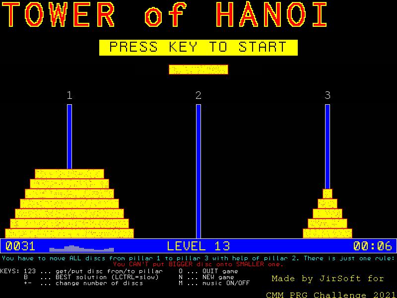

here is my "piece of gold" - Tower of Hanoi. I worked on it all the weekend, but it still can't be compared to Mauro's or Vegipete's work
OPTION DEFAULT INTEGER:X1=135:X2=395:X3=655:cr=&hFFF0000:cy=&hFFFFF00:cw=&hFFFFFFF:tp=-1:frq=196
du$="112211112211112211221122111122111122112211221111112112211111121122111111211221111112":y3=799
mu$="ihfhiklkhifhefdbedabihfhiklkhifhefdbedabklmimlkiopmklmkpomlkhiklmimlkiopmklmkpomlkhi":ps=0
hz$="196,220,247,262,294,330,349,392,440,494,523,587,659,698,784,880,988":rr=250:xc=400:yc=300:n=13
DIM jt$(6)=(" Made by JirSoft for  ","CMM PRG Challenge 2021","Max. 48x100 characters","","","","")
jt$(3)="Very simple game, but ":jt$(4)=" I learned new things ":jt$(5)="  and it was FUN...   "
cb=RGB(NOTBLACK):cc=&hF0000FF:DIM d$(2):ke$="123qnb+-m":f$="emmmquxhlr":v=-1:j=1:SETTICK rr,z,1
y=480:w=100:MODE 1:TEXT 400,2,"TOWER of HANOI","CT",5,2,cy:BLIT 2,2,2,0,796,64,,4:y1=271:y2=599
BLIT 2,2,2,4,798,64,,4:BLIT 2,2,0,2,798,64,,4:BLIT 2,2,4,2,798,64,,4:PAGE WRITE 1:c$="0000":CLS
TEXT 400,2,"TOWER of HANOI","CT",5,2,cr:PAGE WRITE 0:BLIT 0,0,0,0,800,600,1,4:tn=0:SETTICK 100,tm,2
COLOUR RGB(CYAN):?@(4,y+34)"You have to move ALL discs from pillar 1 to pillar 3 with help of ";
?"pillar 2. There is just one rule:":COLOUR cr:?@(228)"You CAN'T put BIGGER disc onto SMALLER one."
COLOUR cw:?@(0,540)"KEYS: 123 ... get/put disc from/to pillar";:?@(360)"Q ... QUIT game":?@(48);
?"B   ... BEST solution (LCTRL=slow)";:BOX 0,y,800,30,1,cw,cc:f1=1:f2=3:?@(360)"N ... NEW game"
?@(48)"+-  ... change number of discs";:?@(360)"M ... music ON/OFF";:y4=210:p5=500:u:x:n=1:u:pt=0
DO:fk=INSTR(ke$,LCASE$(INKEY$)):fn$=MID$(f$,fk+1,1):CALL fn$:LOOP:SUB e:END SUB:SUB wk
DO WHILE INKEY$="":LOOP:END SUB:SUB h:INC n,n<13:u:END SUB:SUB tm:INC ti,tn:t2=(ti\10) MOD 60:
BLIT 98,y+2,100,y+2,200,27:j1=(frq-196)/31:jd:IF ti>10 THEN rn=rn AND (KEYDOWN(0)=0)
LINE 100,y+27-j1,100,y+27,1,cw:PIXEL 100,y+27,cc:t1=ti\600:BLIT 0,0,y3,0,1,66:BLIT 1,0,0,0,y3,66
IF tp<>t2 THEN TEXT 791,y+4,STR$(t1,2,0,"0")+":"+STR$(t2,2,0,"0"),"RT",1,2,cy,cc:tp=t2
END SUB:SUB q:qq:BOX 218,265,364,70,0,cc,cc:tx " Have a nice life ","  with your CMM2  ":wk:END
END SUB:SUB r:rr=250-rr:frq=196:SETTICK rr,z,1:END SUB:SUB l:INC n,-(n>1):u:END SUB
SUB rt:BOX 0,80,800,50,0,cb,cb:END SUB:SUB m:IF v THEN p(fk-1) ELSE IF d$(fk-1)<>"" THEN g(fk-1)
tn=1:t:END SUB:SUB ds(px,py,ww,cc):IF cc THEN BOX px,py,ww,20,1,cb,cb:EXIT SUB
BOX px,py,ww,20,1,cr,cy:FOR ix=2 TO ww-3:FOR iy=2 TO 17 STEP 3:IF RND>.9 THEN PIXEL px+ix,py+iy,cr
NEXT:NEXT:END SUB:SUB x:u:tn=1:TEXT 400,80," PRESS KEY TO START ","CT",4,2,cb,cy:rn=1:a n,0,2,1:
IF rn=0 THEN rt:u:EXIT SUB
tn=0:wk:h:u:END SUB:SUB a(nn,s,dd,hh):IF rn*nn=1 THEN g(s):pp:p(dd):pp:EXIT SUB
jt$(6)="Music by JBmusics.com ":IF rn THEN a nn-1,s,hh,dd:g(s):pp:p(dd):pp:a nn-1,hh,dd,s
END SUB:SUB g(i):v=ASC(LEFT$(d$(i),1))-48:o=LEN(d$(i)):xx=140-v*10:yy=y-o*20:xs=135+i*260
ds xx+260,130,v*20:ds xx+i*260,yy,v*20,1:BOX xs,yy,10,20,1,cw,cc:BOX xs+1,yy,8,20,1,cc,cc
d$(i)=MID$(d$(i),2):END SUB:SUB t:IF LEN(d$(2))<n THEN EXIT SUB
ts=1:FOR i=1 TO n:ts=ts AND ((ASC(MID$(d$(2),i,1))-48)=i):NEXT i:IF ts THEN wi
END SUB:SUB p(i):o=LEN(d$(i))+1:IF o>1 THEN IF (ASC(LEFT$(d$(i),1))-48)<v THEN EXIT SUB
d$(i)=CHR$(v+48)+d$(i):INC mo:ds 400-v*10,130,v*20,1:ds 140-v*10+i*260,y-o*20,v*20:v=0
TEXT 10,y+4,STR$(mo,4,0,"0"),"LT",1,2,cy,cc:END SUB:SUB u:BOX 0,y4,800,y-y4,0,cb,cb:ERASE d$:rt
BOX x1,y4,10,y1-n*20,1,cw,cc:BOX x2,y4,10,y1,1,cw,cc:BOX x3,y4,10,y1,1,cw,cc:DIM d$(2):FOR i=1 TO n
v=n-i+1:p(0):NEXT:ti=0:mo=0:TEXT 9,y+4,c$,"LT",1,2,cy,cc:TEXT x1+5,180,"1","CT",3,,cw,cb
TEXT x2+5,180,"2","CT",3,,cw,cb:TEXT x3+5,180,"3","CT",3,,cw,cb:tn=0:tp=-1
TEXT 400,y+4," LEVEL "+STR$(n)+" ","CT",1,2,cy,cc:END SUB:SUB z:dur=p5*VAL(MID$(du$,j,1))
frq=VAL(FIELD$(hz$,ASC(MID$(mu$,j,1))-96,",")):SETTICK dur,z,1:PLAY TONE frq/f1,frq/f2,dur:INC j
INC j,-LEN(mu$)*(j>LEN(mu$))):END SUB:SUB pp:wp=w+p5*(KEYDOWN(7)AND 2):w1=TIMER:DO WHILE TIMER-w1<wp
LOOP:END SUB:SUB wi:t9$="":IF mo<2^n THEN t9$="  OPTIMALLY  ":BOX 268,300,264,34,0,cr,cr
BOX 268,265,264,37,0,cr,cr:tx " You did it! ",t9$:tn=0:DO WHILE INKEY$="":LOOP:rt:h:END SUB:SUB qq
FOR i=0 TO y3 STEP 5:i1=65+i*.7:LINE i,65,y3-i,y2,1,cy::LINE 0,i1,y3,i1,1,cy:NEXT:END SUB
SUB tx(t8$,t9$):TEXT xc,yc,t8$,"CB",4,2,cb,cy:TEXT xc,yc,t9$,"CT",4,2,cb,cy:END SUB:SUB jd
BOX 547,y2-pt,252,25,0,cb,cb:TEXT y3,y2-pt,jt$(ps),"RT",2,,cy:INC pt,(pt<50):INC ps,(pt=50)*(ps<7)
INC pt,-50*(pt=50):INC ps,-(ps>6)*7:END SUB

  Volhout said  I had to improve the sprites a bit. Using 14x14 now versus 9x9.
Looking pretty slick!
Could you check level 6?
(Data 6,6,,,3FF,3FC3,3C23,3CE3,3163,317F,32F0,30C0,3FC0)

Hi Vegipete,
I fixed that level in a previous release. But the change got lost (I need version control....;). The correct level should be:
Data 6,6,,,3FF,3F03,3023,30E3,3163,317F,32F0,30C0,3FC0
I do this at my work, from a piece of paper and memory. Do not have my CMM1 here.
Tonight I will check on the machine itself, and update my entry for the challenge.
Thanks for finding the bug...
Posts: 6254
Posted: 07:53pm 29 Mar 2021
Vegipete, thanks for checking the game. Really appreciate it.
This is the full listing. After checking all levels, I found one more bug.
Here is the final listing with all levels playable.
s=11:z=16:Dim f(s,s),t(s,s),v$(16):GoSub 1:Sprite Load"x.s":Do:Mode 4:Read x,y

For the person who wants to try an run this CMM1 (basic 4.5C) version of TLS on a CMM2...
First of all, thank you for trying. But if you start, please try this first:
I noticed by loading the code into the MMBasic DOS interpreter (newer basic 5.04) that (besides the commands it does no know) the interpreter adds spaces in some locations.
This makes the lines slightly longer.
Especially for the FOR-NEXT and DO-LOOP commands the NEXT and LOOP must be close enough to the associated FOR and DO counterparts or this will cause trouble. Maybe related to the way the MMBasic interpreter look-ahead buffer works. But if you place the NEXT and LOOP at the beginning of a new line, it works.
Below program simply puts LOOP and NEXT at a new line. Maybe that makes it work.
Of coarse you need "OPTION LEGACY ON".
Alternatively I can make a nicely formatted version, that also make the code much more readable....

vegipete
Joined: 29/01/2013
Posts: 1193
Posted: 05:20pm 03 Apr 2021
I got it running on my CMM2 easily enough, as I recall.
Perhaps on line 7-ish of the above, ensure no program statements are AFTER a data statement on the same line.
I didn't keep a compressed running version, only an expanded one.
vegipete
Joined: 29/01/2013
Posts: 1193
Posted: 05:52pm 03 Apr 2021
Oh yes, SPRITE PASTE must be changed to SPRITE WRITE for the CMM2.
Here's a lightly crunched version that comfortably fits on one CMM2 editor page:
(Volhout's Soko-engine is so tight that this is easy to accomplish!)

Posts: 6254
Posted: 10:16pm 03 Apr 2021
Thanks Vegipete,
I noticed you also replaced SPC() with Space$(). Small lingual differences.
Nice implementation of the "n" for next level.
Please also replace:
Data 2,3,FFC,3FC0C,30C8C,300BF,37F23,37203,3703F,37230,37F30,30030,3FFF0
With:
Data 2,3,FFC,3FC0C,30C8C,300BF,37F23,37203,37003,3723F,37F30,30030,3FFF0
Otherwise level 12 gets very hard to solve.....
