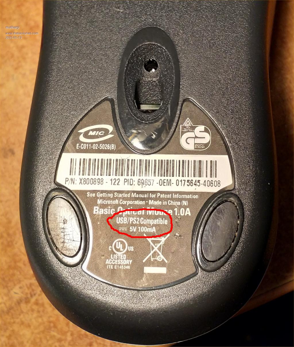

  Quote  For future reference, is there a way to determine if a USB mouse supports the PS/2 protocol, besides the "try it and see" method?

Hmmm, I don't have a single mouse that displays anything like that on its belly.
My new PS/2 mouse arrived today - it doesn't display anything like that either, but it does have PS/2 connector, which is a dead giveaway :)

The Microsoft Basic Optical Mouse V2.0 is a currently available item.
That's here in Australia so I assume that it is current everywhere.
Price is back up to $18AU.
https://www.harveynorman.com.au/microsoft-basic-optical-mouse-2.html
Nowhere in the advertising or packaging do they mention PS/2 but it does have the same USB/PS2 compatible text on the base and comes with an adapter.
I have another older USB Optical mouse that doesn't mention PS/2 anywhere but does work fully.

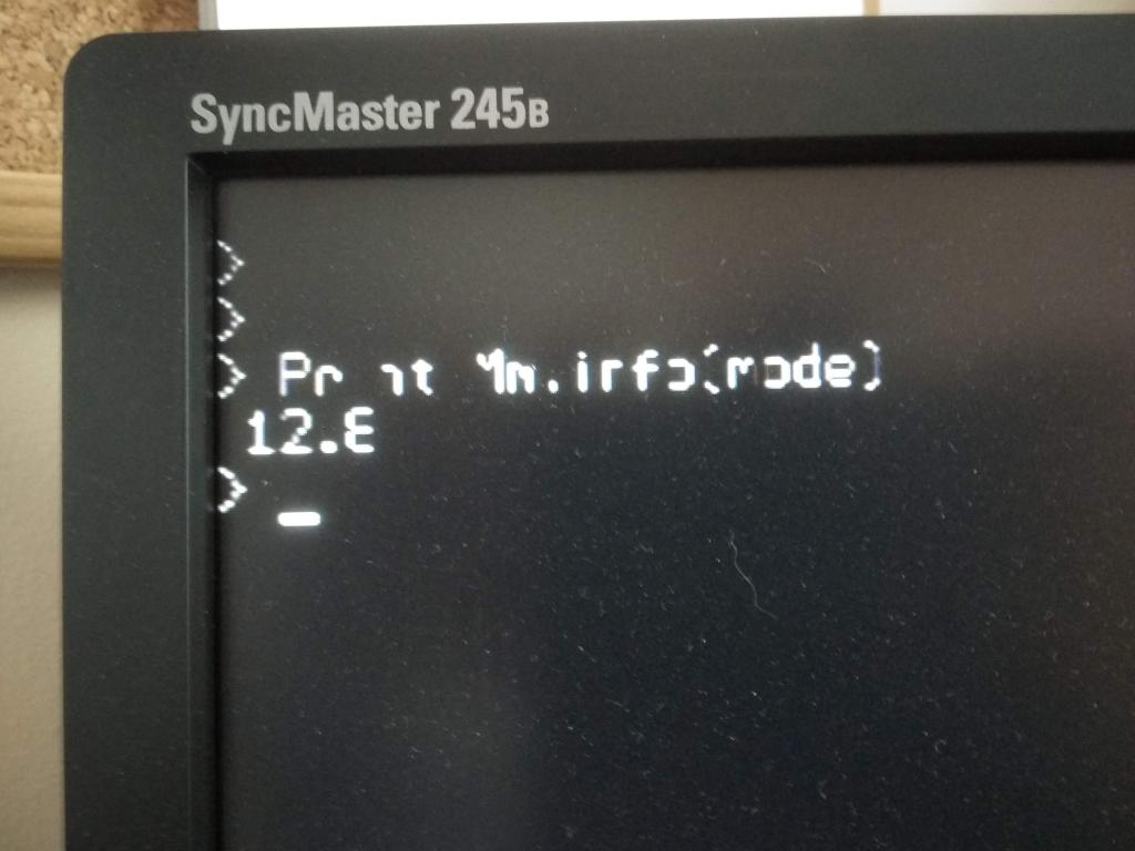

My Samsung SyncMaster 245B does not like MODE 12.
- missing pixel columns (see image)
- no status line
- typing "LS" clears the screen, lists nothing and returns CMM2 to Mode 1.8 ?
Edited 2021-01-17 21:25 by thwill

My LG FLATRON M237WDP doesn't like Mode 12 either, it doesn't give any picture at all. Note that strictly speaking this is not a "Monitor" but a wide-screen TV with VGA input (and lots of others including SCART which makes it useful as a retro-computer display) but it does display all the other CMM2 modes.
Edited 2021-01-17 21:46 by thwill

I can start the programs now, but MODE 12 looks terrible in all modes, the same as on Tom's picture, MODE 11 is better but has color shift (not too much). On my other CMM2 with FW5.06 both of them are very stable, I'm using MODE 12.8 for programming...
Jiri
Posted: 03:41pm 17 Jan 2021
Thanks for the report. Mode 11 hasn't been touched so shouldn't be seeing any changes.
Looks like I'll have to revert on mode 12. This is a pity as it works beautifully on my monitor and fits into the 512K of fast RAM (960*540=518400 < 512*1024=524288). Previously mode 12 was duplicating lines so needed 960*1080 pixels which had to go in SDRAM so was slower.
The new mode 12 uses the 540P timings which was the first "HD" variant for TVs but it looks like only a small subset of monitors understand it.
Mode 11 uses 720P timings and works OK in 8-bit mode but both it and the old mode 12 are really out of spec for the STM32H743 video generator H/W
