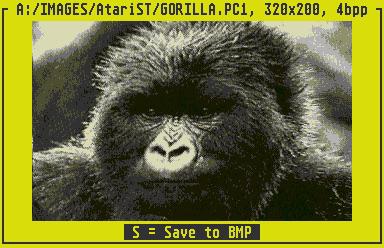

I'm having trouble with the Graphics Viewer. I down-loaded the images you used above (from ffmpeg/atariST.org) and then tried the Viewer on them. Both seemed to load OK but when the progress bar came to the end it threw an Error:
"Error in line 3748: Argument list."
Greg

it looks like older version of GRF.INC. What version you have (it's all either in new NC under F10 or in files on begin as VERSION.NC for NC.BAS, VERSION.GRF for GRF.INC and VERSION.TUI for TUI.INC)?
If the error line is with
GRF.loadST(filePath, 0, 0, 1, 1)
in older GRF.INC was not used the 4th parameter (progress bar ON)...
Newest versions are:
NC 1.13
TUI 0.40
GRF 0.10

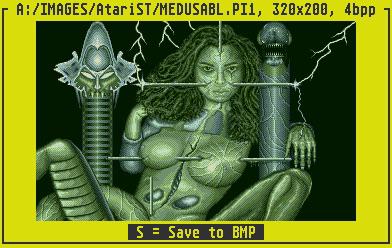

Hi Greg,
I was not able to reproduce the error, can you attach here the file (picture) you used? Anyway I found other bug in palette calculation, so I re-uploaded all the files to the GitHub again, please try to use newest version...
And after fix, the ST pictures should look so:
Jiri
