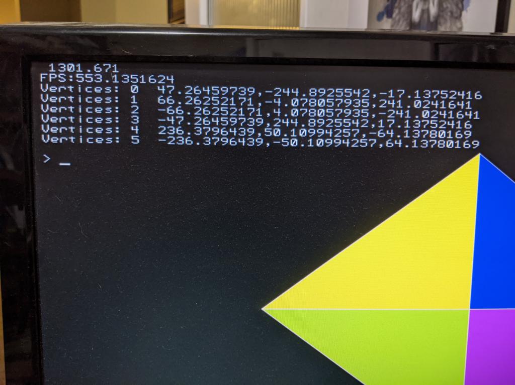

  vegipete said  I gather you are finding too that the end position is not the same as the start position?
Mine ends up matching?
Here are my iteration 650 numbers... but of course I have no idea if they are right or wrong as none of us have matched

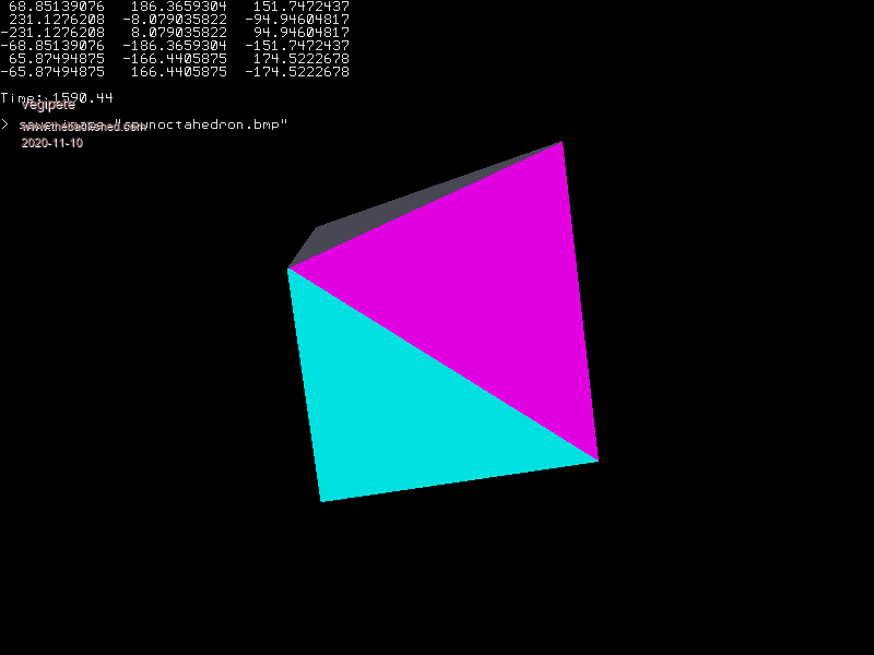

PeteCotton
Joined: 13/08/2020
Posts: 669
Posted: 02:25am 10 Nov 2020
P.S. Ignore the time at the top of the last picture -that's with RC15

There is something strange with your vertex coordinates. I just checked the first one and the vertex is not 250 from the origin. I would expect the square root of the sum of the squares of x, y and z to be 250.

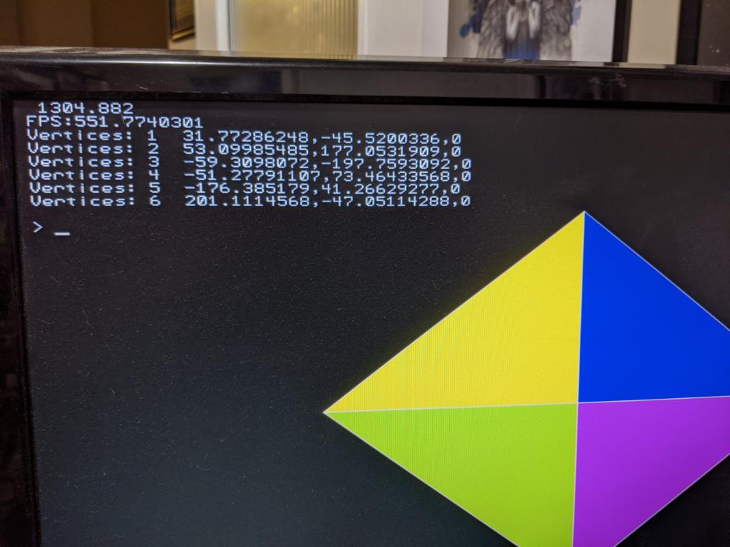

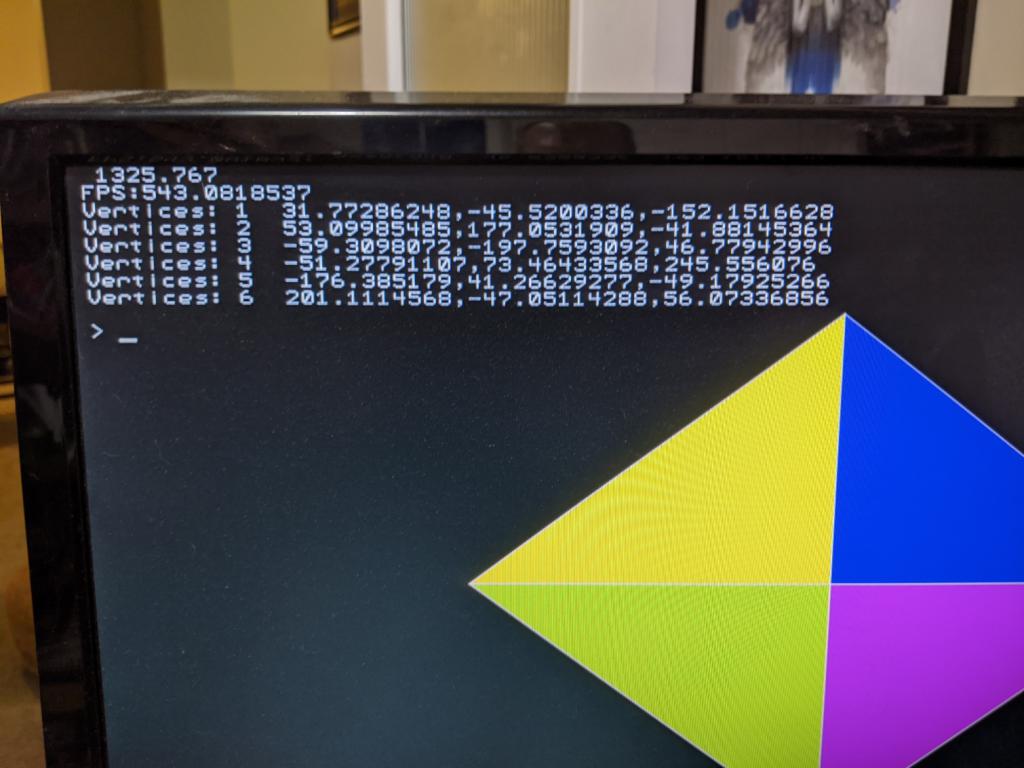

  vegipete said  There is something strange with your vertex coordinates. I just checked the first one and the vertex is not 250 from the origin. I would expect the square root of the sum of the squares of x, y and z to be 250.
By Jove you're right! I worked out that I was displaying the values after they had been adjusted for the viewplane at 800 pixels (therefore the massively distorted perspective values). Here's the pre-perspective values.
  vegipete said  In one of the posts, matherp described which direction the image should rotate for each of the x, y and z rotations. I made sure my orientations matched that.
Thanks, another good catch. I had my Y going the wrong way. Fixed in the below picture.

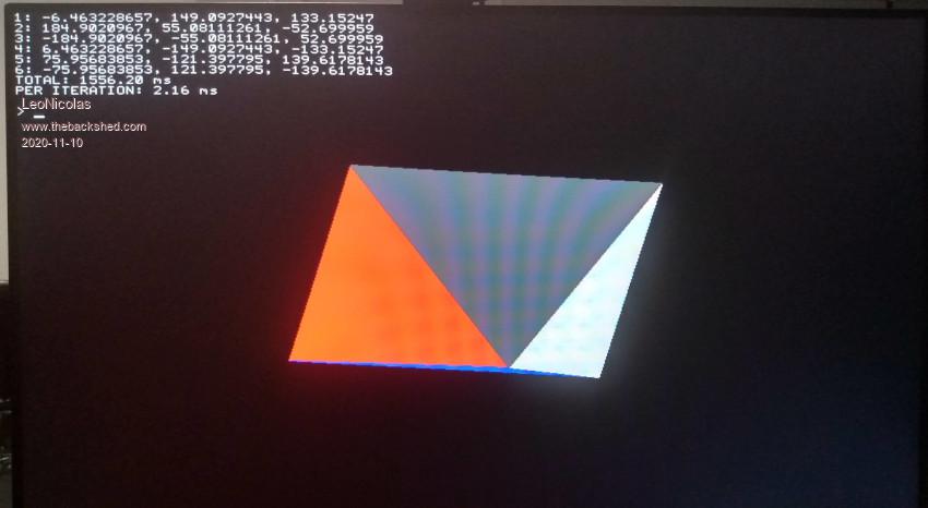

LeoNicolas
Joined: 07/10/2020
Posts: 625
Posted: 06:56am 10 Nov 2020
Finally, I got a time less than 1600ms... and I have some new ideas to optimize the code

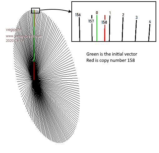

I just ran a check in a CAD program that allows scripting.
I created a vector from 0,0,0 to 0,0,1
I wrote a short script that:
1) duplicates a selected object,
2) rotates the new object 2 degrees around the x-axis,
3) rotates the new object 1 degree around the y-axis,
4) rotates the new object 0.5 degrees around the z-axis.
This shows the same, slightly over 157 iterations for a single orbit. Slightly over means that at 157 iterations, the vector hasn't quite made it back to the starting vector, 158 iterations has moved past the starting vector. (157.39 iterations for 1 orbit, as a first approximation.)

I'm doing exactly the same process and my end octahedron position (after fixing the rotation directions) is the same as yours image.
My concern is the polygon size. Before any rotation my octahedron has 200x200 due the viewplane and z distances.
Another challenge change is now we can use the RC15 as mentioned by Peter in the new firmware thread.

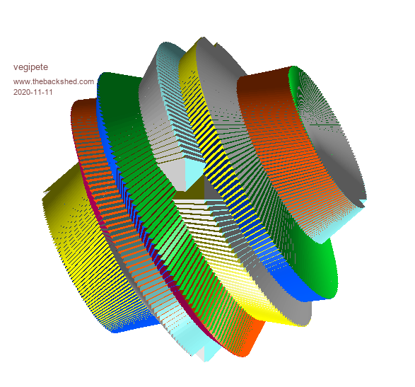

If I superimpose 150 iterations of an octahedron in the CAD program, I get the image below. The rotation direction is opposite of my CMM2 version, but the resulting shape matches, except for perspective issues - the image below is orthogonal.
(Comment out your image clearing BOX command to see the CMM2 equivalent.)
