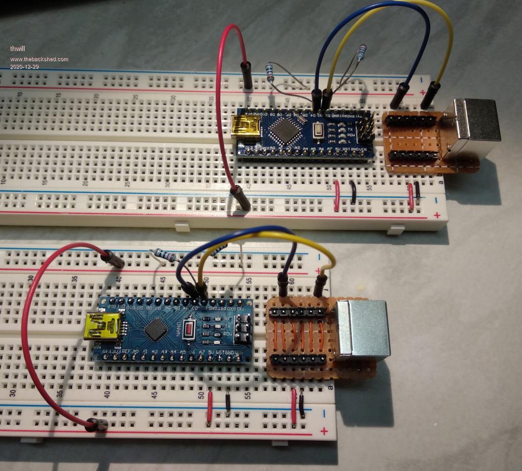

Posts: 4410
Posted: 11:24pm 28 Dec 2020
Hi Jim,
Just a few lines to say I'm still playing with this.
I think I now have the Nano <-> PS/2 working with a nasty old mini/laptop USB mouse that I dug out of a crate and a green Microsoft PS/2 <-> USB adapter, looks like I am getting the expected output on the Serial monitor but haven't had opportunity to connect it to my CMM2 yet.
My new PS/2 mouse still isn't co-operating and the Nano appears to "hang" after printing the initial Mouse OK. I'll get back to you with some more information the next time I find time.
One thing I notice even in the working case is that I sometimes have to Reset the Nano two or three times before things get moving.
Posted: 07:04am 29 Dec 2020
Tom,
What you need is a PS/2 analyzer.
Here's one I prepared earlier.

On the nano, comment out the lines at the start that do the checkMouse()
leave the mouse.initialize(); as the only active line in that area.
if (in_mode == 0) {
   // Serial.println("Start here ");
  //  mouseOK = checkMouse();
  //  Serial.print("mouseOK ");
  //  Serial.println(mouseOK);
  // readStart = millis();
   mouse.initialize();
  // readTime = (millis() - readStart);
   // Serial.println(readTime);
 } else {
   joy_initialize();
connect CMM2 pin 8 to PS/2 clock line (nano pin D 3) via 100k resistor
connect CMM2 pin 10 to PS/2 data line (nano pin D 2) via 100k resistor
connect CMM2 pin 12 to clk_pin (CMM2 pin 8)
Once the program is running on the CMM2, do a reset on the nano to force the initialize routine.
