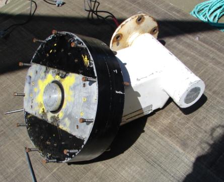

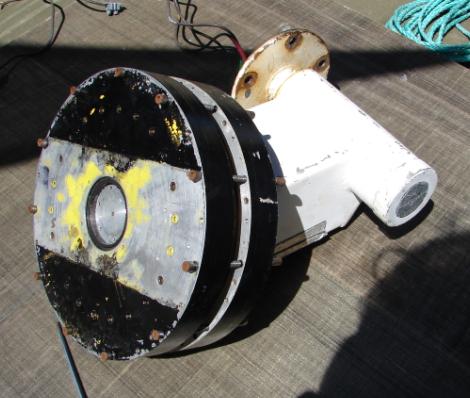

I have finally lowered my AxFx mill. There is a bit of a lull in the wind. This has given me the opportunity to do a photo shoot and repack the bearings and give the housing and blades a makeup session.
The machine has withstood the sea air quite well.
Here are some photos.
Gizmo may be able to strip some of my photos and place with the personal articles. 6476
This photo is of the alternator still attached to the yaw box with the extraction screws in place
this photo is the extraction screws fully inserted, ready for rotor halves to be separated

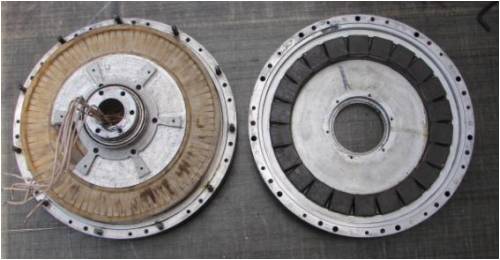

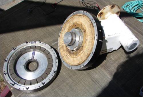

this photo is of the two rotor halves separated
this photo is of both rotor halves laid flat after the stator has been removed from the yaw box

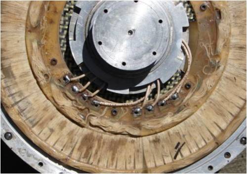

this photo is of a close up of the wiring connection to the stator. The 4phase wiring is soldered to moulded in brass inserts in the stator.

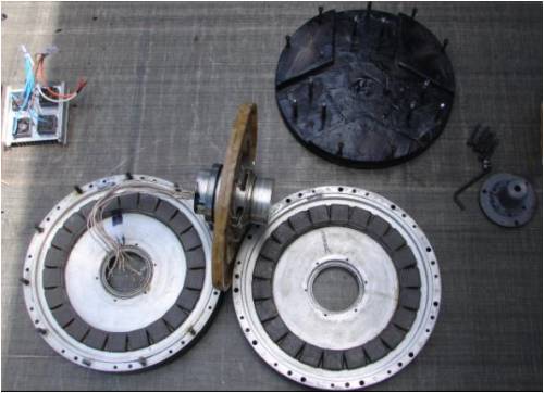

This photo is of all of the alternator components, including the 2 rotor halves, the stator and bearing hub, the 4phase bridge rectifier and the blade attachment adapter.
I made the alternator as a motor in 1994. The alternator is basically a 4phase, dual rotor axial flux unit. The dual rotor fully contains the stator, with the electrical output wiring exiting the alternator through the hollow shaft. The assembled unit forms an environmentally sealed unit, with the only rotating point protected by a labrynth seal being at the rear. This contains a water flinger and 2 step dust seal, to protect the bearings from foreign matter, with minimal friction.
You will notice that there are many bolts in the construction. The rotors consist of many layers of aluminium and iron plate that is internally bolted together. The two iron magnetic return paths are bolted to the inside surface of the outside aluminium plates with 22 countersunk cap screws on each plate. Each of the rotor halves is keyed on the outer rings to provide accurate magnet rotor, stator and bearing alignment. The stator is aligned centrally between the magnet surfaces with 0.5mm tollerances. The twin magnet rotors consist of 22 radially aligned 1"x1"x0.5" N34 Neodymium Iron Boron magnet blocks. The copper coils are arranged in 11 series coils and 4phases. The coils were moulded in resin. The bearing housing is one piece of aluminium stock that was machined, bored and milled. The stator is insulated and thermally bonded to this hub with a specially fitted aluminium adapter. Each phase only has to pass a maximum of 4amps, and each phase has a 1ohm resistance. The stator has to only dissipate 64W at maximum power output. The milled recesses in the stator adapter plate were designed for the solid state commutator, that is not needed as an alternator.
