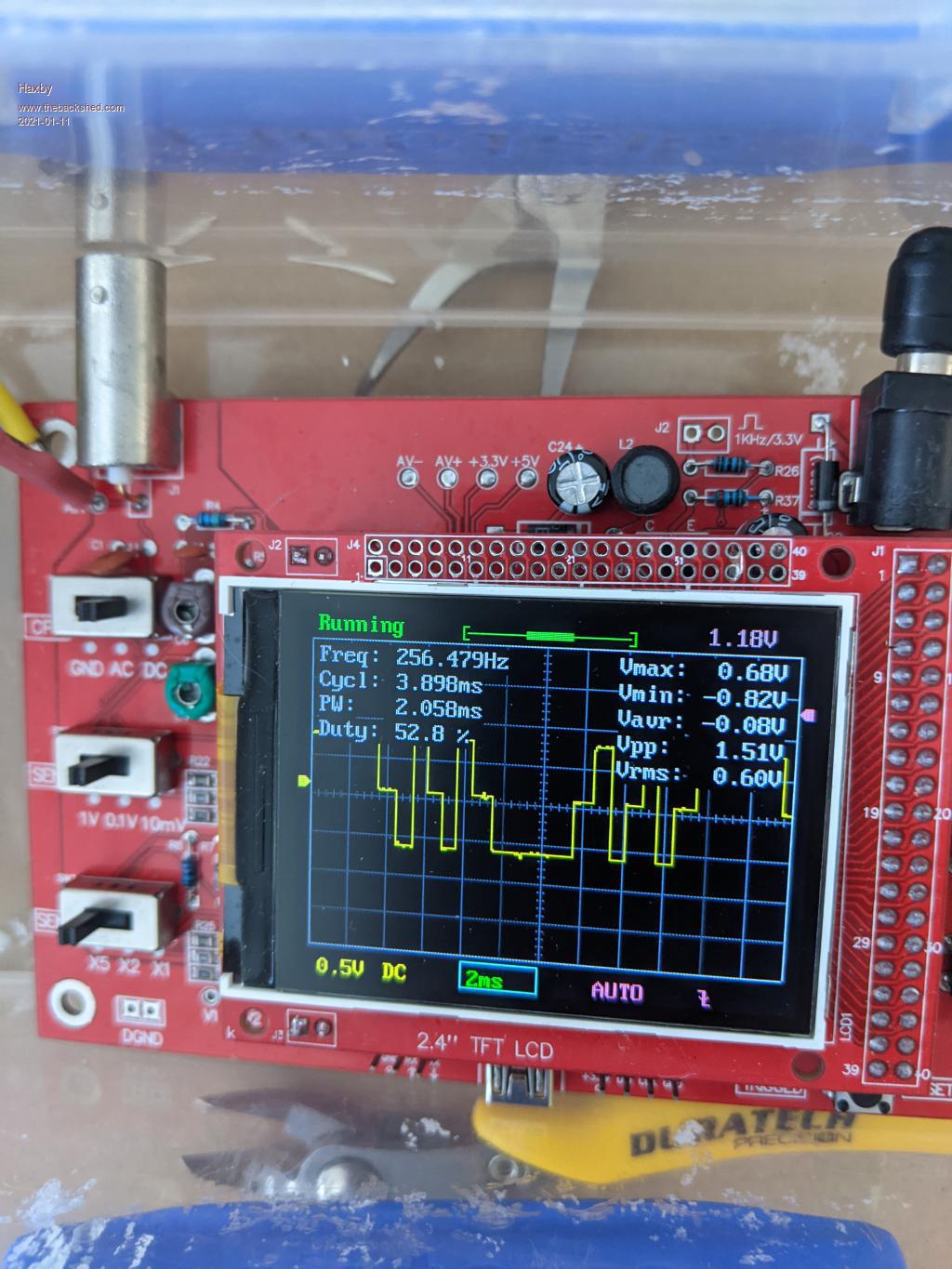

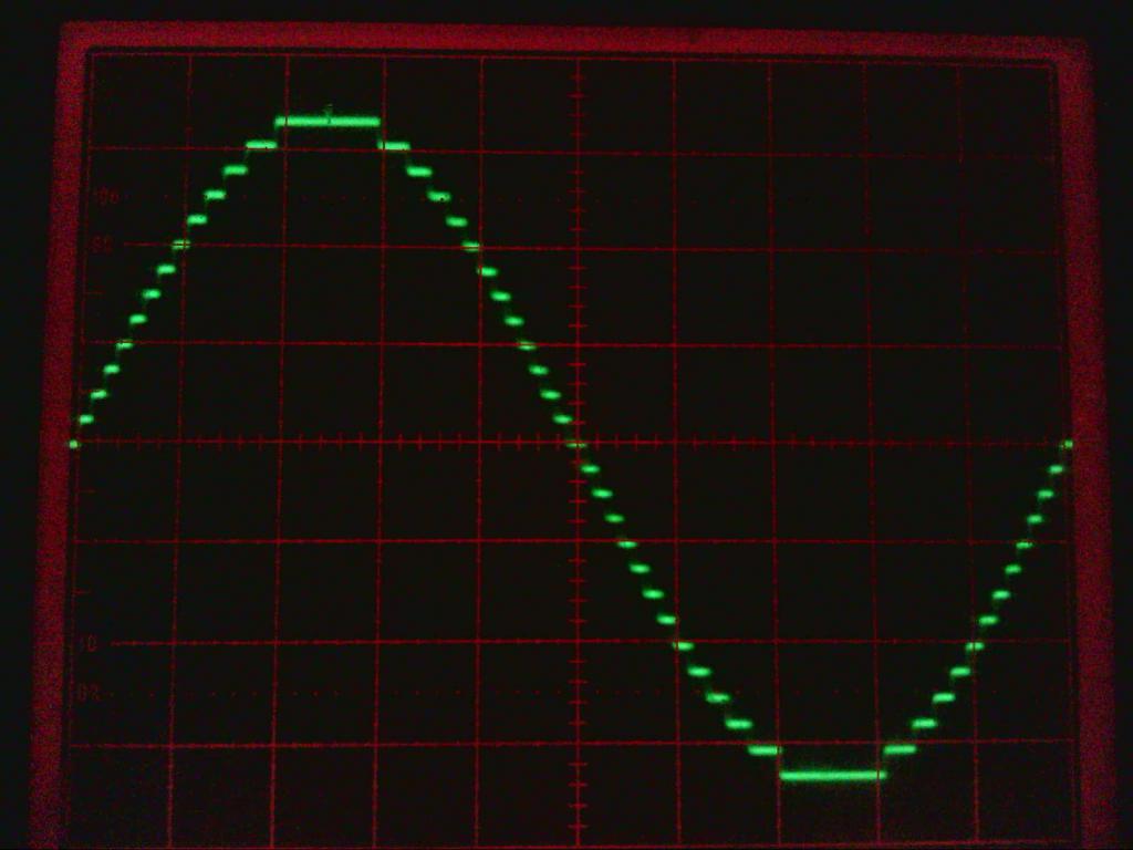

Thanks warpspeed. Does that oscilloscope trace correspond to more-or-less what I should see for the second largest inverter output? Also is 10nf correct for the dead time capacitors?
Posted: 07:29am 11 Jan 2021
Any of the four inverters will look the same when driven with the drive waveform for the largest inverter.
Yes 10nF will be plenty of dead time, that is what I am using.
Its now three years since I looked at any of this, but from memory that was around 2.5uS which is heaps.
1nF was about 300nS dead time, and no capacitor at all about 50nS of dead time.

The image I posted was of the second largest inverter. Does it look right?
Posted: 09:28am 11 Jan 2021
Yes that looks fine to me for inverter number two.

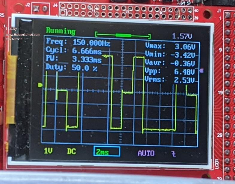

Posted: 09:56am 11 Jan 2021
Ok this next one is on the output of the second largest inverter on its own.(transformer output side)
Does this look ok?

Posts: 427
Posted: 09:59am 11 Jan 2021

Posted: 07:45pm 11 Jan 2021
That last image is with the warpverter set to output the lowest voltage possible, as I applied 4v to the feedback on the ADC.

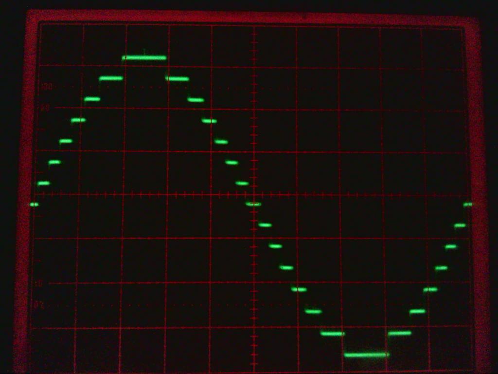

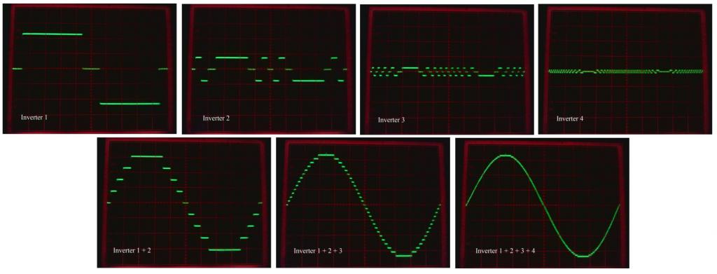

This is my inverter (with the smallest number four inverter disconnected).
At minimum dc input voltage (90v) there are the full 27 steps.
With the dc input voltage doubled to 180v, the inverter ac output amplitude stays the same, but the individual steps become twice as high, but only 15 of them.
I never bothered to record the actual driver waveform shapes doing this, but obviously there are going to be very large differences between the lowest and highest lookup tables.
With the smallest inverter connected up, the inverter output waveforms are far less lumpy, and its more difficult to demonstrate how the voltage regulation actually works.

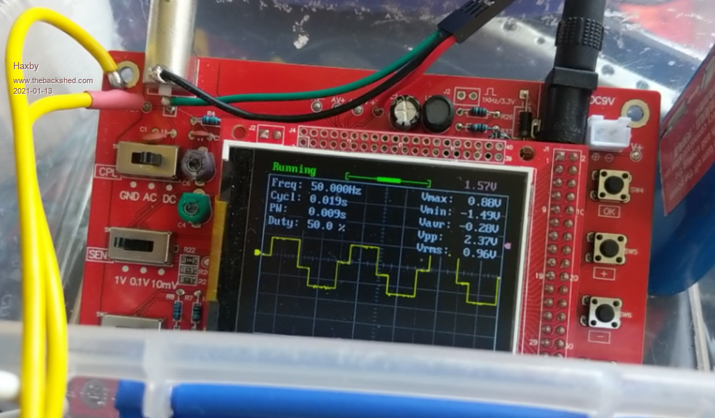

Ok more testing this morning with a fresh brain.... This was the first time I traced the output terminals of the inverter with a transformer connected.
You can see that while the high/low times look symmetrical, the "off" time is not. No idea why this is so....

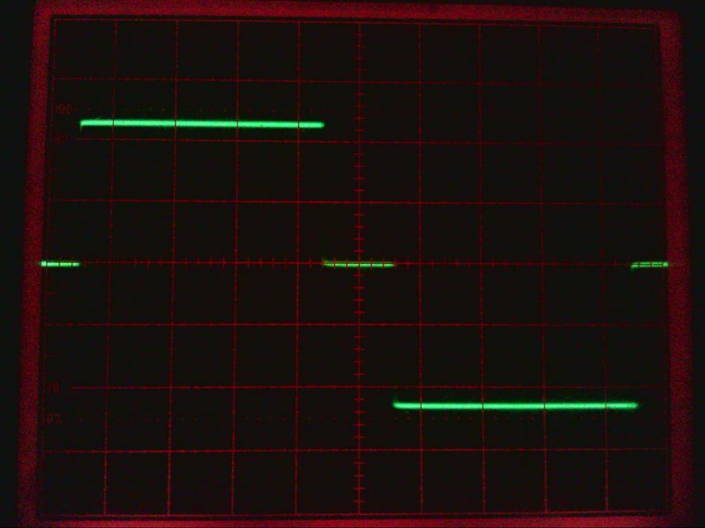

Posted: 11:35pm 12 Jan 2021
That waveform is not right !
Its not returning to exact zero in the middle.
The positive and negative peak values are when a pair of diagonal IGBTs turn on.
The zero point is when either a pair of upper, or a pair of lower IGBTs turn on simultaneously and place a dead short across the transformer primary. It does not matter which pair turn on together (both uppers or both lowers), either will work fine, but that does not seem to be happening.
That is your problem for sure. Now we need to work out why ?
Should look like this:
Edited 2021-01-13 09:39 by Warpspeed
