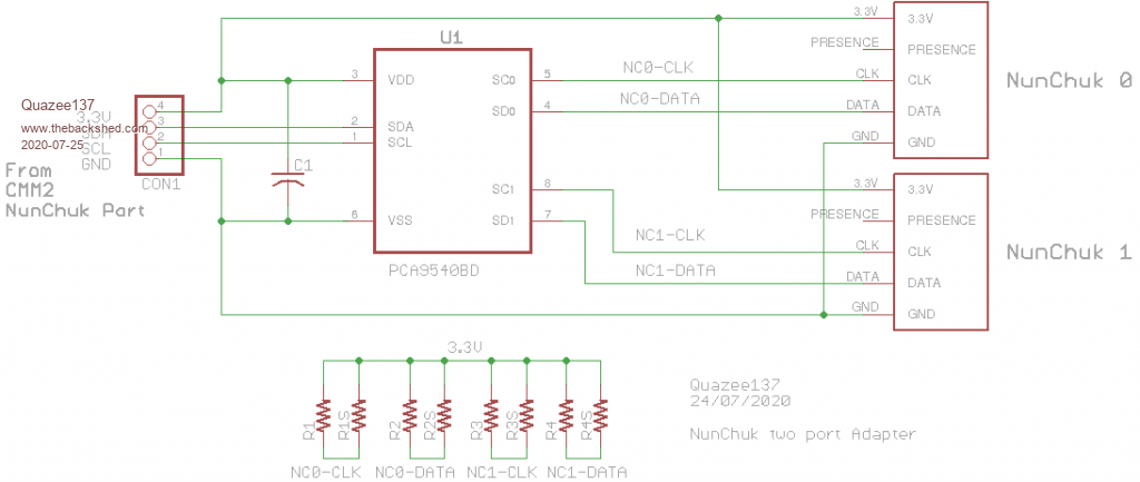

Here is a two port adapter. Both ports will use the same code just need
to tell the PCA9540 which one your talking with.

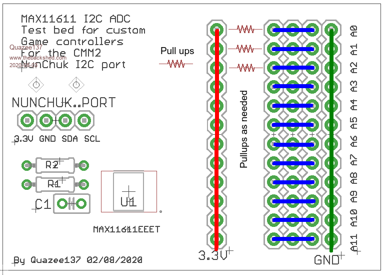

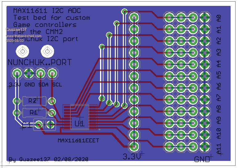

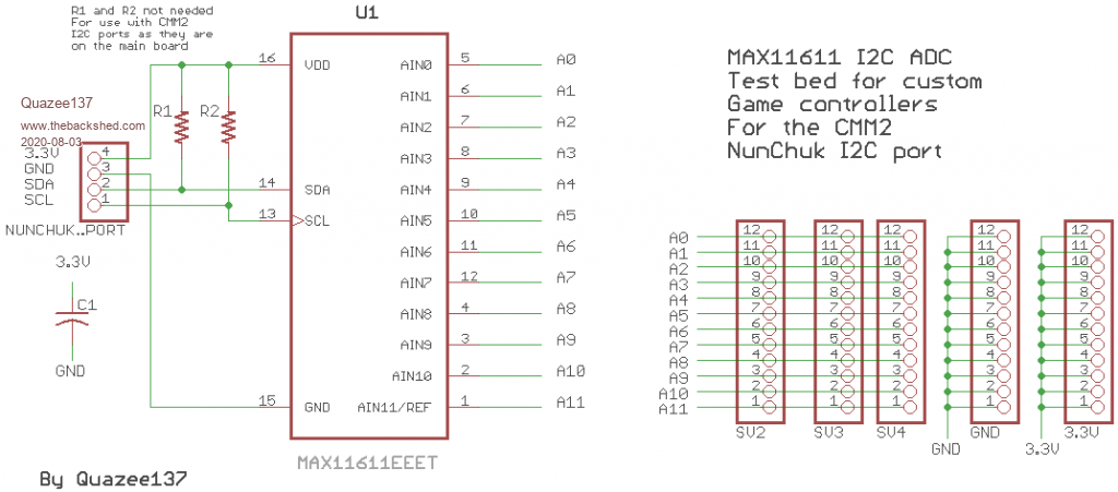

When I get bit more time again will do one using MAX11611 12 channel ADC.
That is 12 inputs that can be three xyz pots and nine buttons. I think the 1st
run at this one I'll just get the chip and pads so it will be a test base for
any who want to play with it.

I still think the front NunChuk port I2C can be used with many chips to make all this
easier to do. I'll have time later to try and get the PCB for the MAX11611 done.
The plan is to keep it simple and have pads or even a header so it can be tested
with many input types.

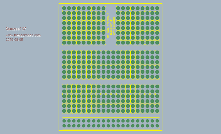

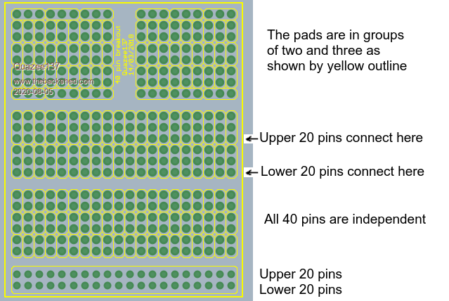

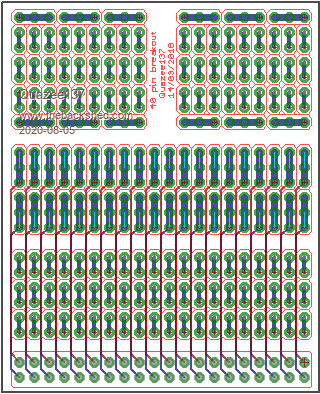

This is from my MM170 HatStand prototypes. Should make it easier for those
 that want to play with the 40 pin port. I had moved in March and just unpacked
 the MM170's and usb with the cad files.
a work sheet
I used theses to interconnect the boards.
40 Pin Breakout.zip
have FUN be SAFE
Quazee137
Edited 2020-08-05 01:43 by Quazee137
