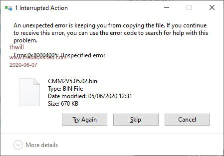

Hmm, Windows 10 doesn't like your latest zip file:
7-zip will extract the .bin, but the result is 666K long instead of the 671K recorded in the archive.

Try again. I just used W10 to replace the file in the archive. So it replaces it and then complains about what it has done: WTF?
Posts: 4410
Posted: 04:41pm 06 Jun 2020
OK, that can be extracted, and after a fight with Windows10 and STM32CubeProggammer ... don't know what it was up to ... I have it installed.
