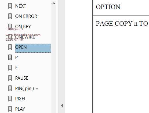

Posted: 03:08am 18 Jul 2020
V5.05.04 manual included with the RC4 beta
Index for OPTION missing
Index for PAGE is P
followed by an index E
