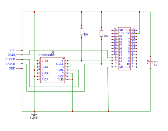

Posts: 4410
Posted: 09:57pm 14 Apr 2020
Hi Bill,
  thwill said
  Turbo64 said  You could use any other logic gate IC you have to hand instead - like a 4011 for instance _ perhaps connect two gates in parallel for each line for more drive capability.
Now you've definitely lost me. I could use them for what? I can just about grasp the idea that if I tie two gates in parallel then I can possibly source twice as much current from them.
A random firing of neurons helped me understand your suggestion (possibly), and I built this:
Note: C1 is 10uF, not 1uF. And if it is significant the logic IC is a CD4069BE without the U.
Just in case I've drawn it wrong, I've gated the CLOCK signal sequentially through a pair of NOT gates in a 4069B.
And wonder of wonder it works!!! The shape of the resulting CLOCK signal is better defined so does that suggest that was the cause of the problem?
Please feel free to critique both the design and schematic, otherwise how will I learn.
I'm still interested in answers to the other questions I raised regarding 4043, 4049 & 4050, and whether I would be better off investing in 74HC to use with the MM.
A thousand thanks,
Edited 2020-04-15 08:32 by thwill

Turbo46

Yes!!!
That is exactly what I was trying to suggest. I would connect a second inverter in parallel with the second one for more drive capability and duplicate that circuit for the latch signal. Just to be sure to be sure. And yes I think the clock signal needed an active pullup to work more reliably.
  Quote  there is probably something that could be done with diodes, but that probably has its own downsides, e.g. a drop in V
Yes you could make diode/resistor OR gate and use a buffer gate after that to get rid of the drop in V. You may get individual clock pulses due to propagation delay between stages but it would be iffy.

I am still confused as to why the simple circuit fails as well. I think the 'black blob' is more fussy about the clock pulse and needs a good sharp clock pulse with and active pullup. All of the clock pulses on Tom's DSO look fine to me (I have to stop myself from writing CRO all the time).
Edit:
Tom, I forgot, I prefer circuit diagrams that show the individual gates rather than the IC as a single block only gates though not complex ICs.  It means you don't have to have the datasheets available to follow it.
Edited 2020-04-15 12:00 by Turbo46

Posted: 03:54pm 15 Apr 2020
  Turbo46 said  Yes!!!
OK. Depending on other requirements I may end up using some IC other than the inverter (i.e. a non-inverting buffer) but I think I get the idea now.
  Quote  Yes but I was thinking of making one out of a quad NOR gate. That would leave a couple of gates for gating the clock. Google "NOR latch". A NAND latch would need the inputs to it inverted I think.
OK, thanks
  Quote  Would I be better off using 74HC with the Maximite ? since its 3.3V highs are good enough for a TTL high logic level.
If you want to run the IC from 3.3V - yes. At 5V I'm not sure the highs are good enough to be 100% reliable. Minimum 3.15V at 4.5V for one I have used - not specified for 5V but it would be pretty close to 3.3V.
Whoops, I think I meant 74HCT but anyway I think I'm getting to grips with this ... until the next time.
  Quote  Well you have that sorted. Sorry my explanation was not all that clear.
The explanation was perfectly clear, I just needed a little more background knowledge or (as it turns out) a leap of intuition to make sense of it.
Onward and upward, see you in a different thread.
Thanks again,
Posts: 4410
Posted: 10:36pm 15 Apr 2020
<Screams and gibbers>
Turns out it isn't working after all. In all the changes back and forth the CLOCK had ended up configured as dout and it looks like its 3.3V was (suprisingly?) enough for the 4069 inverter to register it as a high the result being that the two gates were pulling the CLOCK up to 5V which was enough for the epoxy blob to work.
If I configure the CLOCK as oout then I am back where I started except with cleaner CLOCK (and LATCH) pulses.
Is there room under that bed for me?
For the sake of all our sanity I'm giving up on trying to run with with an open collector as I have other ways of making the controller work. Perhaps if I'm unlucky enough not to forget this whole sorry episode I will try again in a few months time ... when it will of course just work.
Whimpers,
Turbo46

"I don't believe it"   (quoting another old bald bloke)
You still have the two inverters in series and the only difference is whether you use OUT or OOUT? I cannot imagine that there is any noticeable difference in the clock pulse for those two conditions. Did you try two gates in parallel to drive the clock pulse?
I'm beginning to believe that you were sold a pup and the blob is a bit suss. After all the latch signal appears to work as expected.
