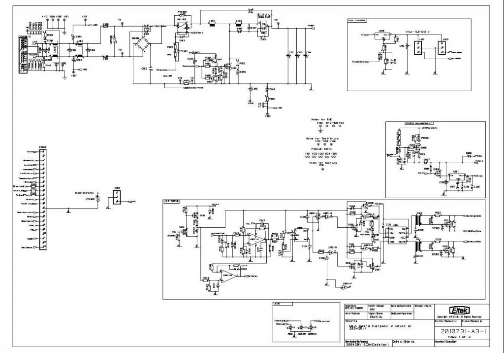

Does anybody have page 2 of the schematic for the flatpack 2 48V HE, I found an
 official eltek schematic for the main board but its only page one   even better would be the standup control board schematic, Wiseguy did send some schematics but they are for the original flatpacks which have a totally different control setup, even though these can be programmed I want to just modify the circuit to output a different voltage all the time at plug in after the soft start, it turns out the control of the flatpack 2 HE is done with a ML56F8037T microcontroller, my plan is to just alter the resistance on the voltage sample back to the micro A-D converter thus tricking into thinking the output voltage is the code set 53.5V, there are 4 resistors on the output voltage and current tracking-going back to the microcontroller on the standup board one of these should alter the sample of the output voltage, so page 2 would be nice
Note these supply's are very high end and the control circuitry is very complex, and the parts scale is almost microscopic as well as the multi layered boards all add to the difficulty of hacking the circuit but I think it is the easiest way to get a different output voltage without all the code, Arduino and CAN interface board
Also the Thai mod is for the original analog control flatpacks, the flatpack 2 HE use microcontrollers for front end monitoring and output control, there are 2 microcontrollers !!

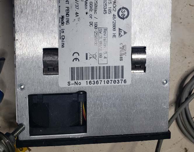

For the program to make the Eltek work at all, it must first
"login" using the serial number. This is found on the label of the flatpack.
mine looks like:
you use the serial number as part of the login process.
unsigned char login[8] = {0x16, 0x36, 0x71, 0x07, 0x03, 0x76, 0x00, 0x00};
CAN.sendMsgBuf(0x05004804, 1, 8, login);    // id = 1 so XX = 04
of course your serial number will be different so you need to edit the program to suit. And change the default volts to what you need.

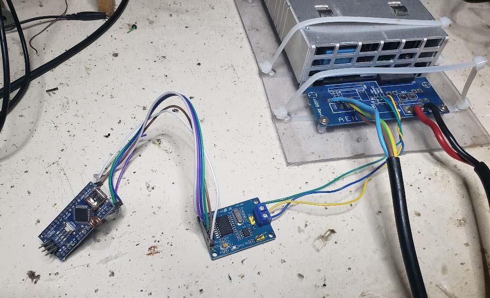

my janky setup I just did 10 minutes ago to verify all this
you MUST connect Eltek's CANBUS signal ground to the MCP2515 ground.
MUST, or you will blow the MCP2515 module.
I think that's what happens, maybe nothing at all. I forget.
I connect the ground to the Eltek CANBUS signal ground

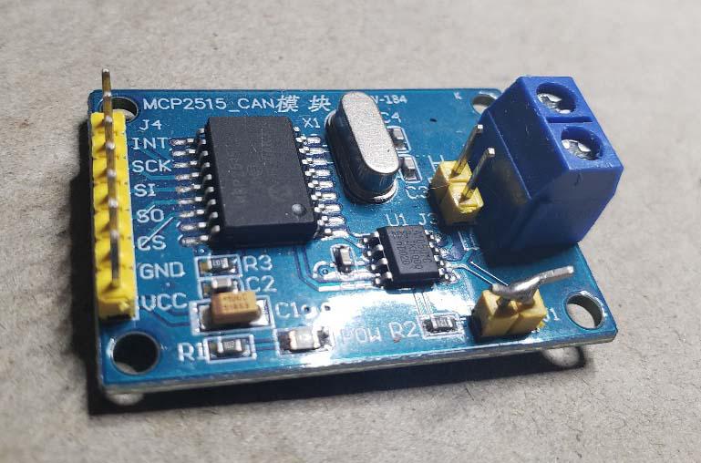

see above for code needed. You link two pins on the MCP2515 board as seen in the photo to get the resistor termination needed. NO link and it will not work.

and a bonus, I found more schematics
FlatPack2_Schem.png.pdf
