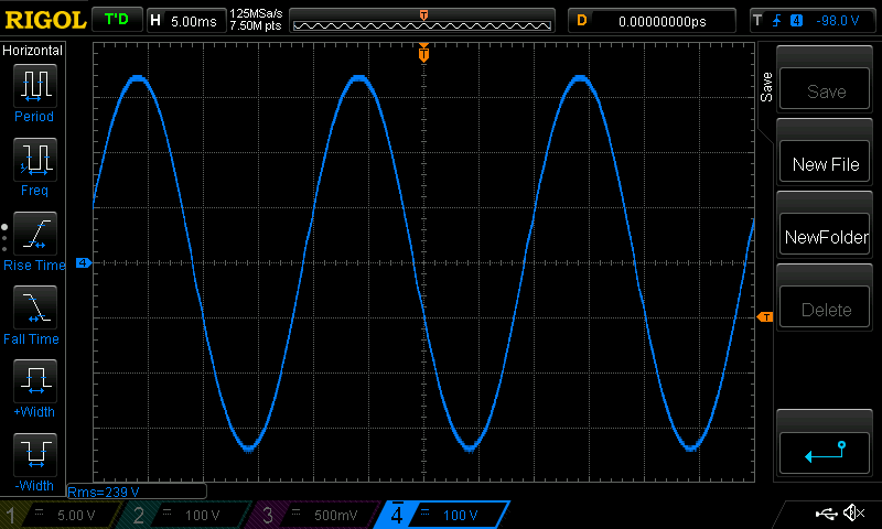

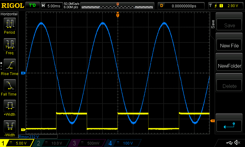

Here is my test inverter, a Mad 6kW totem pole power board with one MOSFET per leg, driven by the nanoverter control board.
Dark Blue is AC voltage
Yellow is the 50 Hz low side drive.
(to get this, go Storage, picture, pic type is PNG, Save, disk D, new file, save..)
Just use a smallish usb thumb drive. Most work fine.

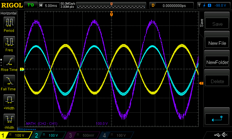

It's not possible to have math function (eg ch1 - ch2) shown without showing
ch1 and ch2. I tried to move one or both channels down or up out of the way
and you loose the math trace.
And, the math function trace looks like crap with heaps of noise.
I had both probes set to 10x, vertical gain is 100V/div
and had both ground clips clipped together but not connected to
anything else.
Yellow is ch1, Light Blue is ch2, Purple is math function (ch2 - ch1)

Thanks Poida, that's pretty much the conclusion I had come to. I found that I could move the source traces out of the way and then press the math function again to bring focus on the diff trace, but it is annoying still, particularly when there is a lot of noise.

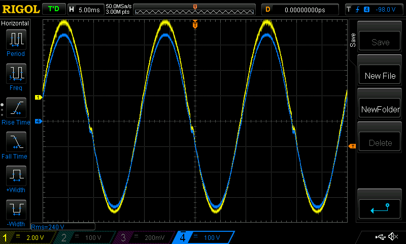

here are the waveforms from first Mad's EG8010 based control board
then the nanoverter.
I did the two tests using the same powerboard, DC supply, toroid etc.
It took about 20 seconds to change over control boards.
EG8010:
the nanoverter:
Idle current was 0.3A at 56V for the nanoverter and
0.34A for the EG8010 which also made some noise in the toroid.

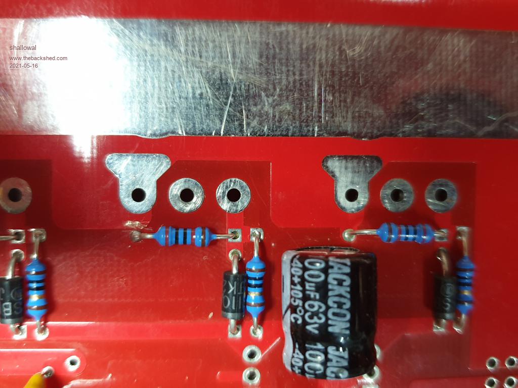

Building up another MAD power board and while checking for any errors I notice that one of the 'H' bridge legs showed a different resistance between the Grid and Source FET legs. 3 of the channels showed 2015 ohms, but the fourth showed 2440 ohms. Turns out there is a fault in the board layout which leaves one of the 20k resistors floating. In the photo I have started scraping off the solder resist to bridge the connection.
Allan
