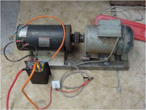

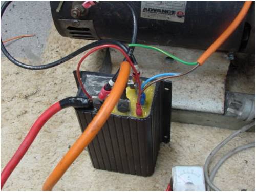

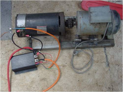

Posted: 10:07am 01 Dec 2008
Dinges, here is the poor mans grid connect kit complete but for batteries:
Note the hot glue holding the front of the power controller. Thats after I fixed it up, couldn't think what else to weather proof it with.
The motor has NO capacitors in it at all. I run the dc motor up to about 1200 rpm, then turn on the ac motor. It pulls up to 1440, then wind the dc one up to however many amps of battery you wish to sacrifice... thats it.
Replace dc motor with motor gearbox and blades, add black box from breezy or brew your own... (so you don't have to sit there and turn it on and off), and your done.... oh and a tower... and brakes..
