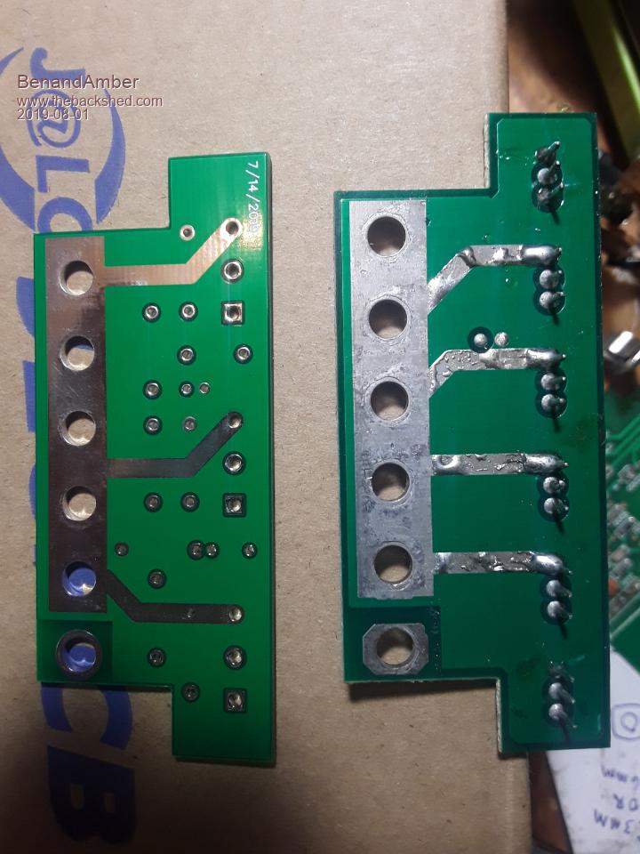

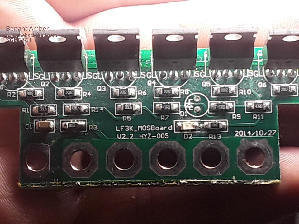

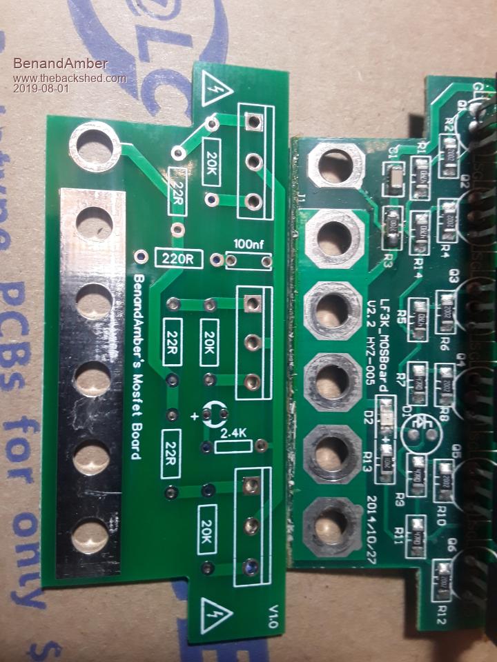

My little mosfet boards came in
Kentfield dude design them for me
Does everything look good as far as the component values to you guys
The mosfets will be Hy 4008
I think Kent done a awesome job
Thank you Kentfielddude

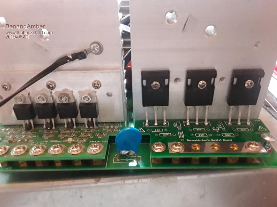

BenandAmber
Joined: 16/02/2019
Posts: 961
Posted: 06:38am 01 Aug 2019

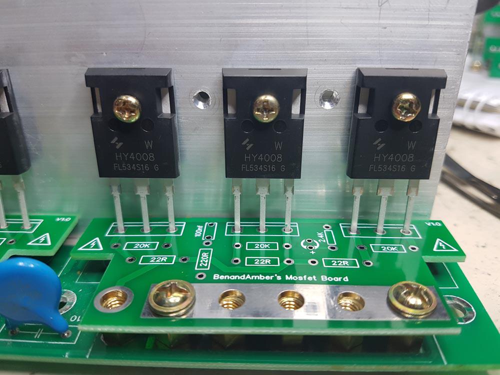

The existing holes in heat sinks can be used or if you want your legs to be shorter you can drill new holes

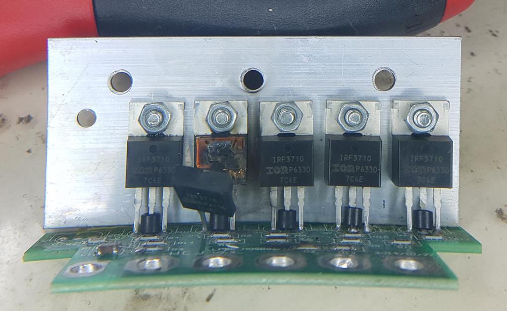

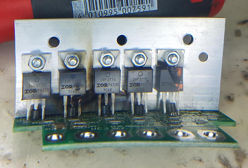

Today I was a bit careless when I tested the Powerjack inverter.
I have added a remote on/off control cable and I had a bit of a whoopsie.
The remote cable plug was able to touch one of the primary winding connectors
while running.
And so, it comes time to replace the 4 MOS boards with those Ben&Amber sent me.
I will show here how it all goes....
But first I need to buy a few metal film resistors tomorrow.
the damage:

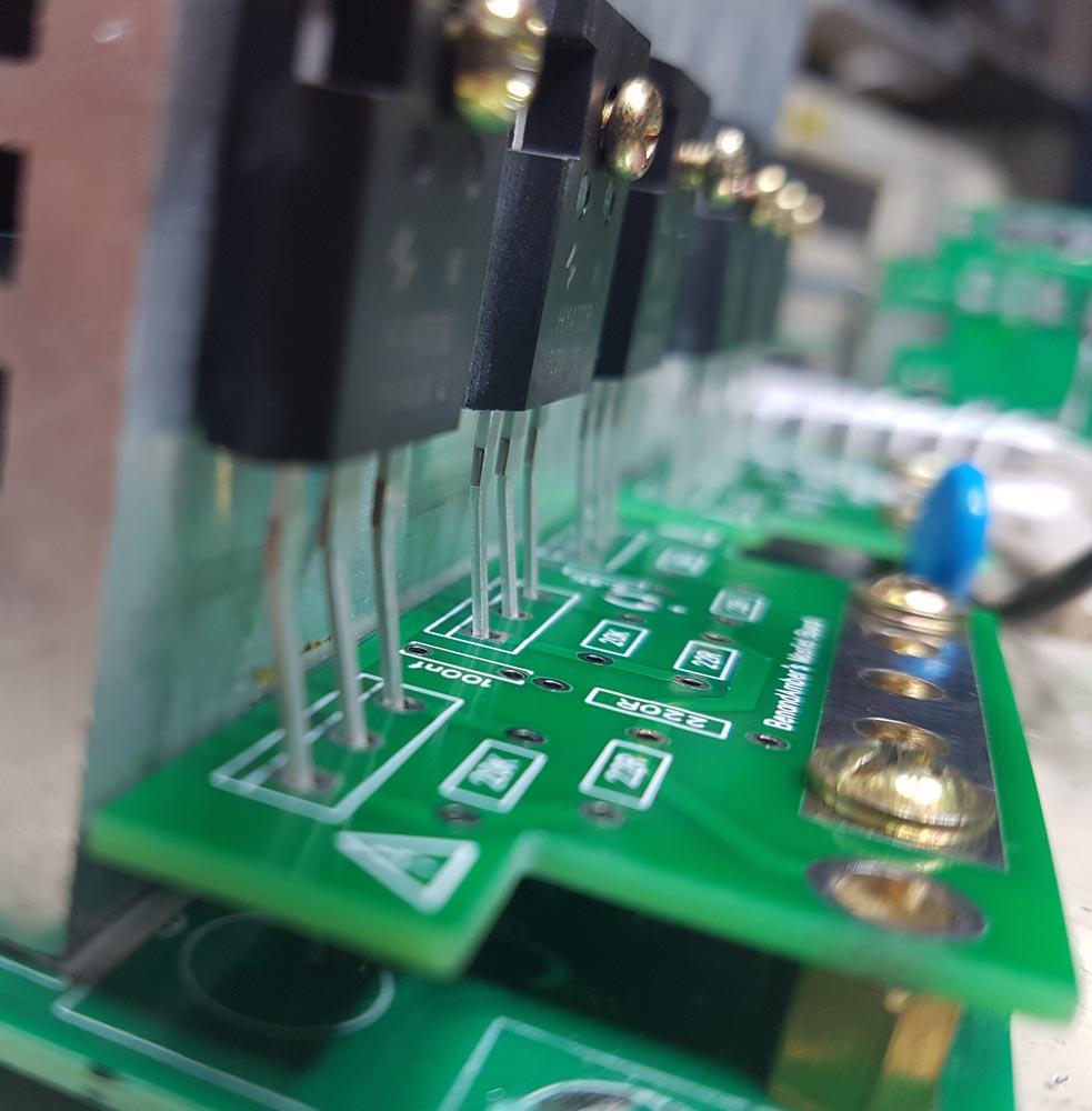

how the HY4008 TO-247 package fits with Kent's PCBs
using the existing tapped M3 holes - perfectly.
and the leads need a little bend:
kentfielddude
Joined: 09/05/2019
Posts: 121
Posted: 04:25pm 08 Sep 2019
How many millimeters do you think the mosfets need to be moved back?
