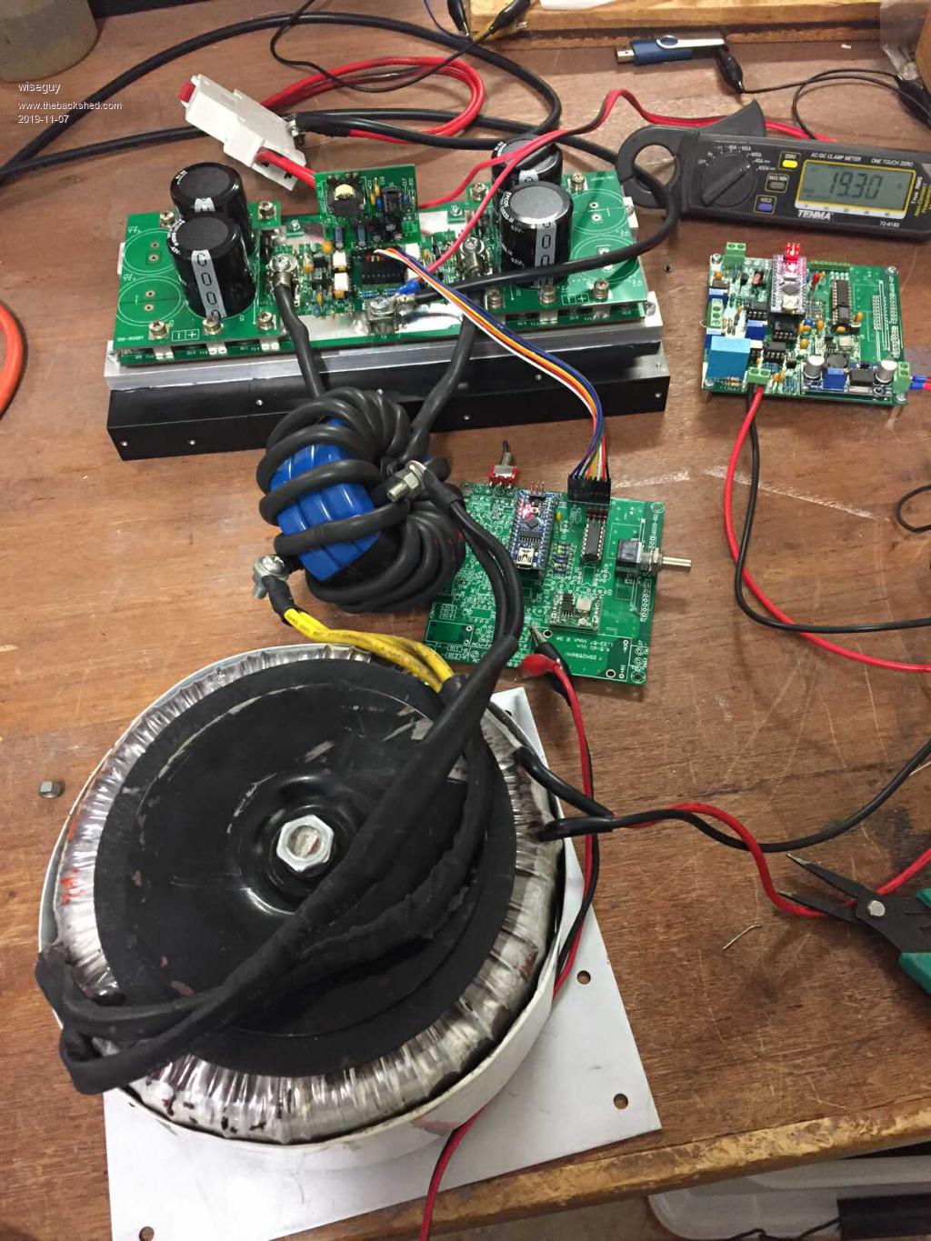

Finally found the time to wire up my version of an inverter and see what happens.
For a power source I used an Eltec Flatpack2 HE 48V 2KW power supply - actually they are an industrial charger for 48V systems, their voltage as delivered is ~ 53.2VDC.
I have 2 of the charger units and I am building up a can bus controller for them as a work in progress.
Eventually I will have 2 in parallel and can then bench test up to 4kW.
I bought 2 Chinese DC circuit breakers one 32A the other 63A, as each Eltec supply is rated at 37.5A and I am just using the one, I used the 32A breaker, later when I add the second supply in parallel I will use the 63A breaker.
The toroid I used was one of my ebay purchases and the choke is 3 of the hiflux toroids with 2 x 8 turn windings.
For first power up I opened the breaker and using clip leads I wired across the breaker a 5A fuse which was promptly dispatched on power up - I thought the Eltec would have a soft start but obviously not soft enough. So then I used a 10A and powered up again, I was greeted with a nice sinewave that rapidly turned to crap just after the inverter soft start signed off and blew the 10A in a few seconds. Here is a picture of the distortion which was rapidly getting worse just prior to the fuse blowing.
I tried extra series choke but it had no positive effect current rapidly increasing with a growl from the toroid.
Here is a picture of the setup.

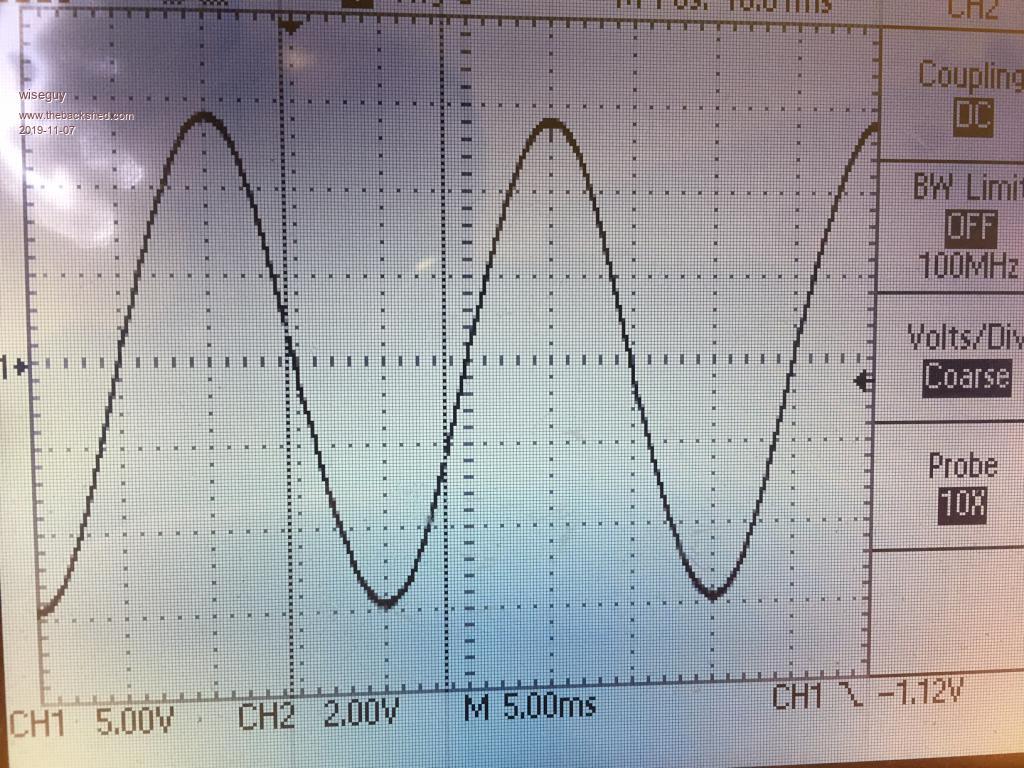

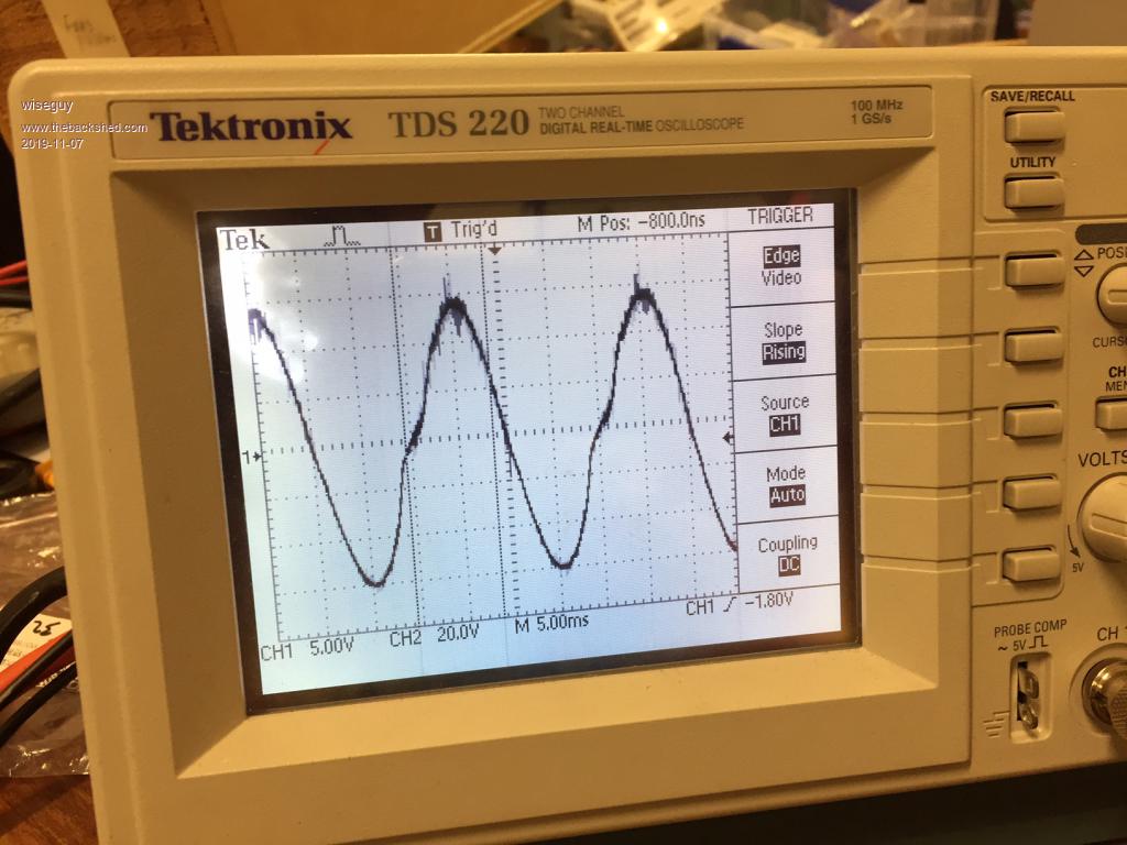

I was confident that the inverter power hardware was not to blame but how to prove it. My hunch was that the voltage regulation feedback employed and the software did not like each other much.  Then I remembered that Poida created a variac code and invited me to have a play with it. The Variac code does not try to regulate the output it simply dials in a variable PWM% value from a variable resistor that controls the amplitude. That is why there are 2 control boards in the picture above  The one with all the bits was told to stand in the corner and the simpler variac controller was built up and duly connected instead.
This is the resulting sinewave at 240V - much better.
Before I lose all this writing Ill post it and then add a bit more - the results are outstanding and exceeded my expectations.

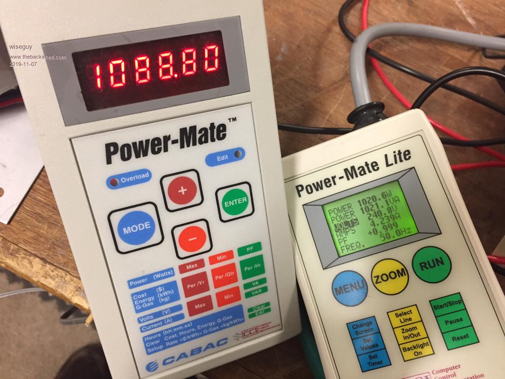

The nearest dummy load I had to hand was a 2kW fan heater with a half heat 1kW setting.
Using 2 Power-Mates to check the 240VAC input energy to the Eltec versus output energy from the inverter gave the following results. Input Power 1088.8W output power 1020.6W
giving an overall efficiency from mains in to mains out of 93.7%. The idling power of the Eltec is 24.8W so removing that loss from the figures yields an inverter efficiency of 95.9%.
After running for an hour the heatsink was still stone cold, unlike the Eltec, Toroid and Fan heater..
This is the proof that the hardware is behaving well so far and that the regulation loop & software function to regulate dont play well together.
This is early days and I will be trying to sort out the voltage regulation/control before putting more power through the inverter. I was finally also able to test the impedance of the inverter (droop) from no load to 1kW, the voltage went from 240V unloaded to 231V at 1kW load - again better than I expected.
Sorry for the big pictures - how do you resize them - I never used to have this issue?
If you are skeptical of the efficiency figures, I don't blame you, I will swap the two meters (input/output) around tomorrow and see if I get a different result - however the cold heatsink tells me it might just be telling the truth.
Edited 2019-11-07 21:50 by wiseguy

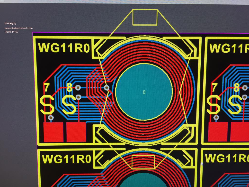

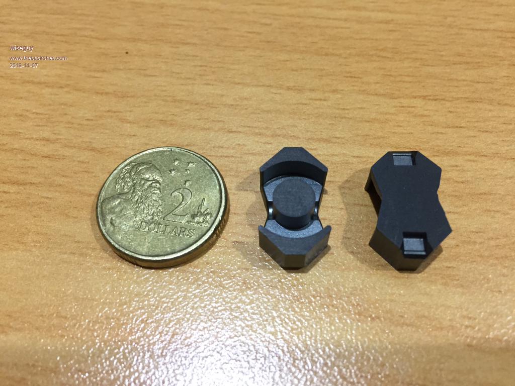

Whilst I am confident to make a simple transformer and add a few parts that enable me to have 3 isolated supplies to supply power to the 2 low side FET drive circuits and the 2 upper isolated FET drive circuits, Klaus and others weren't very excited by the idea.
The truth is I have a few thousand RM6 core sets that are surplus to my requirements.
However winding these little transformers is a pain in the arse. So I decided to employ some planar techniques and see if I could find a simpler way.
Here is a picture of the cores against a $2 coin and the PCB coils I came up with.
The picture above has a core outline superimposed over the pcb winding, to illustrate where they fit together.
There are 2 slightly different pcbs one has 2 x 8 turn windings the other has a 7 turn and an 8 turn winding. The drive circuit is for the 7 turn winding whilst the 3 x 8 turn windings have a slightly higher voltage to compensate for the diode drops. The intention is to use the 3 x 8 turn windings for the isolated Power board FET driver power.
I hope the scheme works ok, I fitted 5 columns x 8 rows in the array of a 100mm sq prototype board. - I get back 200 off 2 x winding pcbs for a $2 outlay for 5 PCBs lol. (+ freight)
I think that adds up to a 1c per transformer of 4 windings. Mind you the labour to design took about 2 days of mucking around.........
Admittedly I have to cut them out - a cinch with my little diamond circular saw and a couple of small notches for each PCB to allow the ferrites to fit nicely, what a bargain !
The intention is to glue the cores together as the clips cost ~ 25c a pair!
There was not much point in pioneering a good workhorse Power PCB if it was difficult for others to reproduce, it also makes it a lot easier for me !
Using either twin row 0.1" connector strips or their R/A version should allow simple connection pins for the PCB coils into the host PCB.
Edited 2019-11-07 22:37 by wiseguy

PCB coil windings, now there is a *really* clever, time saving idea

I loooooovvvvve your design on the pcb and RM6 core.  It's an example of innovation brought about by the democratisation of technology (easy access to cheap PCB   )

This type of asymmetrical waveform is not that uncommon, and has puzzled a lot of people for a very long time, including myself.
The fact that Poida's varic software works perfectly, without that odd bump (on one slope only) pretty much confirms that its most likely caused by staircase magnetic saturation of the toroid.
One half cycle of your pwm must be very slightly different than the other, maybe a small rounding error somewhere, or perhaps a one bit error where quadrants join up.
The toroid is being driven very slightly further in one direction than the other, and the flux in the core very slowly creeps towards saturation in one direction over many many operating cycles.
That can produce some rather high peak currents to gradually build up that may be destructive. Or perhaps the inverter will appear to run run perfectly, but with just the curious lopsided voltage waveform.
Using pulse transformers to generate multiple isolated dc power supplies is certainly a practical idea, if you can source the transformers at reasonable cost.
For a long time I used some commercial SCR gate drive pulse transformers that I already had here in my early Warpverters with success.
The difficulty will be getting reasonably equal voltages, and reasonable voltage regulation between the various outputs.  The final dc output voltages will be all over the place unless you take very great care.  Overshoot and ringing can make a 12v supply go to well over 20v at light load, then drop to 9v with only a few mA of loading. Klaus has had this same problem.
My final solution was to use full wave rectification on all the secondaries, along with a zener diode. I used a 16v zener with supplies that were supposed to be nominally 15v.
After that it all tamed right down and was reasonably well behaved.

Tony after a sleepless night I essentially came to the same conclusion. What I expected to see from saturation though was a "clipping" effect of the waveform peak, not near the zero crossing.
I think I also get the mechanism that rapidly makes it get worse, the RMS of the distorted waveform is obviously less than the nice sinewave so the feedback voltage must have a corresponding droop. The Nano would then turn the wick up a bit causing a rapid saturation runaway to ensue.
I guess that if we consider the slow onset of saturation, that means that the total energy put into the core for a complete 180 degree sinewave must just get to the saturation threshold at the 180 degree end, sure lots of energy is put in at the peak, but the total magnetic energy is the sum of all the energy during the 180 degrees so the final topping up causing the beginning of saturation (the straws that broke the camels back) will start to occur as we get nearer to the 180 degree - zero crossing point ?
I dont understand how the feedback is able to skew the energy unequally between the positive peaks and the negative peaks causing a drift towards saturation. I wonder if the maths to correct the amplitude or similar causes a pwm event to be missed or the timing to get to the end of the array means we dont quite make it to the end causing an accumulation of offset - something is going on that I dont get
Ok, so now I am considering using the variac code and putting an external analogue loop and circuitry that looks at the pot setting and the feedback voltage and makes an analogue adjustment to the Pot setting voltage to maintain constant output. ( in effect a servo motor on the pot lol).
A feed forward from the input voltage should be a cinch to control the output but I would still like a relatively pedestrian return to the target voltage during operation for prolonged changes in load.
Andrew I agree about the mains fluctuations and I consider that 240 - 245 volts output at no load and that under full load reduces to say 230V is still a great result. But surely we can get a reliable scheme to control the output whether it is digital/analogue or a combination of both - I'm not ready to chuck the towel in yet.
Mark - thanks for the tip I'll try it next time I post a pic.
