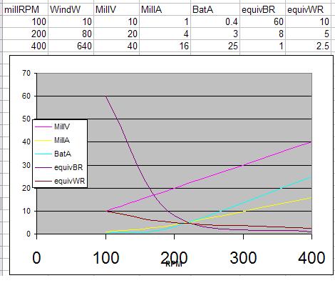

In Oz's heating experiment, voltage goes up as RPM and windspeed go up; the voltage isn't clamped by the battery: as RPM rises, voltage rises; the curve is a rising line. Recall that Oz mentions a relatively large power, larger than when battery charging. Obviously the load, generator and wind are better matched somehow.
In a plain battery charging application however, voltage is clamped by the battery. As RPM goes up, voltage stays the same. The curve is basically a horizontal line.
In a battery charging application with series capacitors, we see the effect that at low RPMs the caps present a relatively large impedance, thus reducing available voltage (and current) for charging. As RPMs rise the impedance decreases. The new (combined) voltage curve of the batteryload and capacitors is again rising, due to the lowering of the capacitors' impedance as RPM rises. At higher RPMs the capacitors basically disappear and the flat, horizontal curve of the battery is dominant.
Keeping Oztules' recent experiments with water heating in mind, the similarity of the curves in both situations (heating and batterycharging with caps) may explain the higher observed powers.
At least, that is my guess. As in Zubbly's experiments, the extra impedance of the capacitors disappears as RPM (and thus AC frequency) increases. It's my suspicion that it is this that causes a better matching of the (battery)load to the windturbine and/or wind. (devious thought: I wonder; does wind have an impedance, as for example space does to RF?)
The above may or may not be the same thing as matching with caps to achieve resonance; one would have to fill in the figures and do some math; it may very well be that both explanations explain the very same observed phenomenon in two different ways.
Or does anyone know how to determine whether it's a matching issue or a case of powerfactor correction (PFC) of the inductive component ? If it's a matching improvement, replacing the caps by resistors (of the correct value at the specific RPM/frequency/windspeed) should have the same effect on power output. If it's a powerfactor correction thing (to correct for inductive impedances), series resistors would not yield the same results as series capacitors. Edited by Dinges 2008-09-26

Dinges, the blades already overpowered the mill, so resistance won't help. Inductive reactance killed it off at 11 or 12 amps... so this is the culprit.
I have a lot of time for Gills explanation, and it fits the facts pretty darn well. It is the only decent reason I can see for getting the amps up. I entertained some wild ideas about how the caps could increase the current some other way, but they didn't hold up.
In the end it was the effective lowering of the resistance (by lowering the ac impedance ) of the coils that was the key.... then the dc wire resistance ceased to be the limiting factor.
I think the other thing with the MPPT argument, is that you can never recover the cubic function of the wind with any gadgetry..... because the alternator only goes up with the square of the blade speed. The blades only go up linearly with the air speed, but the wind is doing it's own thing as a cube of the wind speed.... so I think squared is as good as it gets.
If you can hold the R losses by resonance at the point where your max power is, I think it will be as good as it gets.
If you look at Gills graph, it is a X sq looking curve with frequency.... which is exactly what we want to match the alternators X sq output.
If the caps are chosen well, I suspect no amount of gagetry will beat this arrangement for MPPT..... the alternator is just not capable of X cube performance. (W=Esq/R)......
Now this extra magnitude that we can't track with the alternator, may show up partially.
If we assume that the blades will speed up a little as they are not being loaded correctly as the practical wind rises, we may get a bit more voltage than we would have... ie the rpm increases over linear as we increase wind speed, but by how much, and do we use that advantage already... I'm sure we do as the alternator will take up the extra rpm .....until the blades finally win the tussle and finally overpowers the alternator.
This may skew the calculated cap value for wind speed..... but not rpm.

Certainly, I'll concede there may well be influences that cause a variance to the resonance equation in theory and practical terms, though it is the basis of my rational. Observation and experimentation will reveal this if our knowledge of theory cannot.

I have checked the AC voltage across the capacitors with the mill operating. voltage measured across the capacitor appears to be sort of proportional to mill rpm. I have no way of correlating this yet.
I may have to build a variable speed test bench myself. Trying to measure and record the many parameters on a mill in the wind is becoming difficult now. Too many of the measurements require electrical isolation.
I will need to score a 2hp AC motor and drive a F&P directly. I have a VFD on loan, so I can possibly set up a suitable test rig myself.
The capacitors seem to behave in a similar way to a series resistor. The benefit is the power is transferred to the load instead of being dissipated in the resistor. the power gained is similar to what would be dissipated in the windings and a resistor.
On a previous occasion I measured 550W with caps, this was an increase from a maximum of about 280W without caps.
Today I measured 25VAC across the caps for about 10A battery current. An equivalent series resistor of 2.5ohm for the 3phases would give similar voltage drops at the measured currents. This would equate to a power dissipated of around 250W. The caps do not behave this way though.

I have just gone through some of the relationships that an ideal windmill has to have.
I have taken 3 points only in the wind energy spectrum
An initial say 10W at the shaft, 80W, and 640W. This corresponds to a doubling and doubling of an initial windspeed giving a starting wind energy of 30W for the particular rotor. Ideally the TSR should be constant with increasing windspeed.
assume the 10W gives 100rpm and we have a nom 24V battery. [A battery presents a very low impedance]
this is a sort of table for the power relationships at the various wind energies.
I have tabled approx wind energy to mill rpm and mill voltage and calculated current and then battery current.
WindW = wind power at shaft
millrpm
millV = loaded mill voltage
millA = loaded mill amps
BatA = battery amperage
equivBR = equivalent resistance at battery voltage to dissipate power
equivWR = equivalent resistance at windmill voltage to dissipate power.
The battery and windmill are not anywhere near the impedance that is required.
A series capacitor creates this type of matching, as at low frequency/rpm it is a high resistance and as the frequency increases the impedance drops.
I do suspect that the series caps cannot boost the voltage, so a separate boost method is required, but above the battery voltage the caps perform the required function.
I need to follow up with some more testing of currents.
Gordon.

Posted: 08:58am 26 Sep 2008
I fixed the table above and provided a graph of what needs to be done by any impedance matching system.
My maximiser performs this task electronically. The series caps seem to do a good job without the complexity.
