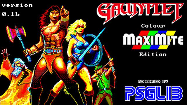

Cover your ears! This time I tried to speak with my (bad) english...
Here is the new Youtube Video about this Gauntlet port.

That really is an amazing demo.
Truly.
Perhaps you should invest your time more in one of the much more powerful units that now exist, such as one of matherp's creations.  They run much faster, have better graphics and sound etc.  I wonder what you could create if you started writing games on those platforms.
But for a CMM unit, this is really, really impressive coding and that you got all that going just using BASIC and no Cfunctions etc(cos they are not supported on the CMM) makes it even more amazing.
Well done.  Top marks.  A+.  Ten out of ten.
