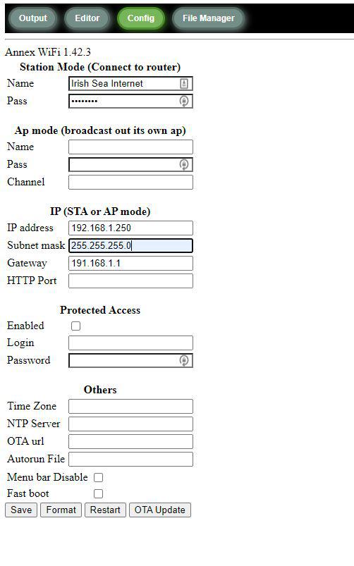

Posted: 05:02pm 07 Dec 2020
Has anyone figured out how to get Annex WiFi RDS to connect to a router?
I've spent 4 hours truing to get it to do it and it will only set it's own network up
It ignores what I put in the boxes
Posted: 05:15pm 07 Dec 2020
I've done this more than a dozen times. I don't see anything evidently wrong. What happens when you click save, and then after a moment, in a browser, connect to 192.168.1.250?
If nothing, power cycle and try again. If still nothing, do you still see 192.168.4.1 among your wifi IPs/APs?
Does an IP scanner like AdvancedIPScanner show you anything unusual.
Which ESP module?
lew247
Joined: 23/12/2015
Posts: 1709
Posted: 06:48pm 07 Dec 2020
Esp8266-01
When I reboot both the pc and the ESP I still have the 192.168.4.1
I've just gone through the whole process again and I used an IP scanner and it's actually on 192.168.1.65 I can connect to it now but it's still showing on the config page as 192.168.1.250
Posted: 07:12pm 07 Dec 2020
  lew247 said  I used an IP scanner and it's actually on 192.168.1.65 I can connect to it now but it's still showing on the config page as 192.168.1.250
I have no idea how that could be explained. I'm looking at one on 192.168.2.75, and that's what the config page shows.
So if you're on 192.168.1.65/config in the browser, "IP Address" shows 192.168.1.250?
